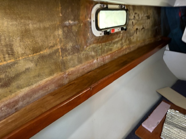

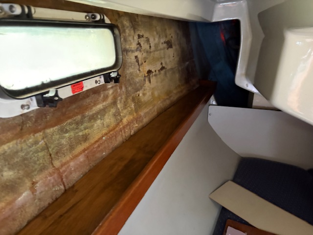

5) I just pulled some carpet out of my rear berth that was nasty. Pulling it out was not too bad, but it was well glued to the wall. It was hard to get the carpet out from under the portlight in my berth and out from behind the locker and other furniture. Once the carpet is out, you probably need to sand down all of the glue and carpet remnants. Wear a mask! My fiberglass is very rough and I can’t just paint it. I had to rebuild the shelf that was back there too. I am still looking for something to put back on the wall….vinyl headliner or something. I think that the trimming and getting behind various obstructions will be a pain :banghead:

10 years later and O'Day still used the same exact glue (mine was a 78)
