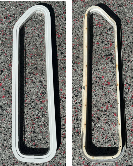

I am in the process of making the CAD files to 3-D print them all. I should have my first one ready in less than a week.
I'll be interested to see the drawings. Based on my own project, I'm learning FreeCAD at the moment. Can think of several other boat project applications as well. Good luck!
Jan 16, 2021
16
O'Day 27 27 Coronado
I have made them all. The forward portlights are identical on both sides of the boat. The middle and aft ones are mirror images on the opposite side.
I split them all in the center for 2 reasons. First, so they would fit in the 3D printer, and second, so that one could insert new plexiglass in the slot before they are installed.
I have printed the forward one, and it fits perfectly. I am printing one of the aft ones now.
I viewed the STL files with a viewer, did a screen capture, and put the images in the PDF I am uploading.
