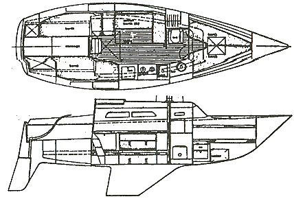

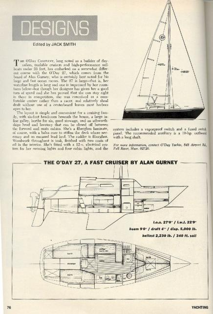

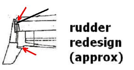

Around 1974-75 O'DAY updated the 27 with a different interior layout. The galley had originally been along the starboard side but was moved to the aft part of the cabin, tucked in the aft corner of the cabin on hte starboard side and running across the cabin to the port-side of the cockpit, kind of like the galley on the 25 and 26. Unfortunately, I only have a cabin drawing of the original layout. Around this time the mainsheet was relocated from a mid-boom traveller on top of the cabin (some had the traveller at the forward end of the cockpit) to the aft end of the cockpit. The rudder was reworked to reduce the depth of the skeg ahead of it and add the area taken off the skeg to the rudder to create a more balanced rudder. The tiller location changed slightly as well I think.
The later models, (1977-78, maybe 1976?) did have an optional deeper keel, draft increased from 4' to 5' by adding a lead "shoe" to the bottom of the keel (100# added) I don't see any sailplan changes noted in my info.

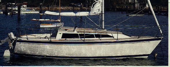

27 MK II must be a 272
That listing for a 27 MKII is actually for the later 272 (1986-89). This was a very different boat, more of an overgrown 26 with a wing-keel.
You may have ended up with a 272 mainsail? However, a 1976 (or 1977, if built in late 1976) O'DAY 27 would definitely be a 27 not a 272.
