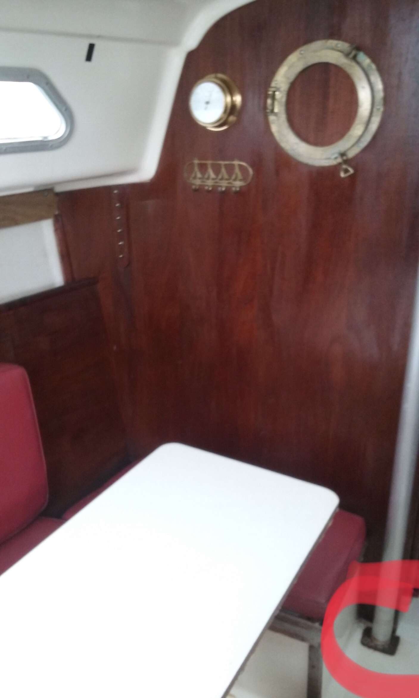

I’m sure this picture I’m attaching won’t shed anymore light but where I circled is where the water comes from
That aluminum tube is a compression post underneath your mast. If you don't see any wiring outside your mast anywhere around the mast either inside or outside the boat, I would speculate that the wiring passes thru your coach roof into the compression post. Water that collects on the inside of your mast during rain storms can be draining into the compression post. As it appears that the post terminates on your floor, this is where you find the water. I wonder if you have wiring passing through the floor into the bilge cavity underneath.
Since it is apparent that you have water penetrating through your coach roof, it may be worthwhile to disassemble your compression post sometime when you take the mast down (or temporarily support the coach roof with the mast up) and see if there is any deterioration in the area where water penetrates the roof.

Just ran across this thread as I don't visit very often. First you have a deck stepped mast. The wiring passes through the coach roof and mast step and attaches by a plug that is inside the mast. The wires pass between the cabin liner and the coach roof back to the electrical panel. Do not under any circumstance remove the compression post with the mast stepped. You have bigger problems than the puddle on the cabin sole (floor). In your photo there is a pronounced stain on your port bulkhead below the upper shroud chainplate and its' teak backer plate. The Starboard side probably has the same issue. Below the sole there is a wood block that is fiberglassed in place and supports the compression post. I have detailed that issue in And so it begins. The leak you are seeing is coming from one of several places. One: the portlights are leaking. Two: the chainplates are leaking. Three: the hull deck joint is leaking. This will run down the bulkheads and onto the sole. Discolored wood is your friend as you can follow the discoloration to the point of origin. The strip of teak at the bottom of the bulkhead is also discolored indicating rot in that area. Use your thumbnail to probe the bulkheads looking for areas of rot. Don't be surprised to find they have degraded substantially. The plus side is this is an easy boat to work on and for a fair amount of money you can have a remarkably enjoyable vessel. Let's start here.
With all due respect to your expertise with this boat, don't you think it is a little alarmist to suggest the color of the wood suggests serious problems? I zoomed in on the photo, and I can't say that I see anything that suggests the discoloration that you seem to see. True, the chainplates are a common source of water infiltration. So is the hull to deck joint. But I wouldn't expect the water to accumulate around the compression post. I've had leaky portlights ... the water never collected on the floor in the area where that compression post terminates (it did make cushions on the settees wet). Isn't it more likely that the source of water at the base of the compression post is the wire passage underneath the mast?
Whatsit, are those bulheads varnished or oiled? Can you tell? I varnished my teak plywood and just a small bit of water at the chainplates caused a tremendous stain that is FAR more pronounced than any discoloration I see in your photo (perhaps varnishing was the wrong thing to do :(). The wood can be slightly stained without causing any degradation of its structural properties. Of course, you should inspect it if you have any question.

I don't think he was being alarmist. If I was a novice and had that stain on the bulkhead below the chainplate I would appreciate someone having pointed out that it was a possible serious issue and to check it out.

Not being alarmist Scott. Unfortunately the wood block under the sole was very poorly designed and sealed. It wicks water like a sponge from the bilge. The tell tale is compression of the sole around the compression post base which allows the water to pool there. Quite honestly I would be surprised if any 27 of that era didn't have the issue it is such an awful setup. Funny thing is I left one of the portlights open in my head when I left the boat. Down came the rain and guess where the water went? Ran to the bulkhead and down to the sole right in the same area. The discoloration indicates standing water at the bottom of the bulkhead and the trail down the chainplate indicates a steady leak. Sadly most O'days have shot bulkheads. It really isn't a catastrophe but should be addressed. The block I refer to is located just forward of the hatch in the sole. It extends forward under the head. A little probing with an awl or icepick will reveal whether this is indeed the case.
