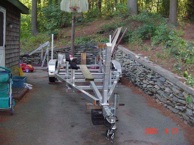

Hello all, I am posting a solution for my O'Day 26 purchased this Spring. This is in hopes someone can use this information. Purchased without a trailer, something I said i would not do! So I needed a trailer fast, and arrived at the solution here. (pics are under my profile album)

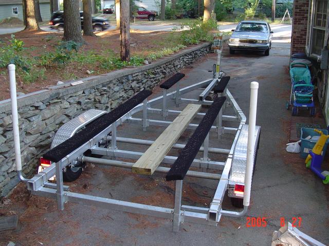

Bought a motor boat trailer, as big of one I could find, used of course. This thing had 96 rollers on it! Several layers of rocker arms. The trailer is dual axle 26' long.No brakes though :cry: Prices from the major dealers were quite high, up to 6k!
I bought four new tires, rubber was shot, dry rotted etc, and removed all the rollers and rocker bars. I left only two cross members on the trailer. That's all it had for cross members, so I might purchase a third and or fourth.

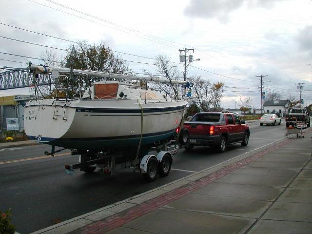

When I bought the O'Day, it came with a wooden cradle. the cradle was pretty solid, 6x6 construction. My aim was to use the material that came with the trailer, but I was in a pinch for time. So, I dropped the cradle on the trailer, simple. I bolted the cradle to the trailer with some of the hardware that was from the rocker arms, I did replace one of the 6x6 support beams, one was rotting.
As you can see by the pics, it came out well enough. I ended up cutting the back support, a slice from it, so I don't have to go too far into the water. This way I don't have to float up and over the back rest of the cradle rather the keel floats through it. There was worry I compromised the structure of the back support, but so far, I have hauled to several lakes, one a 180 mile round trip, and all is well.
I didn't have any plans or measurements, but if you are interested, I can send cradle dimensions. eventually, this fall, I will attempt to remove the cradle and go with my original thought to use the existing rollers as foot pads in some manor. I am not an engineer so, still scratching my head how I will go about going that. I will need a support for the keel as well, so who knows, if the wood cradle holds up, why change!
