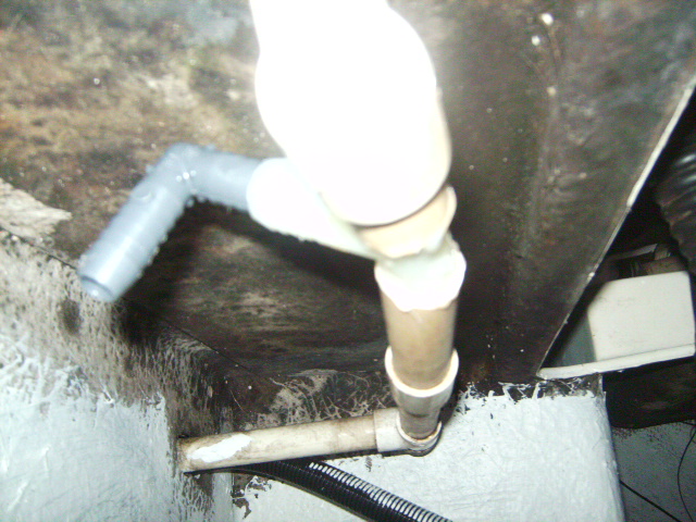

I had a drain problem also. Didn't want to add a through hull, heard horror stories about their failures, didn't want water in bilge either. I was able to run 1' flexible hose from the bottom of the sink to the cockpit scuppers about 4' away. Obviously it must all run downhill, but if near enough and you can access the PVC pipe that connects the two drain holes in the scuppers, the parts are super cheap. Some elbows for routing, and a T mounted into the pipe, and a few radiator style clamps and caulk to seal everything, is only several bucks. It's the work in confined space that determines the efforts. The rocking keeps the drain free. If you decide this can work for you, let me know and I'll tell you details of hose and fittings.
Pic of T mounted in scuppers and final elbow for drain tube before turning up and sealing.
