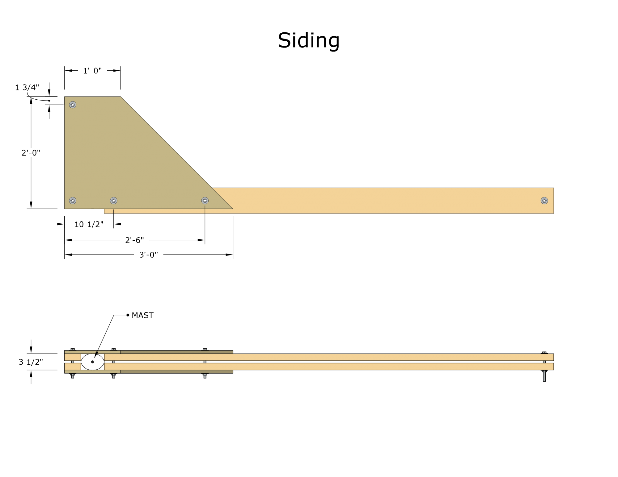

- The shrouds are just aft of the mast, so I can leave them where they are and will only have a little bit of slack to deal with.
- My gin-pole is custom built and will really hug the mast just below the gooseneck. I've attached an image, but it's 2x6 lumber that will be held together with 1/2" diameter galvanized hardware.
- As you can see, the gin pole is going to have siding that is constructed of 3/4" plywood, which (might) help steady any side motions, but again: the shrouds.
- I will be lowering the mast with both block & tackle and an extra winch that I have, which will be mounted to the gin pole near the mast (not shown, just didn't model it). This should allow me to "pause" the lowering for anything.
- I have also constructed a support system at the stern, which will sit 6' ft above the cockpit seating (I'm lowering towards the stern).
