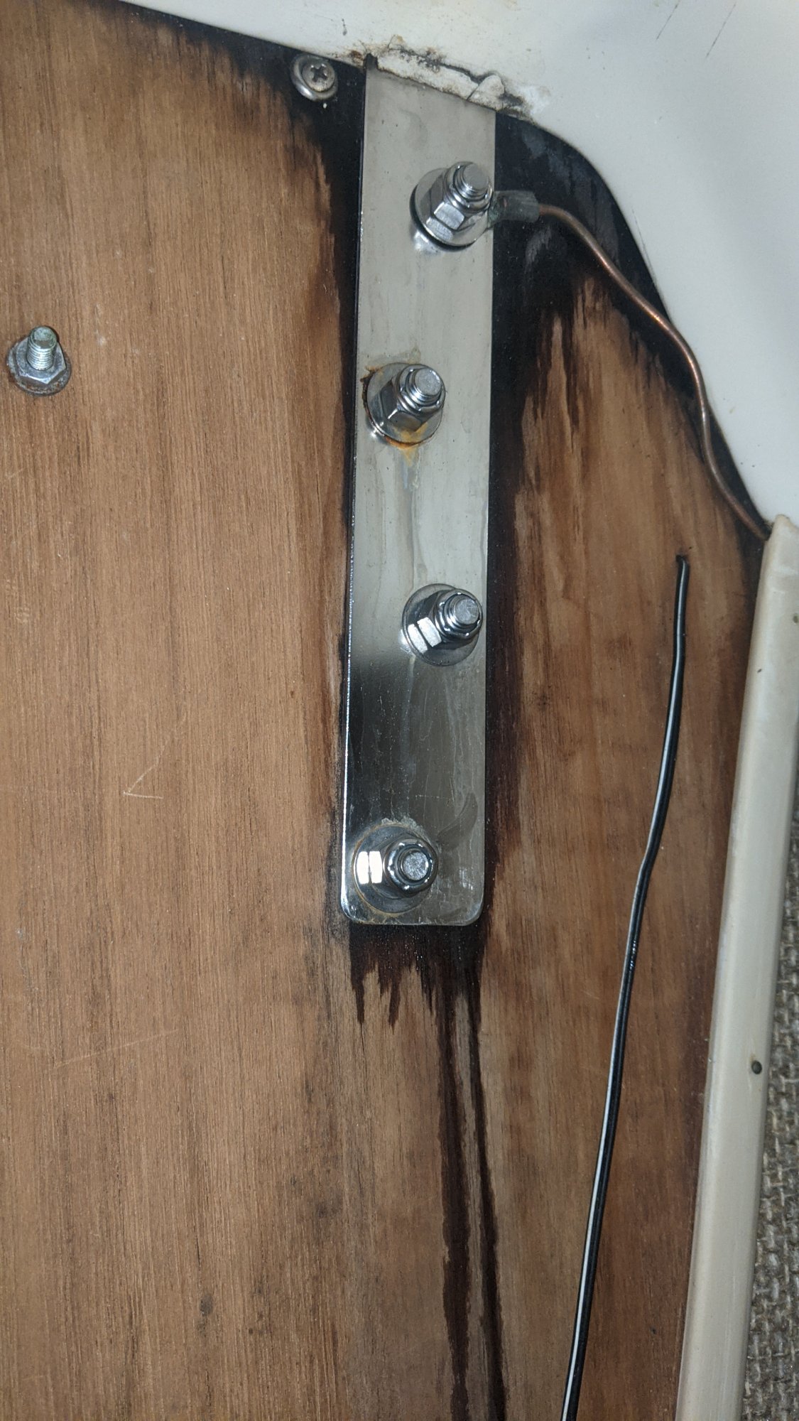

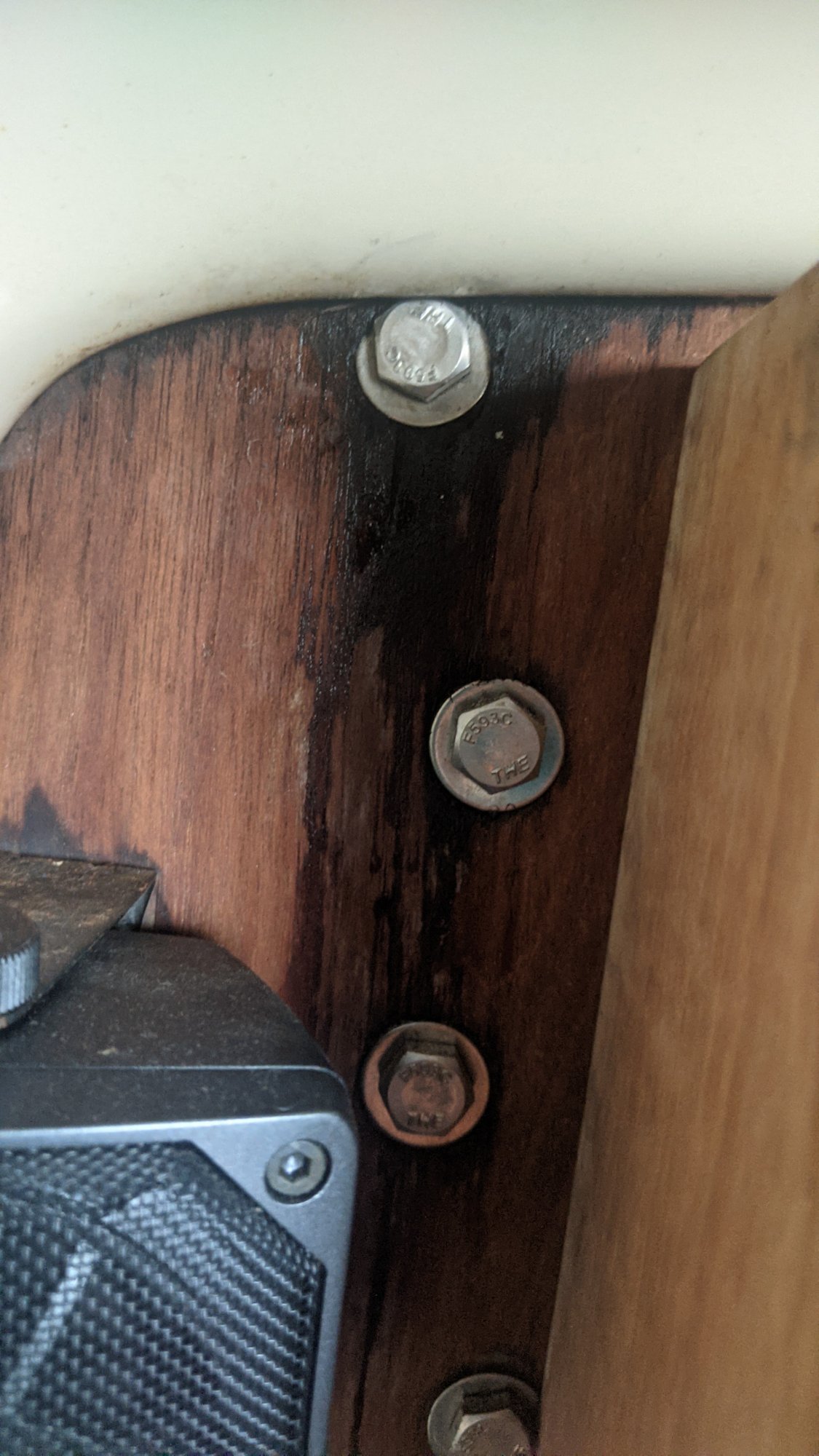

I am interested in an O'day 26 and inspected the boat after a rain. One of the chain plates has a leak and the bulk head was wet at the top. I have heard this is a common issue for Oday 26s and 25s. How much water is too much water? I am scared that this happens with every rain storm and even if I rebed the chain plate, the job will not removed the water already in the core. The bulk head feels solid except around the upper most bolt. When I poked the upper most wood, it compressed slightly under my finger. The current owner said he is unaware of the leak. Thumbnails of the bulkhead included below and I have attached the full images.
Is this a big leak? What repair work may be needed? I liked the boat, but do not want to buy something rotting from the inside.

You also have to plan on replacing this bulkheads. Once they are soft they will not properly anchor the chain plate. This could result in the chain plates pulling out of the bulkhead.

The problem is less about the chainplate leaks (you can reseal those), but more about any damage done to the decks and to the bulkheads where the chain plates are attached. Those wet bulkheads don’t look great to me. they can be fixed or replaced, but not easy or cheap. Soft decks are probably harder to fix if there is extensive core wetness or rot.

Yeah, you need to replace those. I had to do both in the 25 I used to own. At least these don't seem to be rotted so much that you lose the shape and can use them as a template. Take down the mast as you are going to need to work inside and out for a bit. Its just easier to do it that way. Once done, that deck penetration is a maintenance list thing. Always check it for water ingress. I would check every deck penetration for moisture. I had to redo toe rail screw penetrations and the core under the mast step. Unfortunately, this is an O'Day thing due to their manufacturing processes.

I also noticed the chainplate had elongated the through holes in the bulkhead. Our 25' Oday is an 1981 . We have been fortunate that we have not encountered the leaking decks of other owners . When I replaced the bulkhead ,I saturated the ends and holes with clear epoxy . Now if there every is a leak it wont get into the wood . I also added a stainless strap to the back side of the bulkhead to clamp ,or sandwich the wood . This ,in theory should help spread the load from the chainplate . It also looks much cleaner and professional .

Do you have a picture of your added SS strap? Are you referring to through hole elongation you can see in my pictures?
