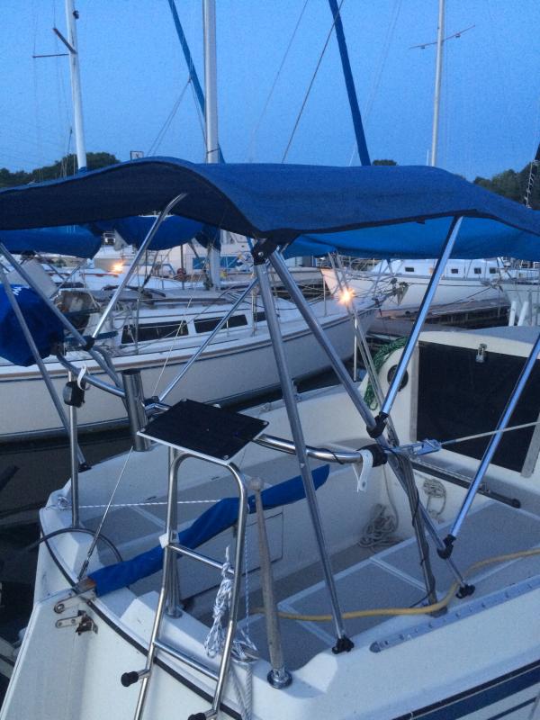

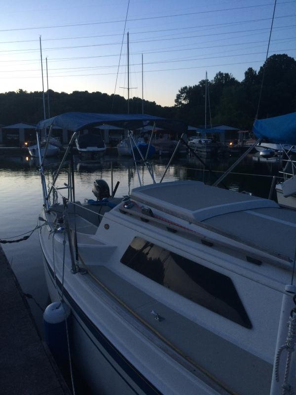

I've recently ordered and installed a bimini top on my 84 O'day 26 thanks to a owner that was selling his boat on sailboatlistings. I noticed it and inquired on the dimensions.
I've seen many questions about the o'day 26 bimini here and on sailnet so I thought I should post.
The overall size is a tad big but I think it fits pretty well with maximum coverage. It is 6' Long x 46" High x 67"-72" Wide. Those are the specs for the kit that I ordered. You might think 6' is too long but mine just comes over the stern rail about a foot and voila! It sits just a tad high for my liking but can be easily lowered if you want to trim the poles. The width is perfect.
Forgive me with the dark pictures, it was getting a little late when I finished.

This is the one I ordered although I chose the wrong color (Picture is pacific blue but actually navy blue). It says down in the description that it's navy blue but I didn't read that far. It's not a real dark navy so I'm just going to go with it. For $94 I don't expect to get that many years out of it so I'll get the right color when I need another. The frame is of pretty good construction and everything was straight and fit nicely. They only gave me one screw even though shipping manifest listed 12 screws but I just went to Lowe's and picked a few up.
I counter sunk the holes for brackets and used butyl tape to seal.
The pictures don't show where I temporarily just cut a slit in the top for backstay to come through. I'll have a Zipper or Velcro stitched in for that.

It does retract aft and is supported by the rear legs although you must disconnect backstay in order to do so.
I had to raise topping lift a few inches but the main still raises it a bit more so sailing with it up is no problem. The main sheet is well clear of it.
I can stand up under it just fine and I'm 6'2 but it's not so tall that it looks ugly.
It needs a slit cut in it for the backstay (a little off center on the 26'). This can be done several ways with the preferred way probably installing a zipper.
