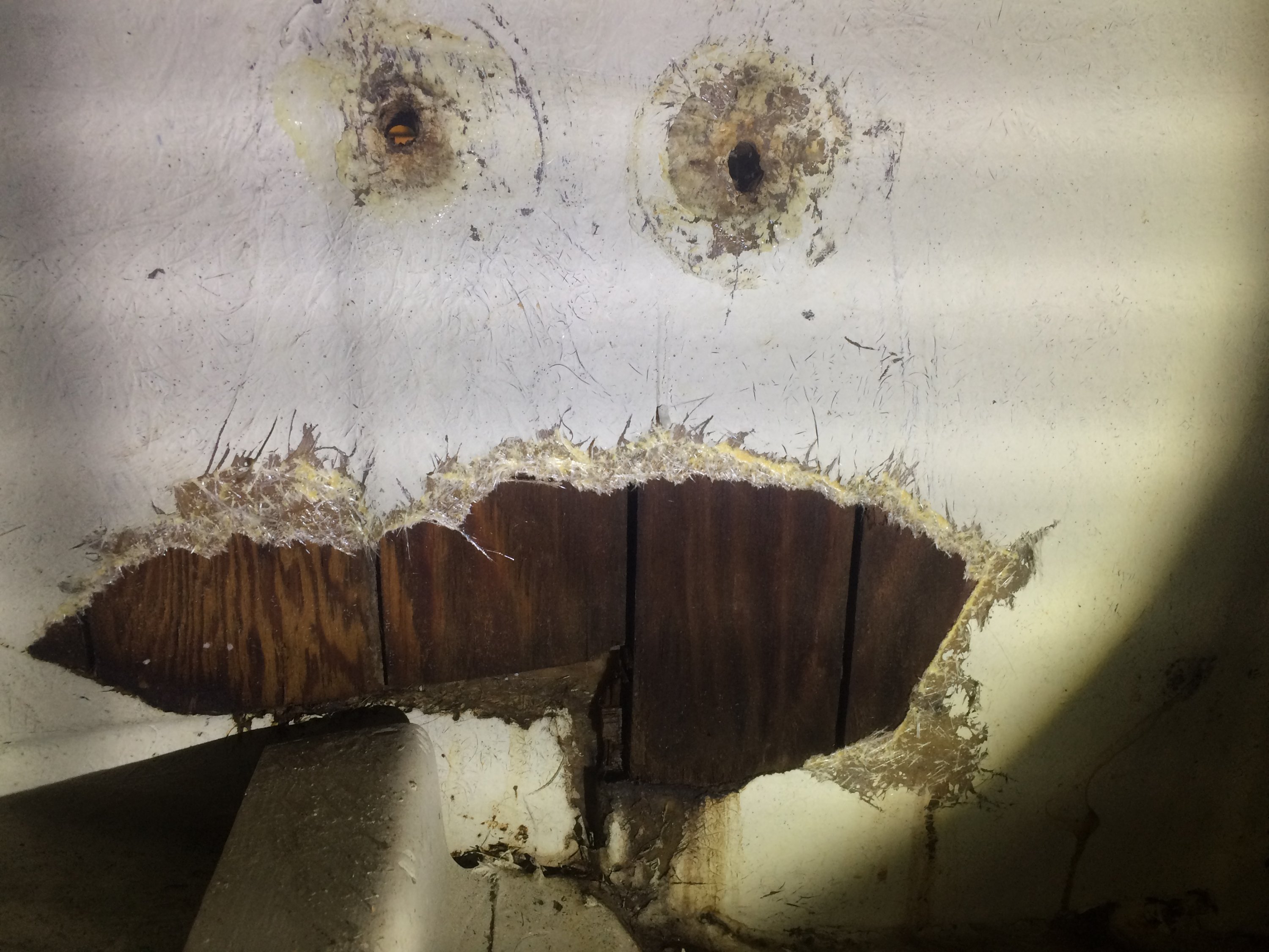

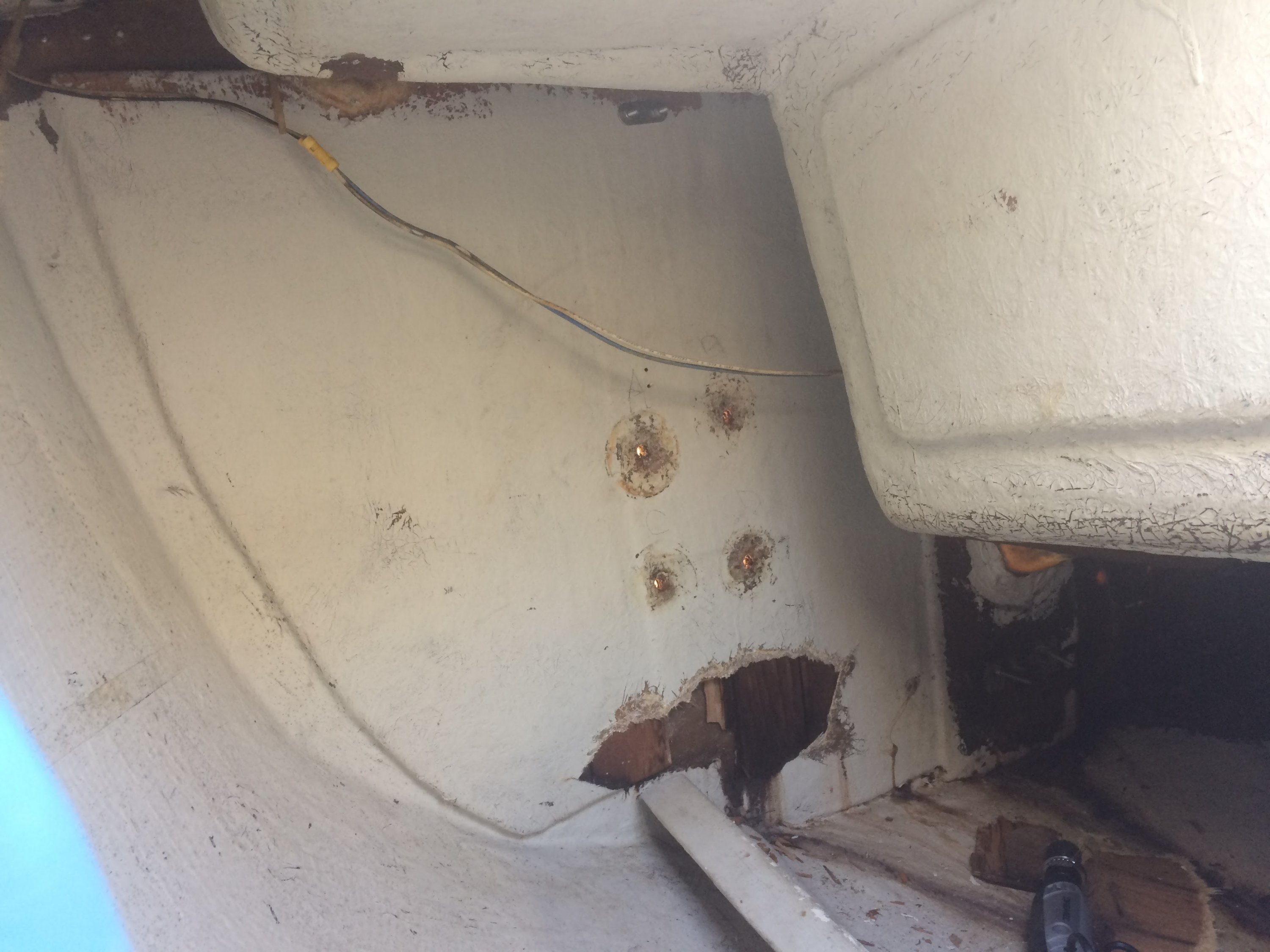

This topic is well versed on this forum in various threads, but I figure why not start a new one regarding my personal endevours.

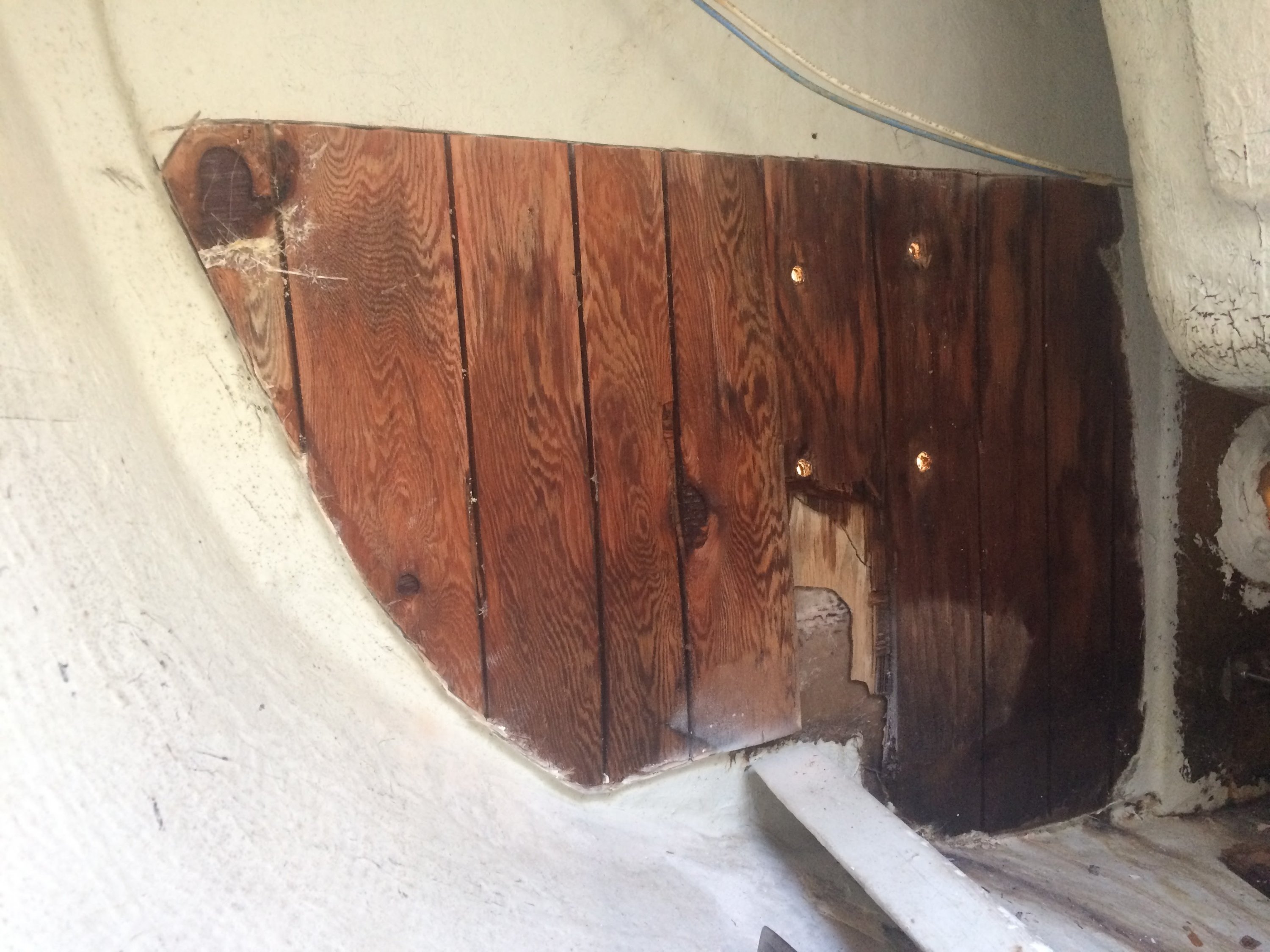

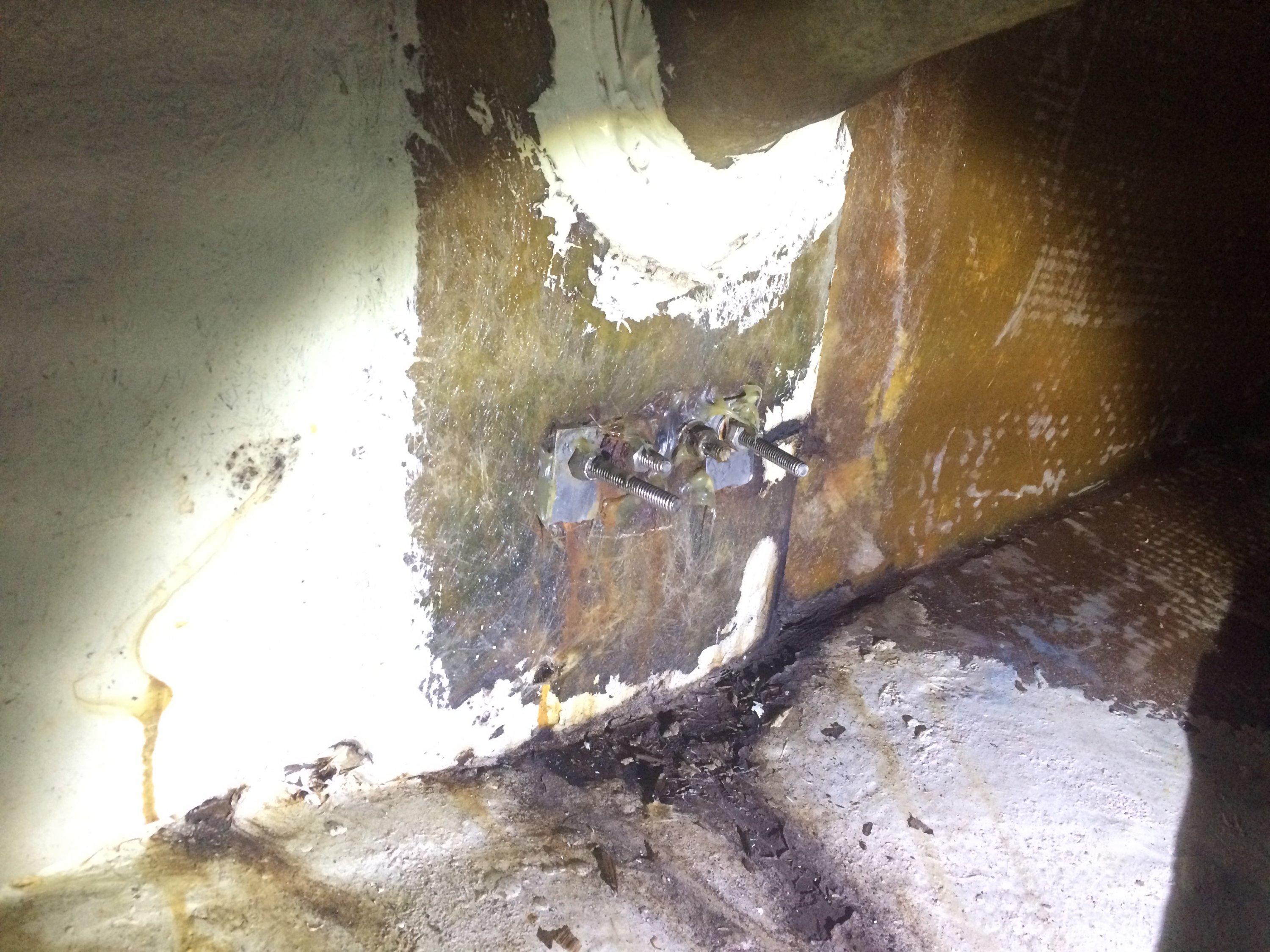

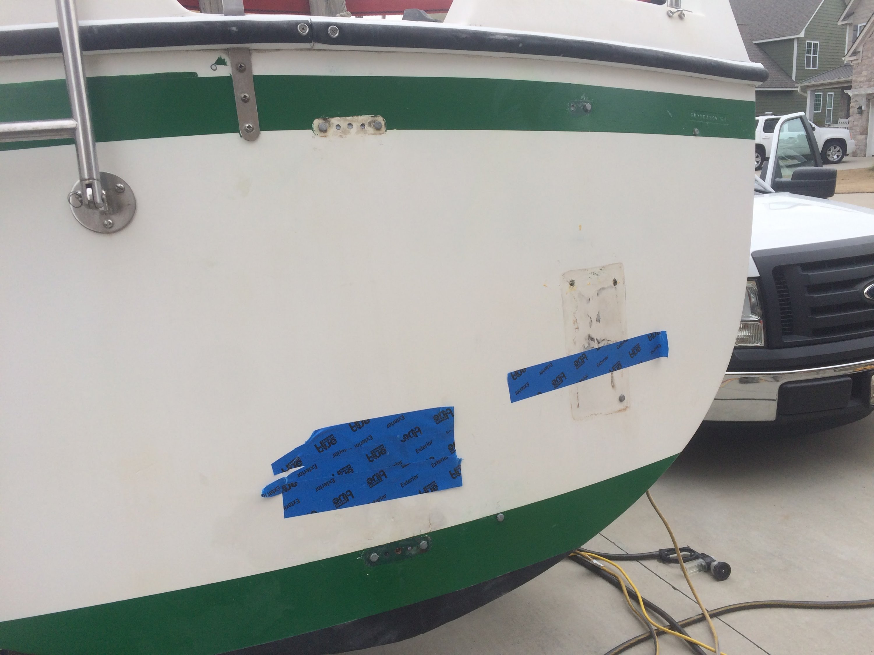

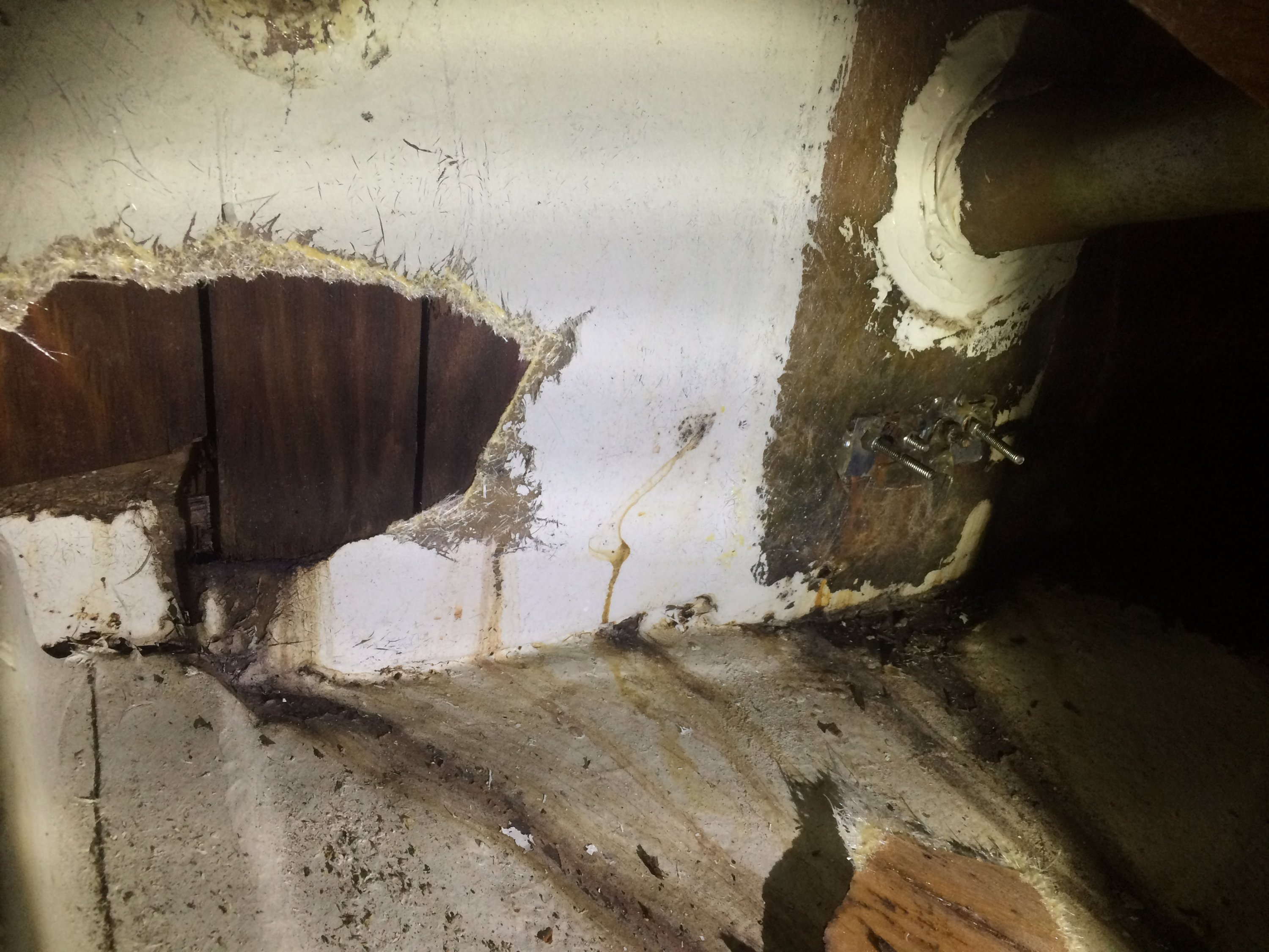

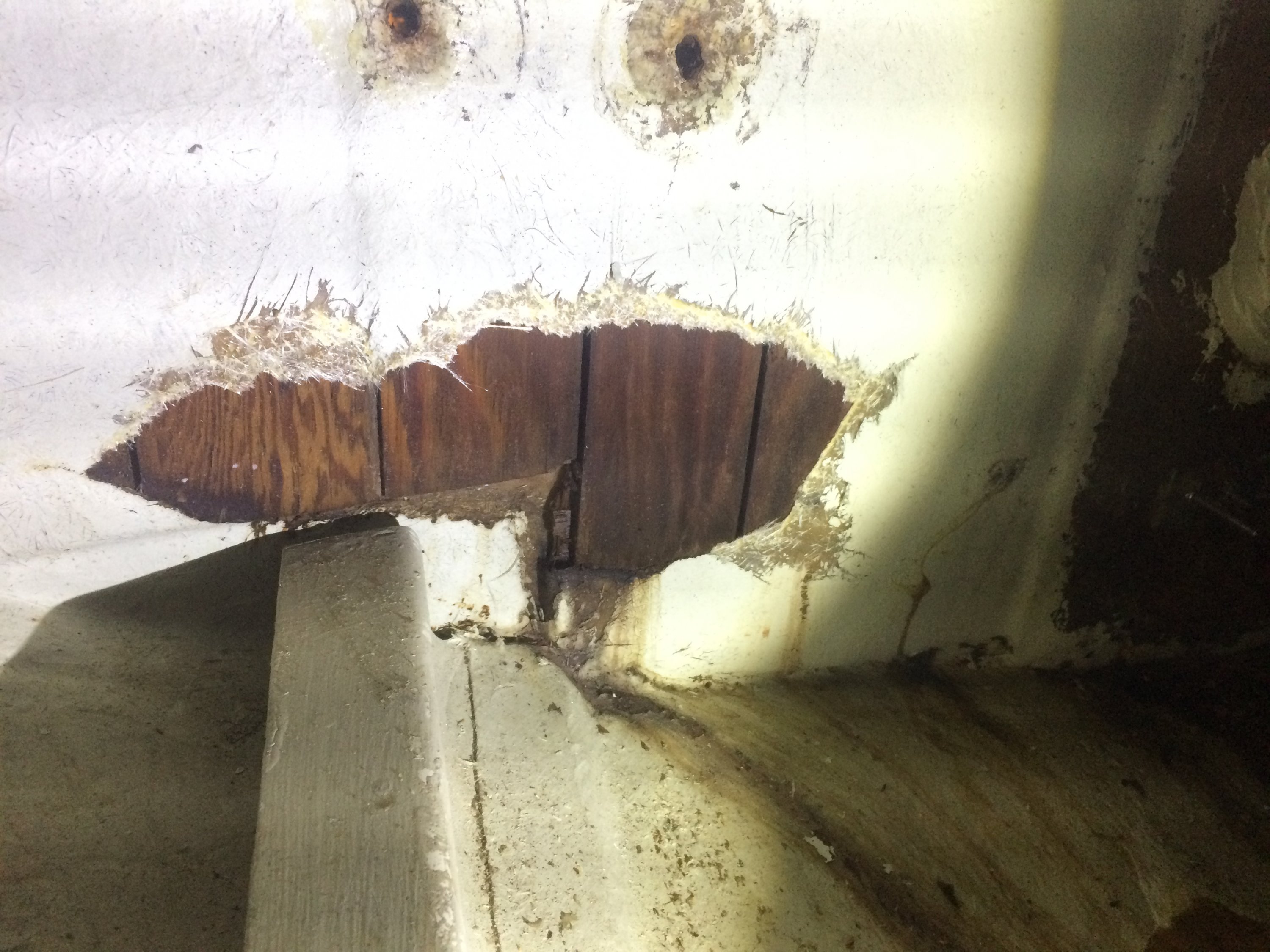

So this all started with the idea of repowering my 1978 o'day 25 with a new 9.9 4 stroke Honda long shaft. I'm almost certain the original mount is stock, and most likely inadequate. (fighting the old 8hp Honda up and down gets old). The planned replacement mount is a new Garelick. Researching leads me to discover this will require a new spacing block. No big deal. Further reading reveals that a frequent problem that arises here is water intrusion and rotten core. So, off comes the old mount...and of course...my boat has water intrusion and rotten plywood...YAY!

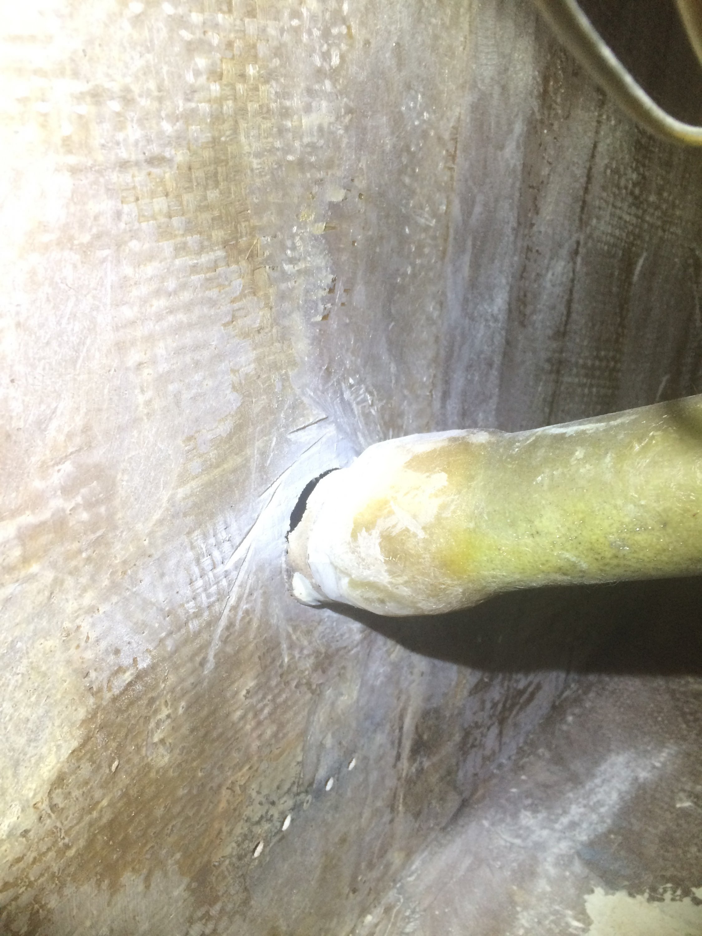

So now I'm looking at rebuilding the transom and lower gudgeon which is also rotten due to leaking from the topside drain.
I've attached pictures, and will post progress as it happens...looks like I will be tearing out and replacing the starboard plywood and lower gudgeon plywood. Adding new blocking for a new motor mount, and resetting the lower gudgeon hardware. Does the best backing need to be 1/2" marine plywood? Or is there an easier and stronger material?

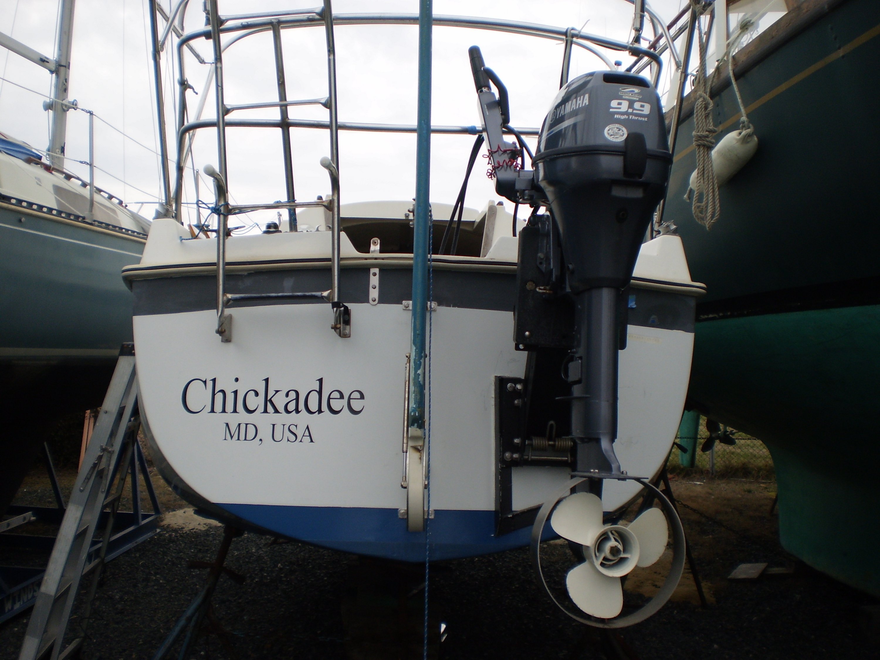

I replaced a rotten transom on my Oday 25 a few years ago. I had a new 'wedge' built out of 3/16 aluminum and installed that wedge and a new motor mount with a 9.9 Yamaha high thrust outboard. Last year I took the boat down the icw from Maryland to Florida and then over to the Bahamas all the way down to Long Island. There were no problems with the outboard. If you are interested in what I did send me a private message and we can talk.

Looks pretty rotten. I had an Oday 25,1977 vintage. I caught my lower gudgeon leaking, and it was also cracked on a weld.. One good thing is that there is plenty of room to work down under the cockpit on that model.

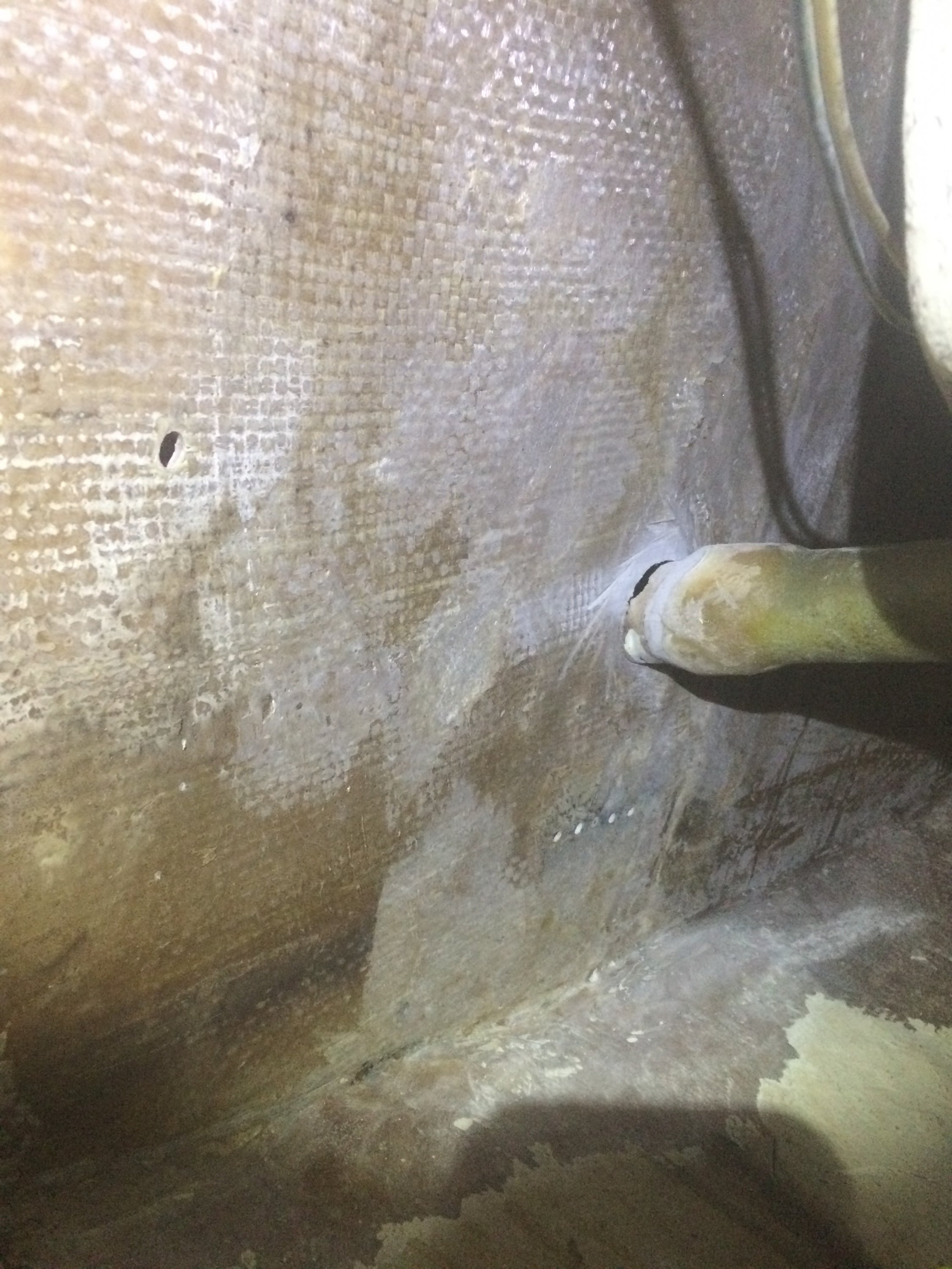

UPDATE:

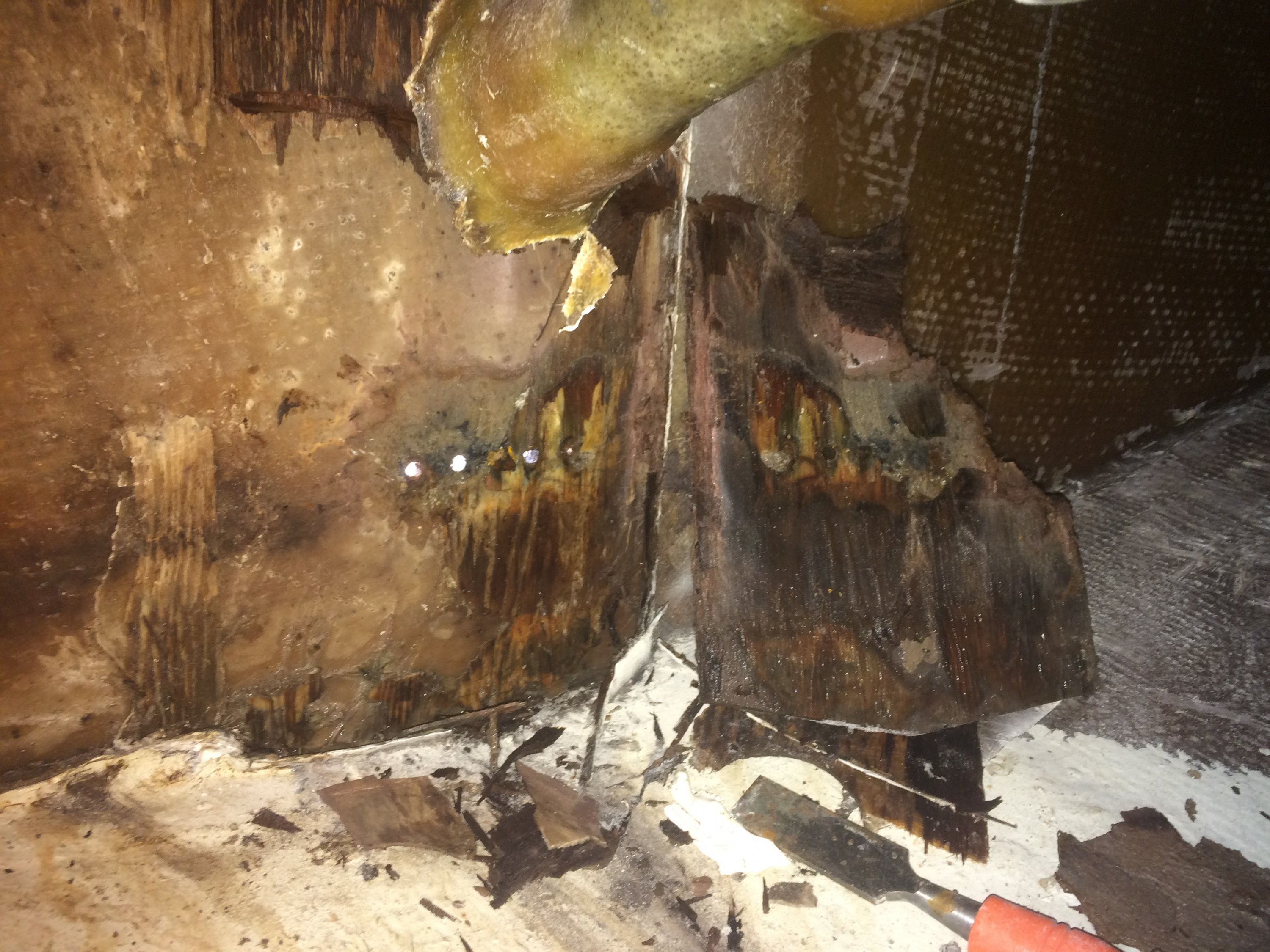

I spent the day ripping out the old wood and inboard fiberglass, and grinding away the old glue.
A few tools are must have for this. 1: Box fan, Placed over the access door to exhaust dusty air, nice to have when you need to sit up and take a break. 2: Shop vac, I'd say I ended up with over a gallon of white dust...cleaning as you go is a must. 3: PPE: Goggles, respirator, ear plugs, tyvek suit, gloves...This. is. a. dirty. job. 4: Grinder with a low grit flap disc, rotary Dremel with reinforced wheel, oscillating Dremel. A Sharp Chisel (chipping glue off is much more desirable than grinding) hammer, and pry bars.

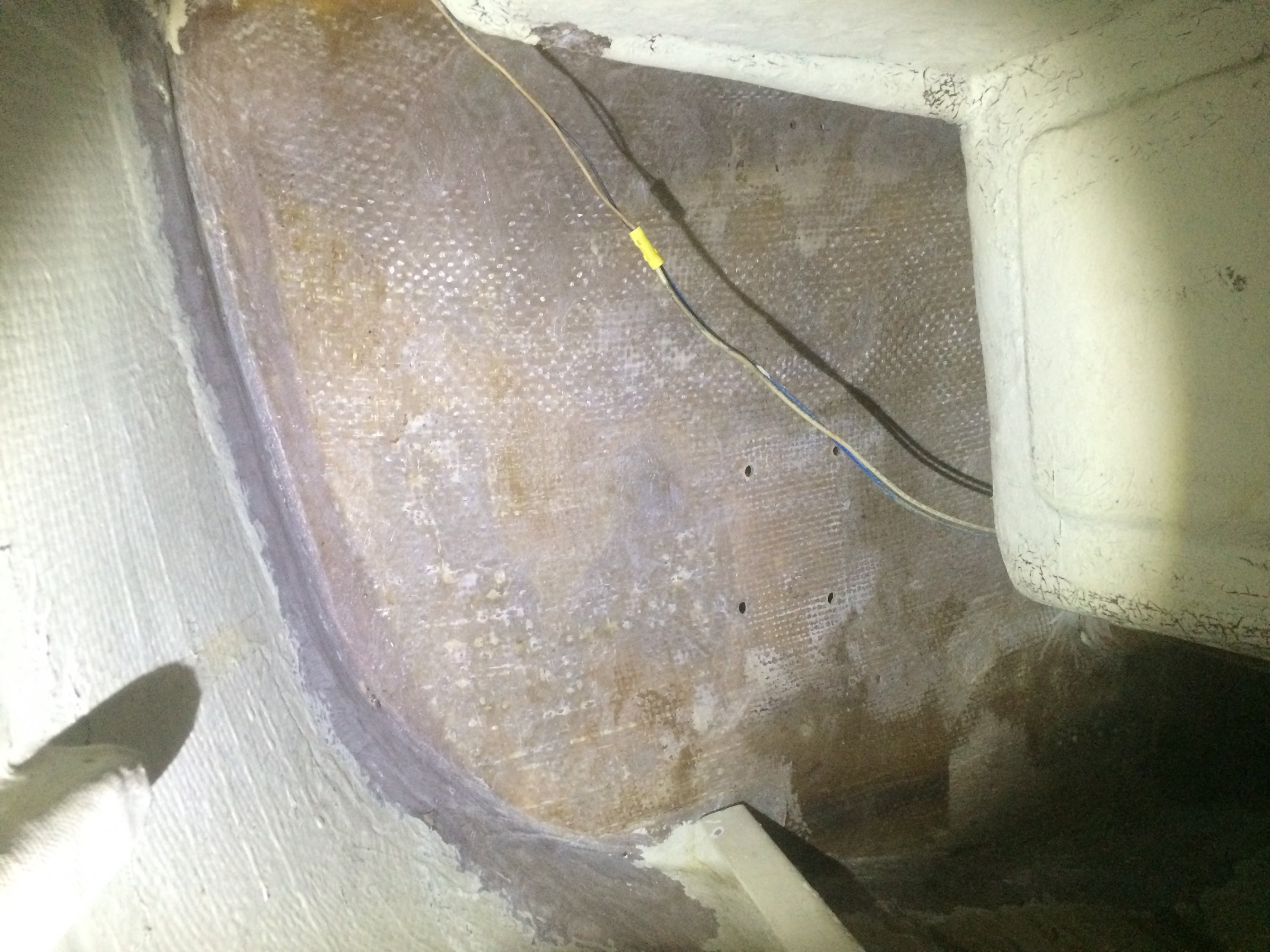

Update part 2:

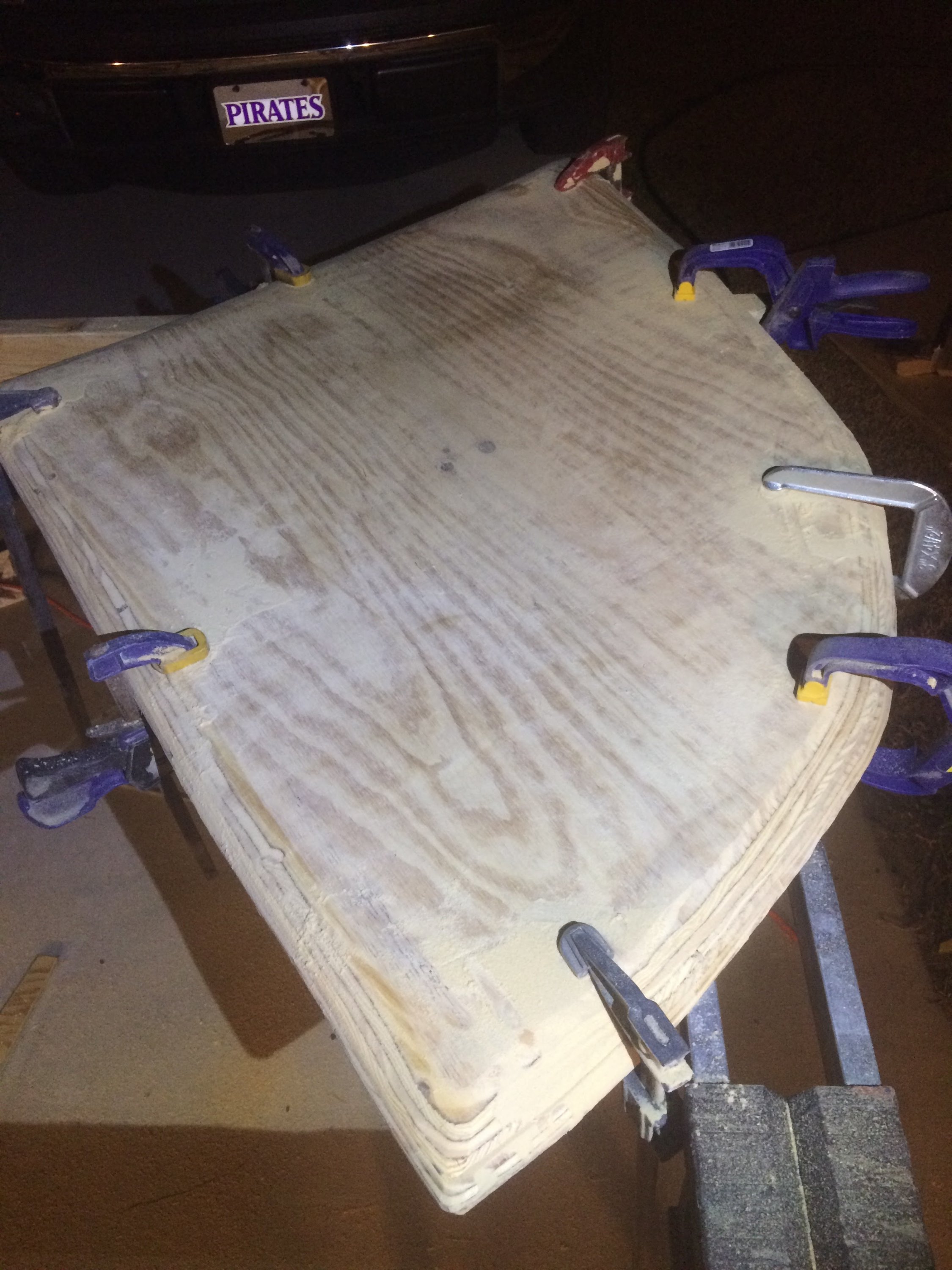

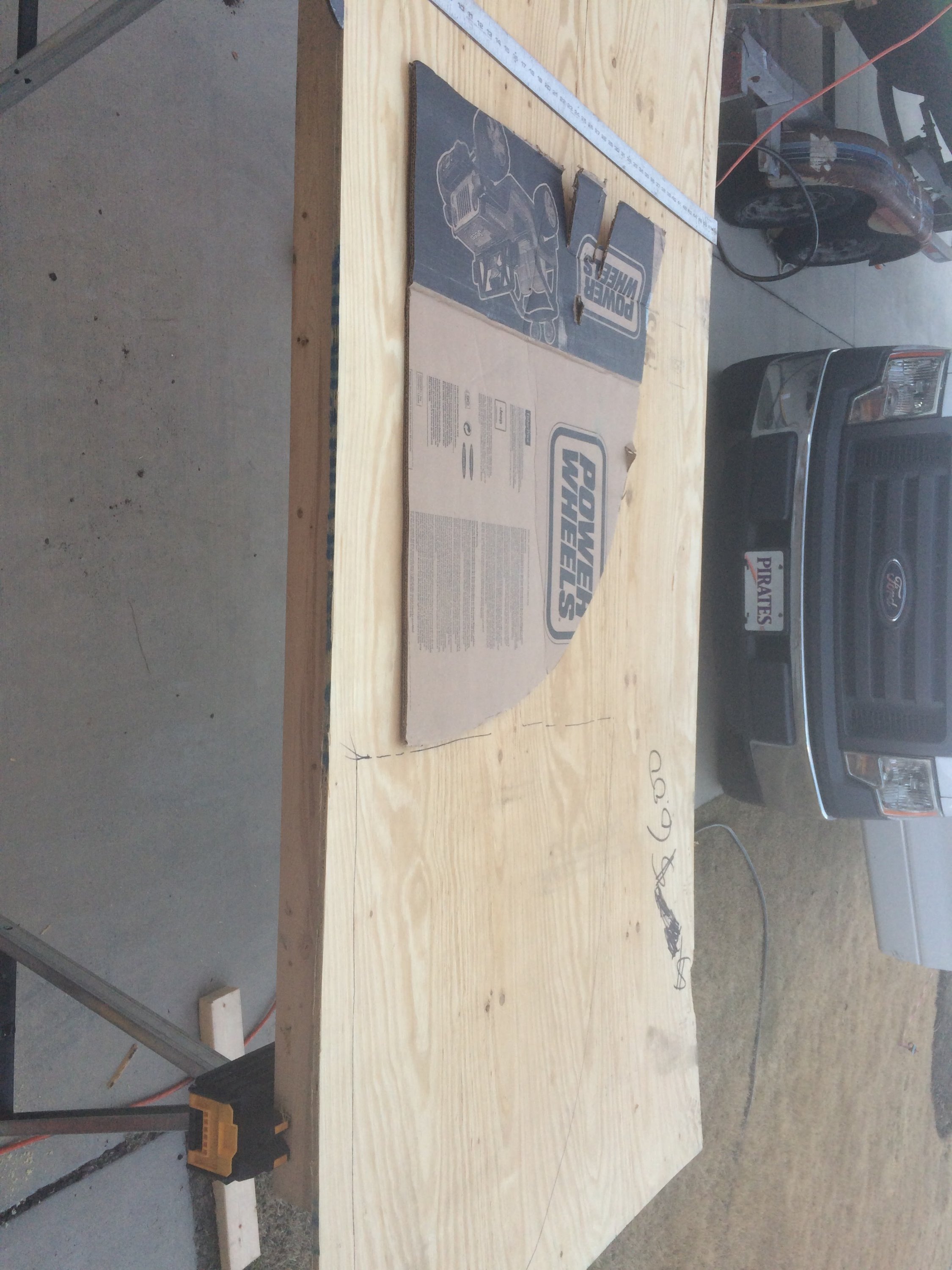

So after an extensive cleaning (vacuum, rinse, repeat...) I was able to make a transom template with cardboard, and transferred the shape to a piece of plywood (getting the transom curve is much easier on the outside!) I ended up going with 1/2" BC Exterior plywood from Lowes for a few reasons.
1. Cost: I bought a 4x8 piece with a crack in the corner for $6. Apparently no one in Wilmington stocks 1/2" marine grade, and most quoted over $100 with at least a week lead time.
2. What i was ripping out looked more like T-1 11 than marine grade plywood, and it held up this long. Also, the new plywood will not be getting wet. Any penetrations will be drilled out, epoxied, and sealed with butyl tape. I avoided pressure treated because I was worried about encapsulating a piece of wood with such high moisture content.
The plywood is shaped, and clamped together overnight. I tapered the edges to encourage the fiberglass bond.

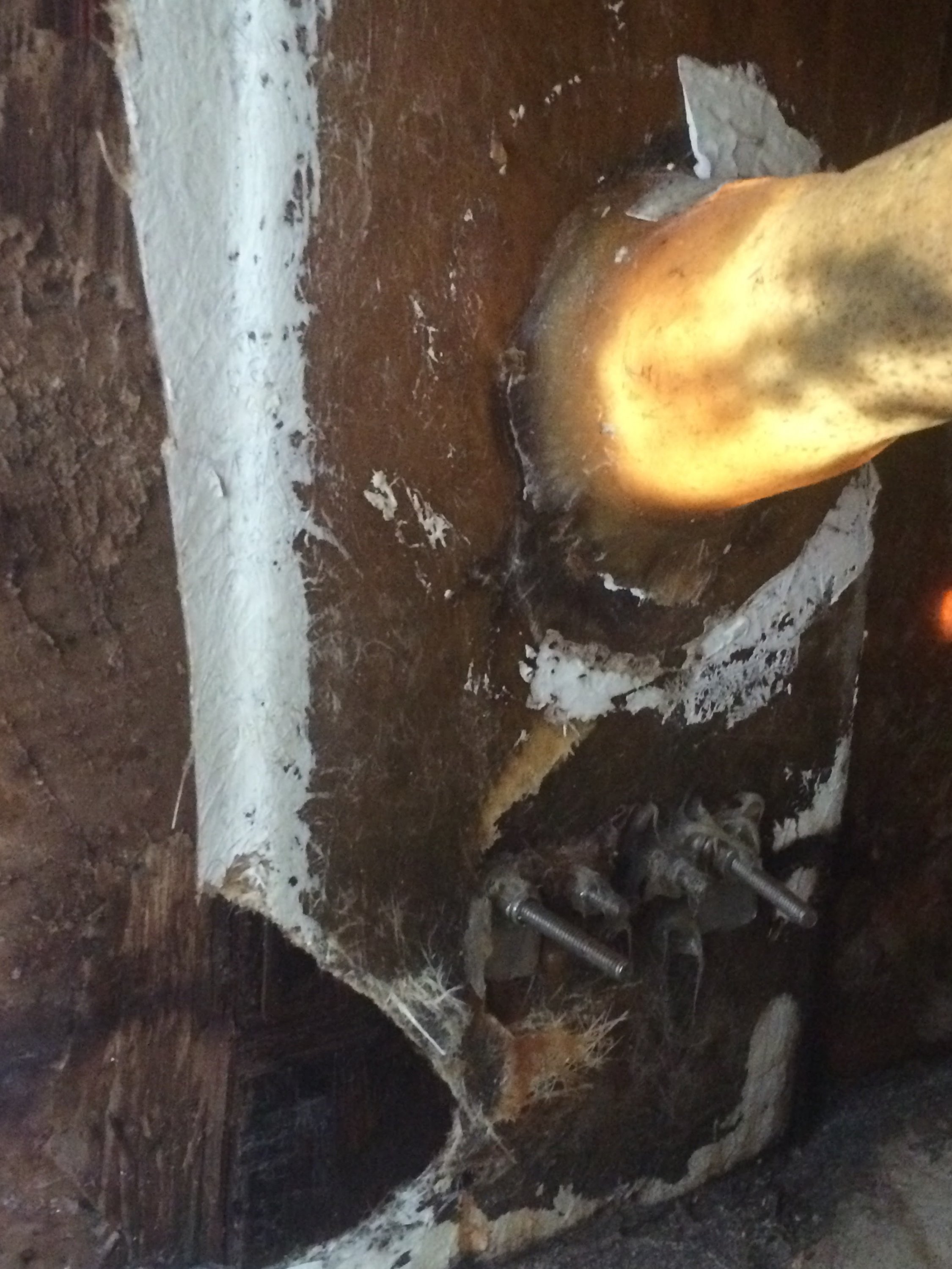

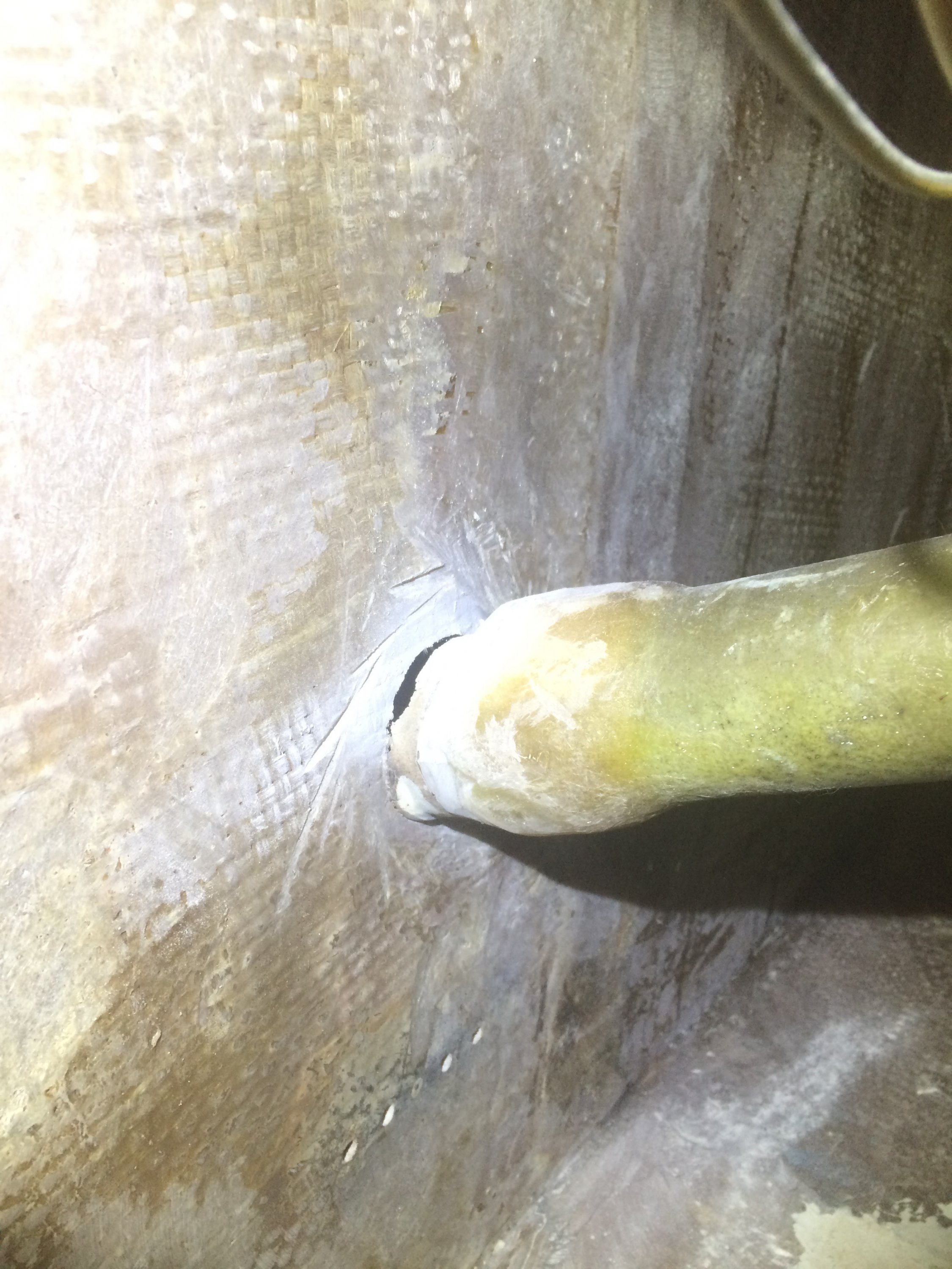

Now here's what I'm left with

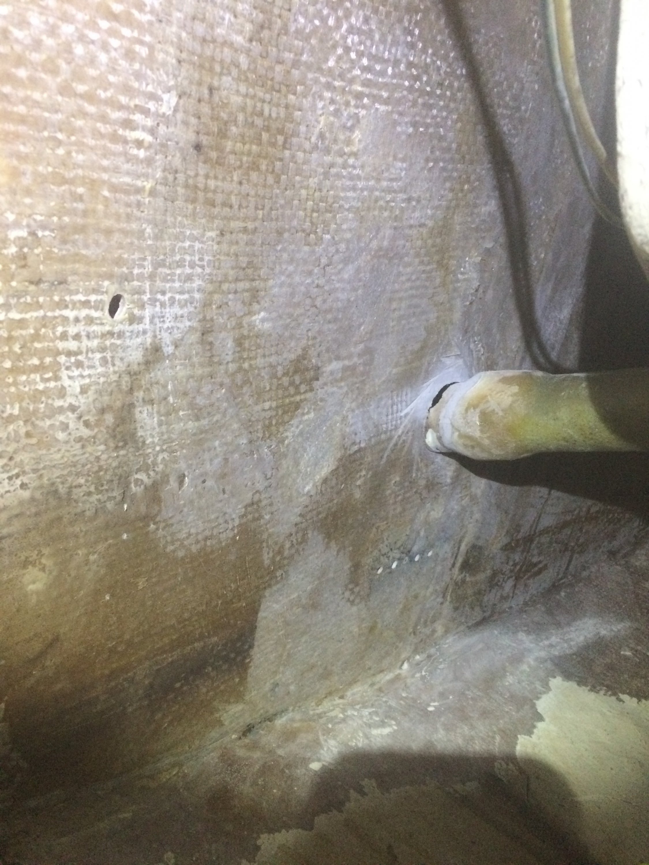

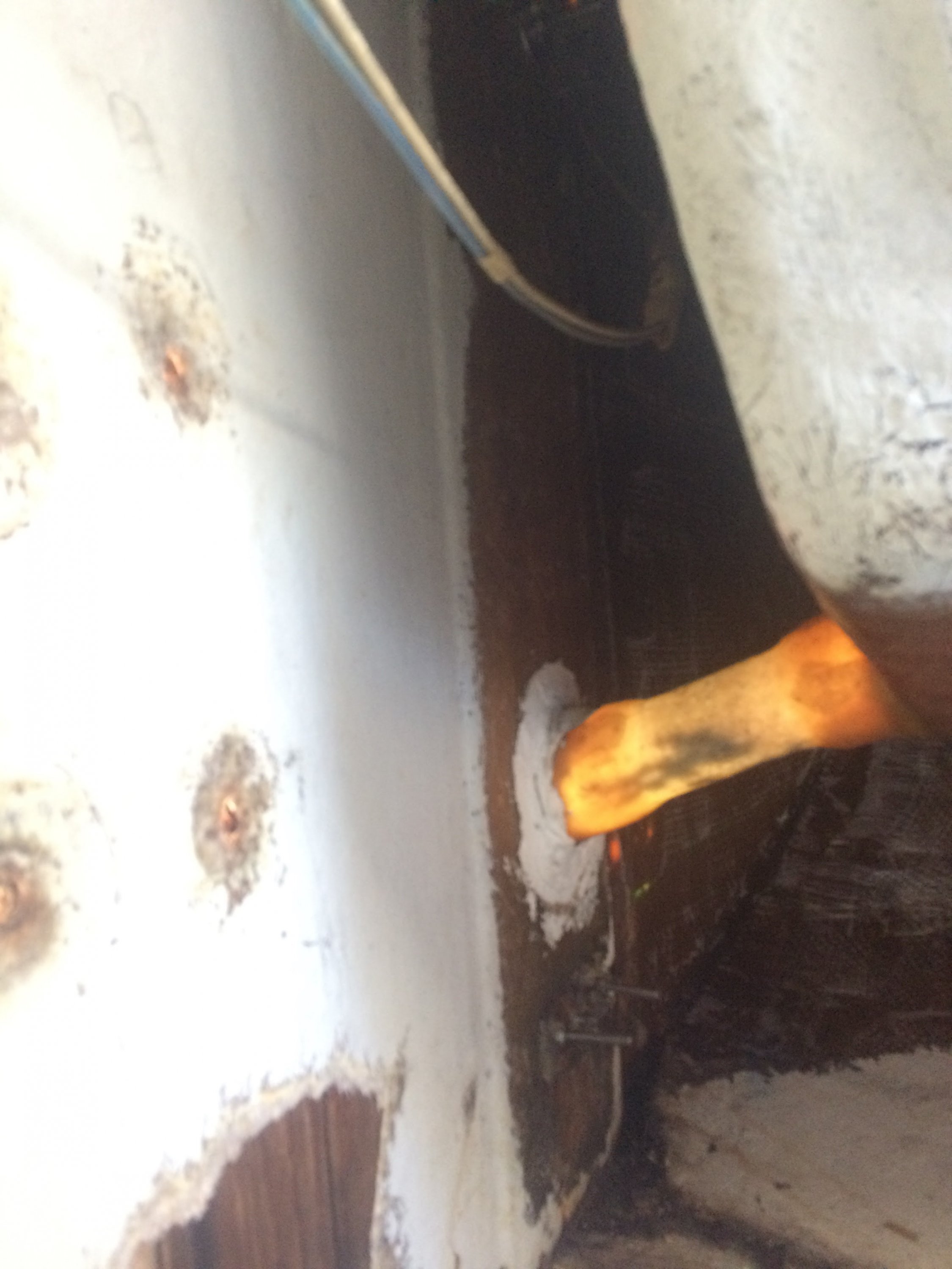

1: Come up with a way to tie the cockpit drain back to the transom. At some point the two became completely seperated.
2: Come up with a way to fit the plywood around the drain in order to keep the wood continuous. To cut the drain, or not?!?!

On my 1976 Oday 25 the cockpit drain setup is two 1 1/2 inch mushroom head thru hull fittings connected by a length of 1 1/2 inch marine sanitary hose. The mushroom barbs point at each other under the cockpit. This setup would allow you to remove the glassed in drain making the installation of the new transom easier and stronger.

I will be interested in knowing how you get the new laminated plywood transom to conform to the curves of the boat transom. The new transom does not look like it has much flex to it. When I rebuilt my transom I rebuilt it from the inside of the boat (under the cockpit) laminating three 1/4 inch plywood sheets one at a time. The transom shape was maintained and I got a good, solid fit with no voids.

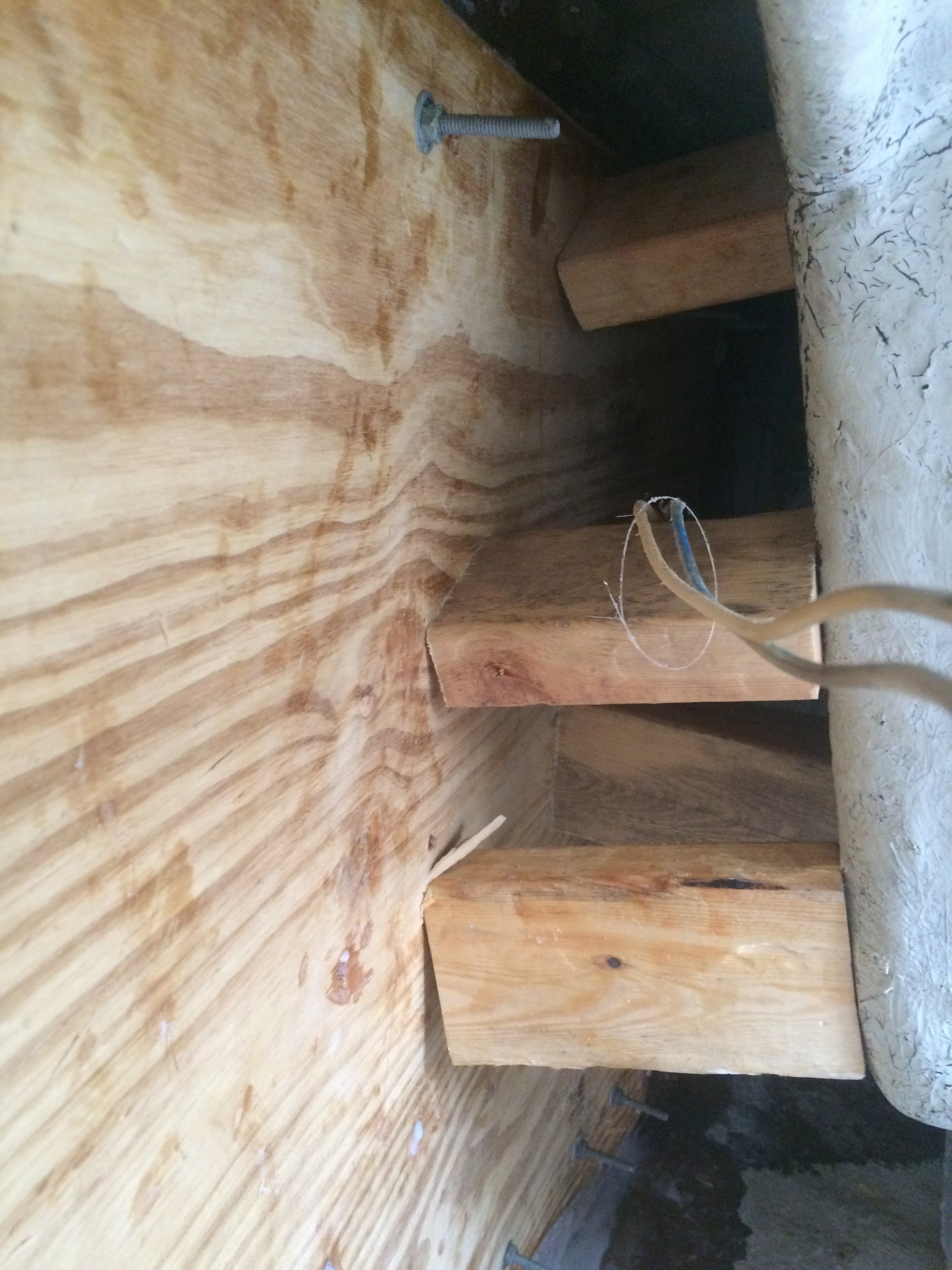

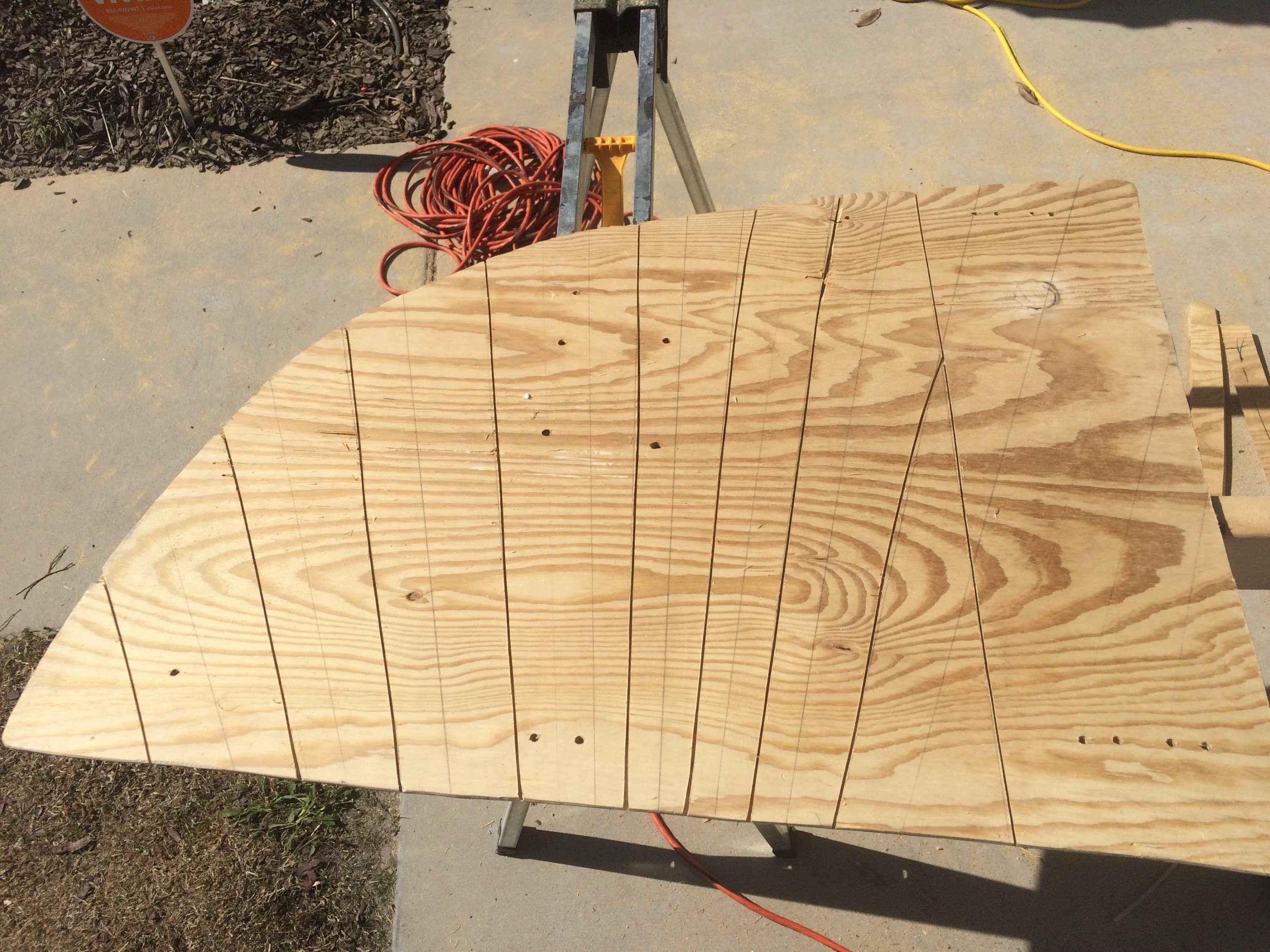

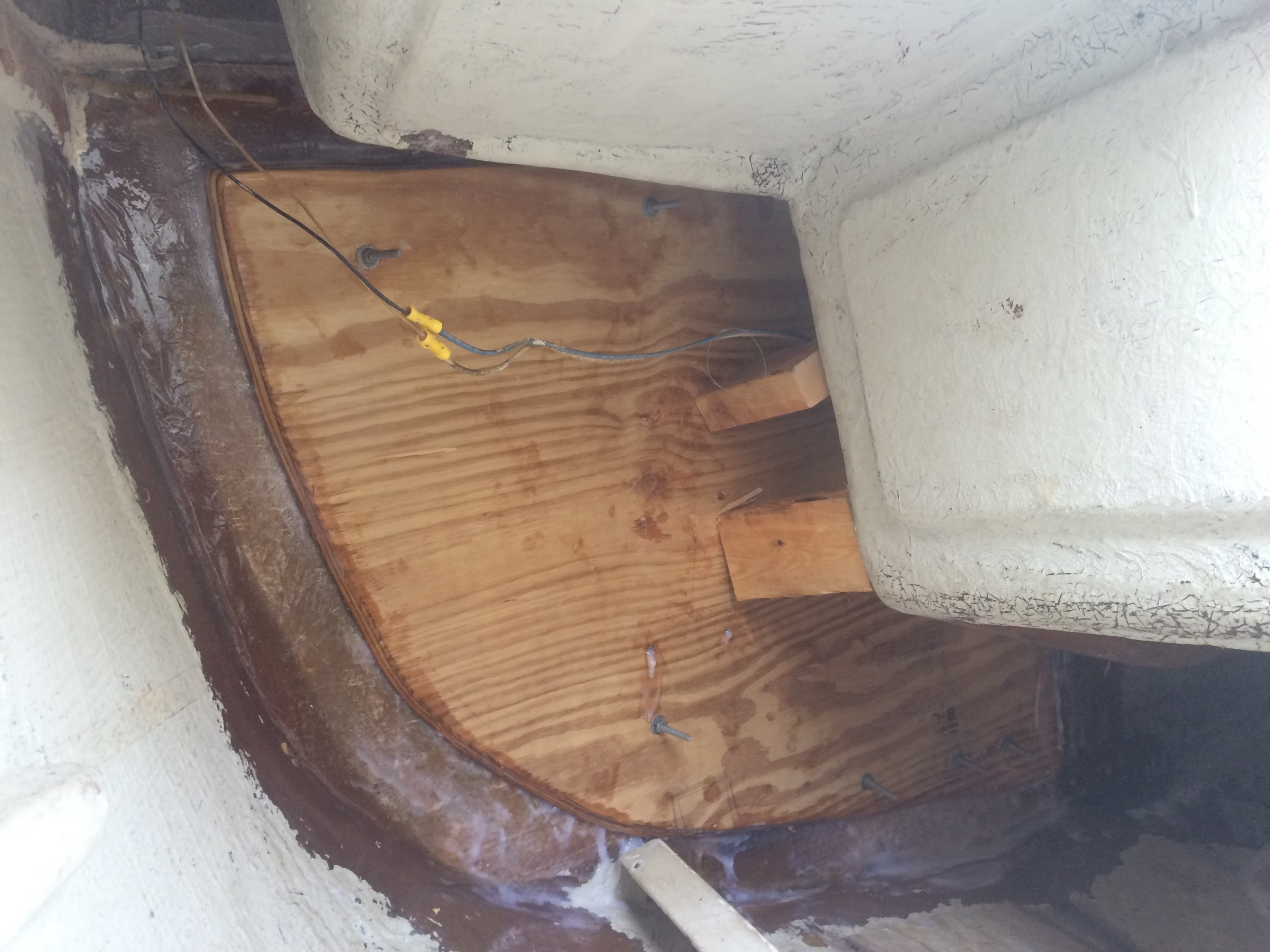

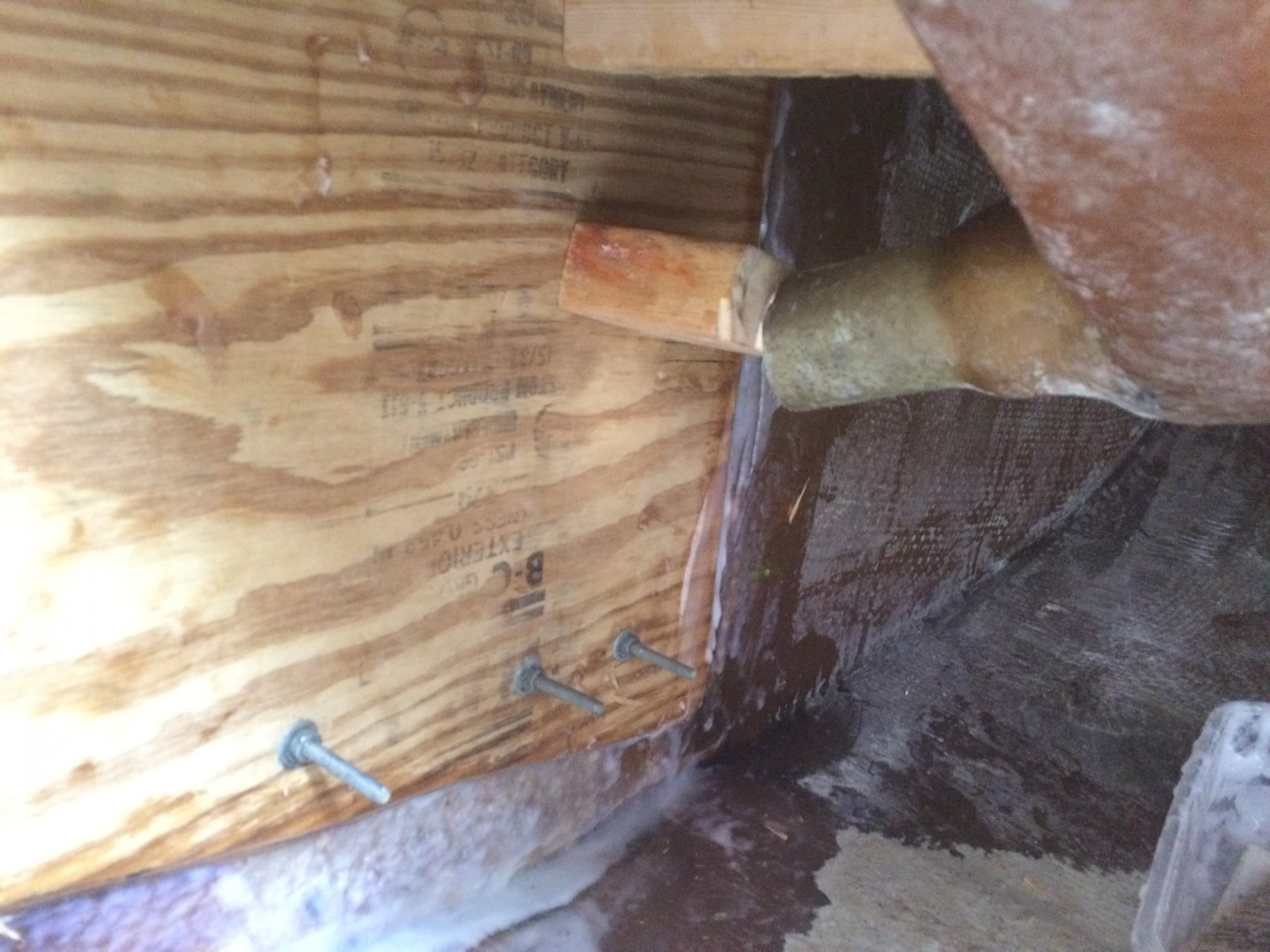

The first layer of plywood is in! Started by fitting the first sheet in place and temporarily wedged it to stay with a few 2x4s. Back outside i drilled all the holes i would need through the plywood using the existing as a guide, and a few extra (2 in the paint stripes, and 1 below the motor mount to make repair easier) that i would end up using to thru bolt and tighten down the new plywood once glued. Then templated these holes to the second layer. I used a skil-saw to make 1/8" grooves on the back of the plywood to help mold the curve in the transom. A previous poster recommended making these in a 'ray' pattern, which i know helped!
Now for the install, 2 primer coats of epoxy on the back of the plywood. Next a quick Acetone washdown, a coat of Epoxy, and woven glass on the inside of the transom. Next used almost a whole container of West System 403 and smeared the entire face of the transom with 'mayonnaise'. Carefully fitting the plywood in place, I used a few bolts from the inside to line up the holes, then went outside and pushed the remaining bolts through. (greasing them up with Caranuba car wax apparently keeps the epoxy from bonding to the bolts) Tightened up all the bolts, and used a few 2x4s cut to length to wedge the plywood in place. A few things I would recommend 1) tape off any thing you might tough getting on and off the boat and through the door, the epoxy gets all over you no matter how hard you try not. Also get an old hat. I did not do this and now I look like Ben Stiller from "There's Something about Mary". Get an auto-ratcheting wrench. Over drill the holes in the plywood to help line up everything.

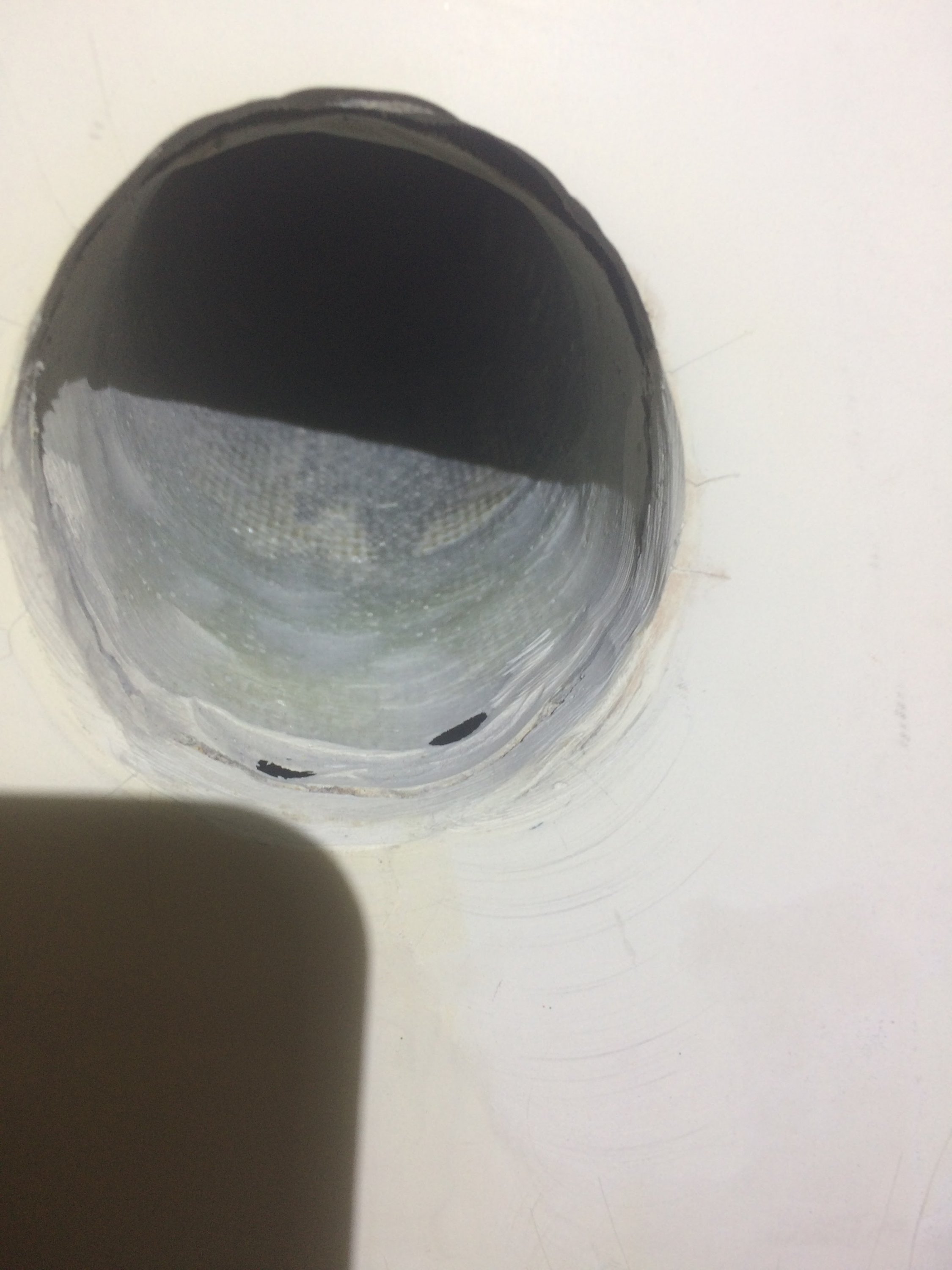

I cut out the cockpit drain, and plan on re-routing it down and out the port side of the transom using some thru-hulls...

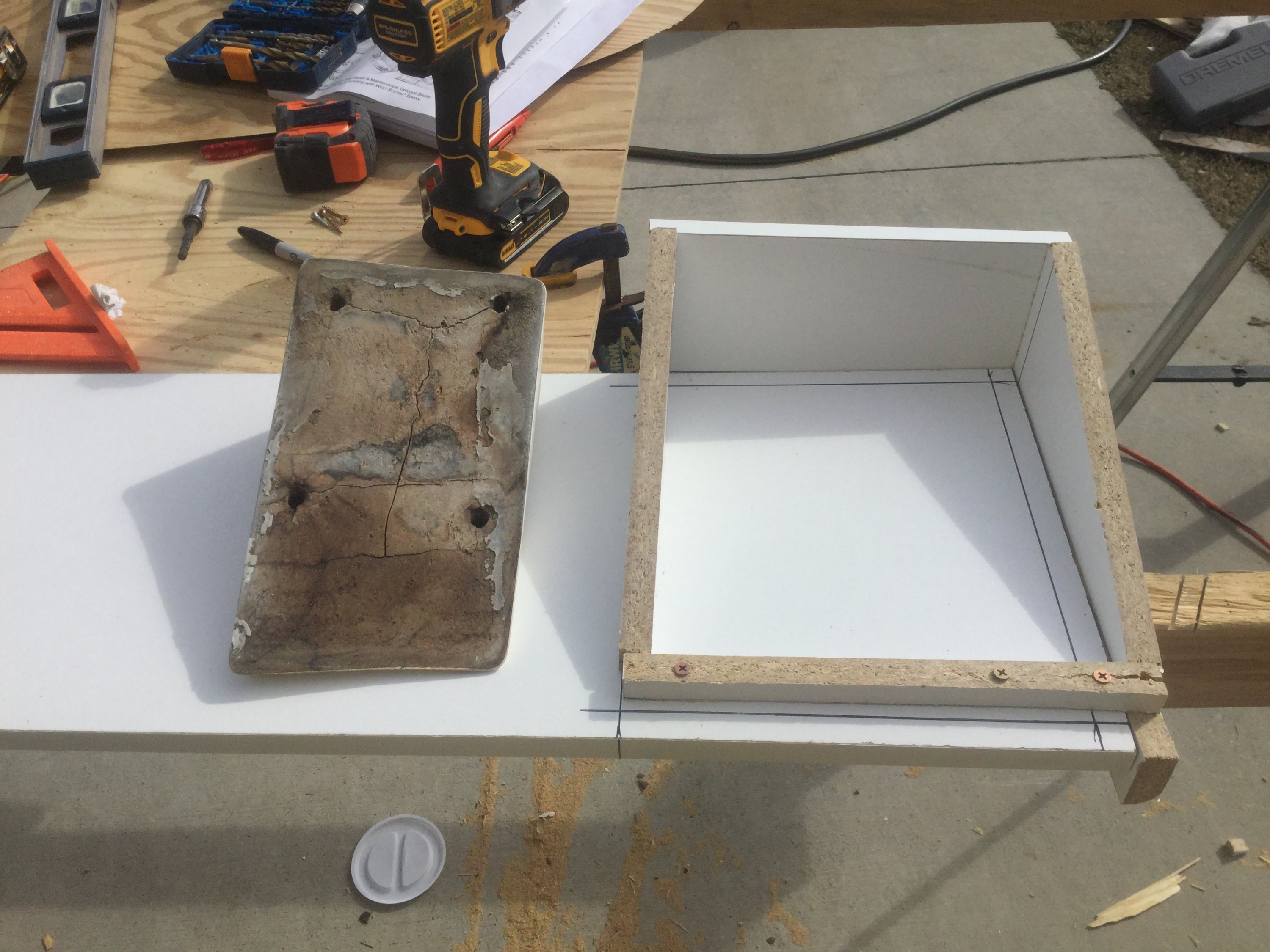

UPDATE

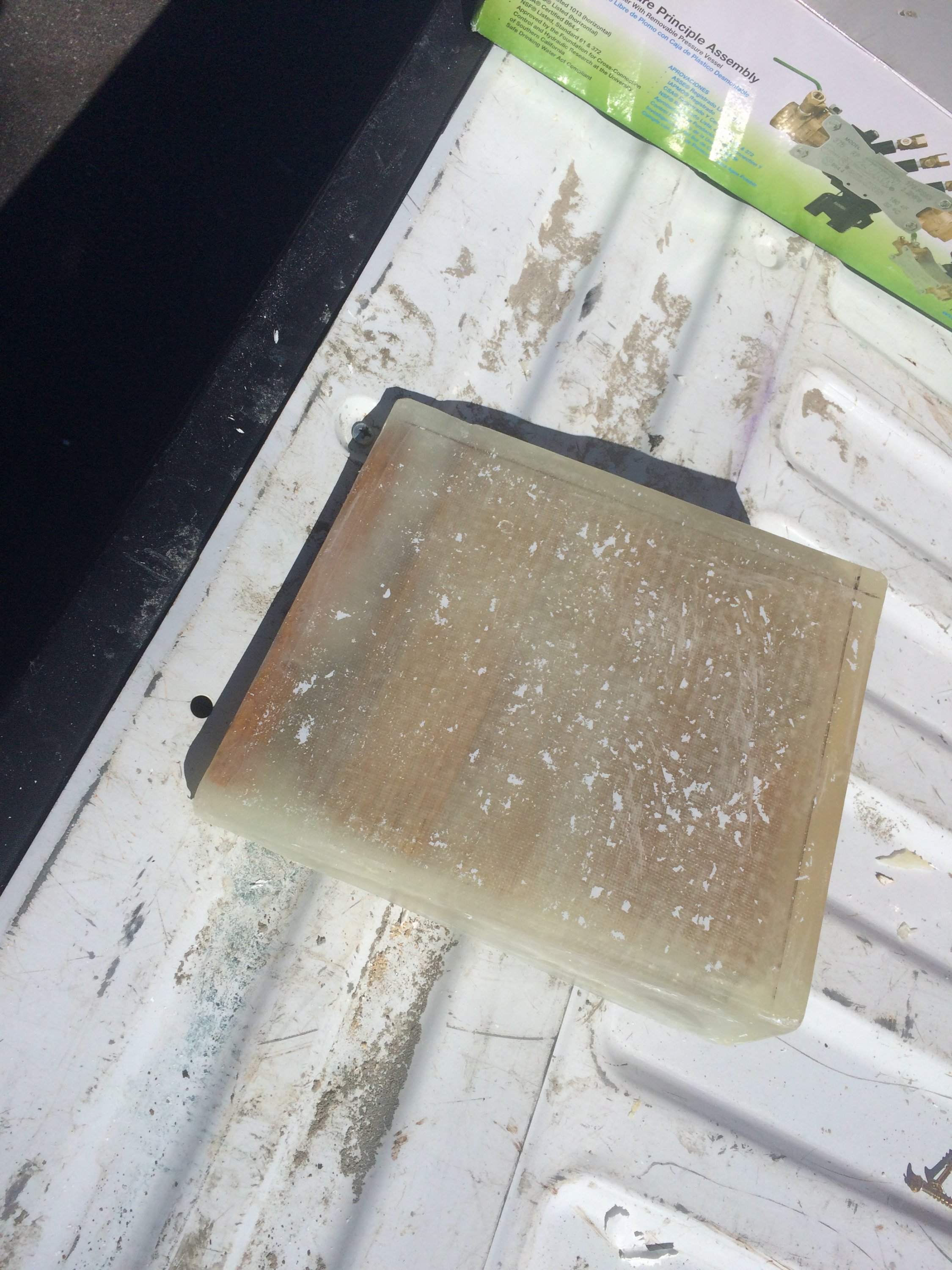

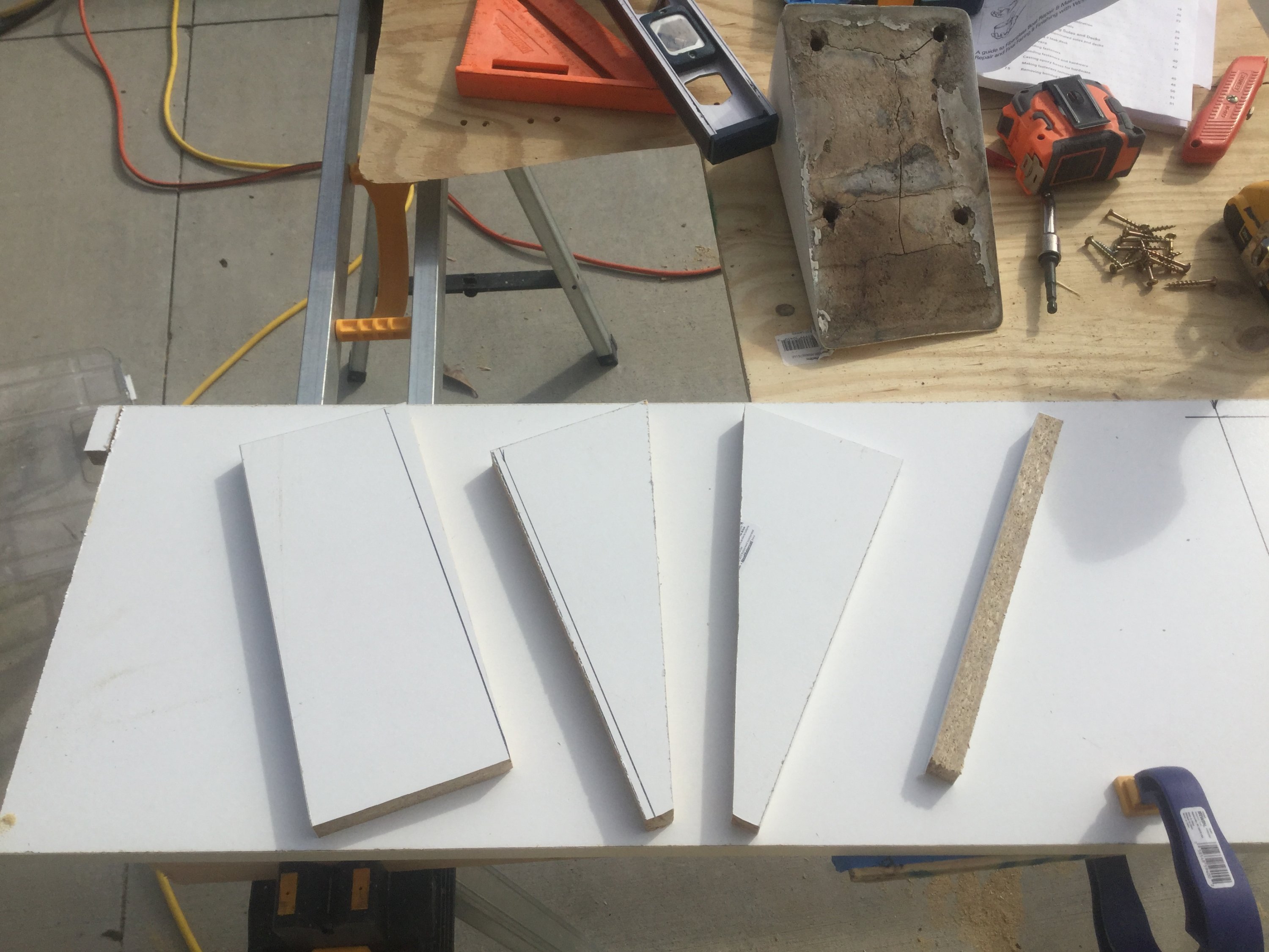

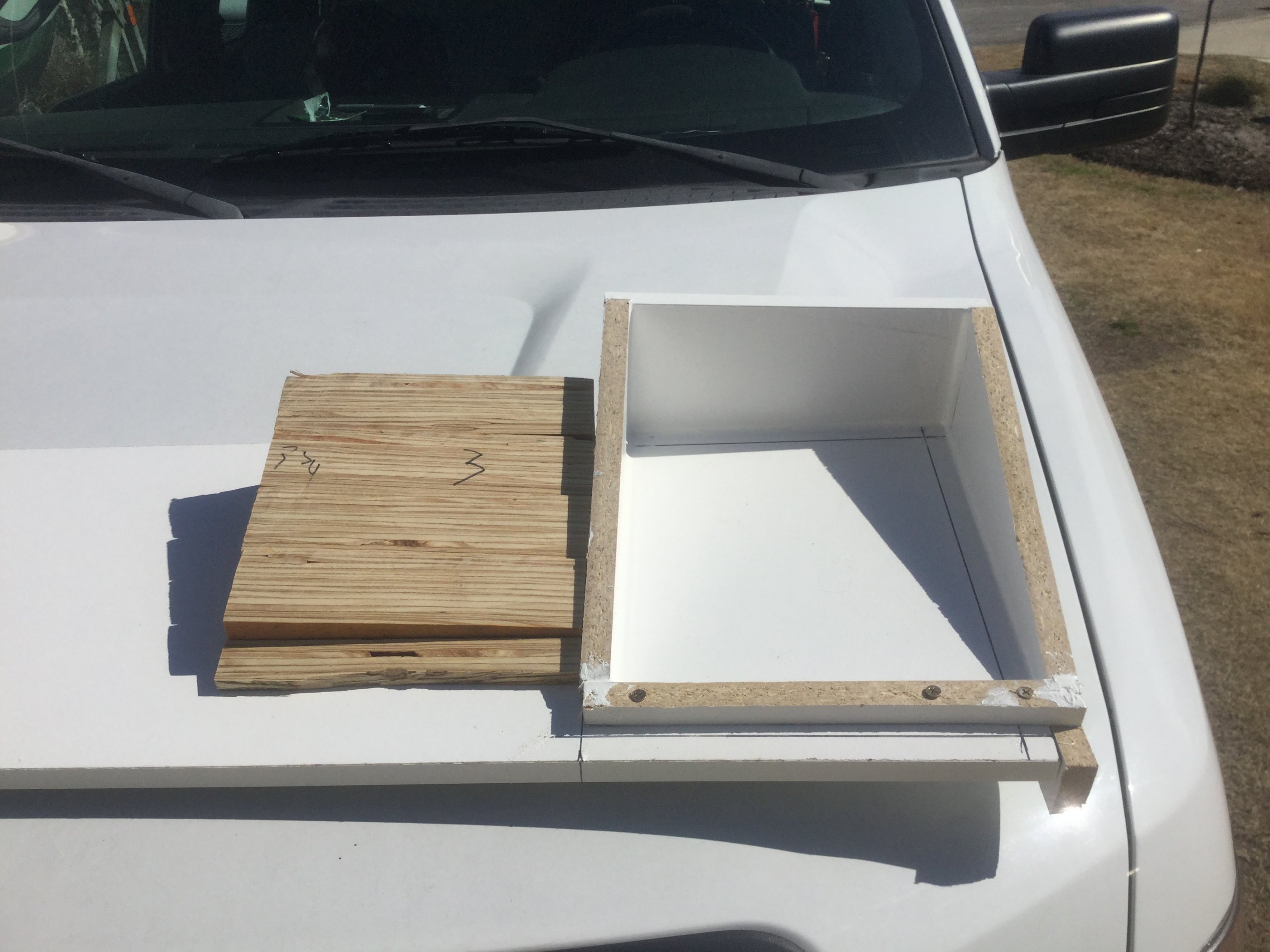

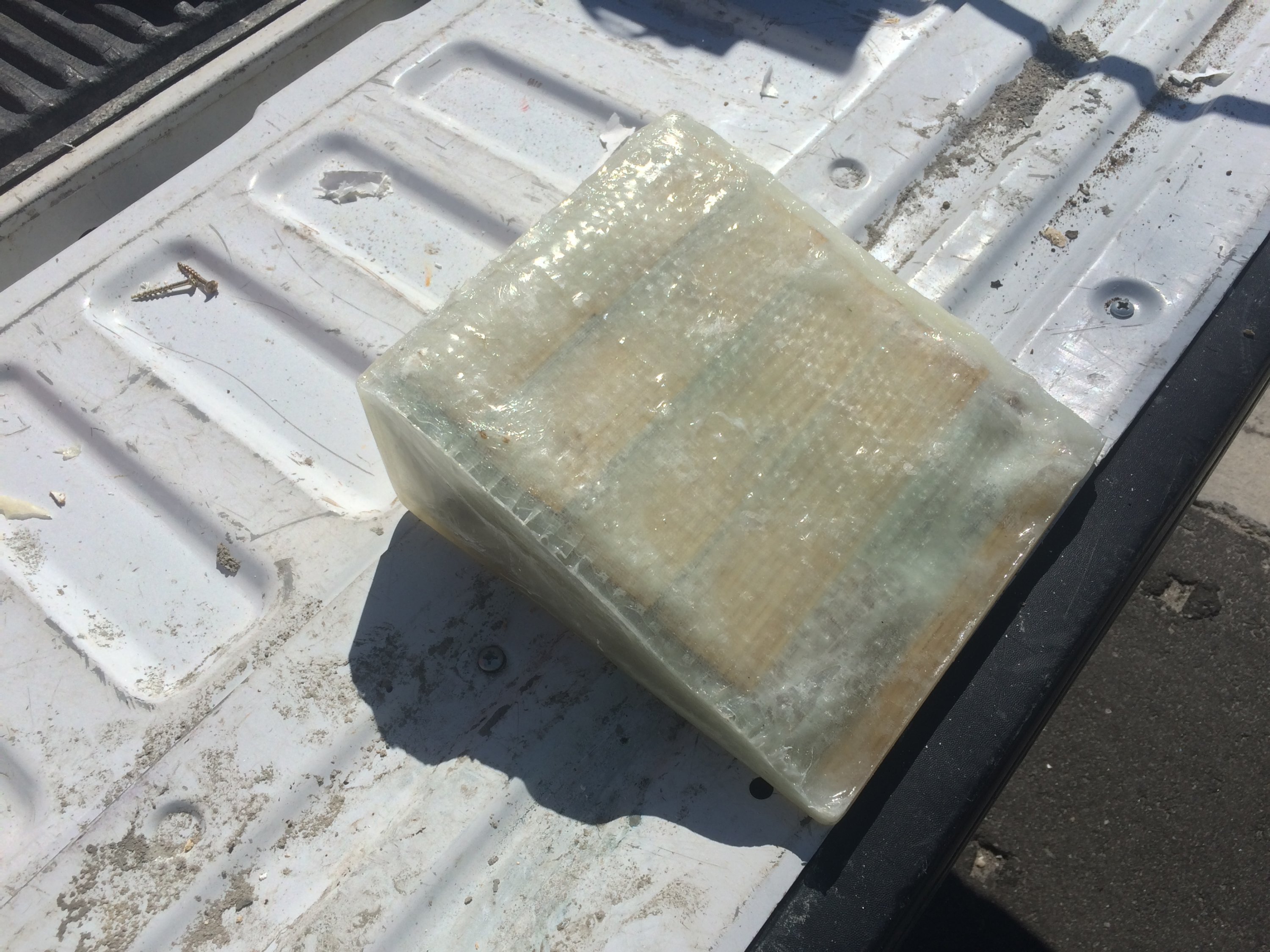

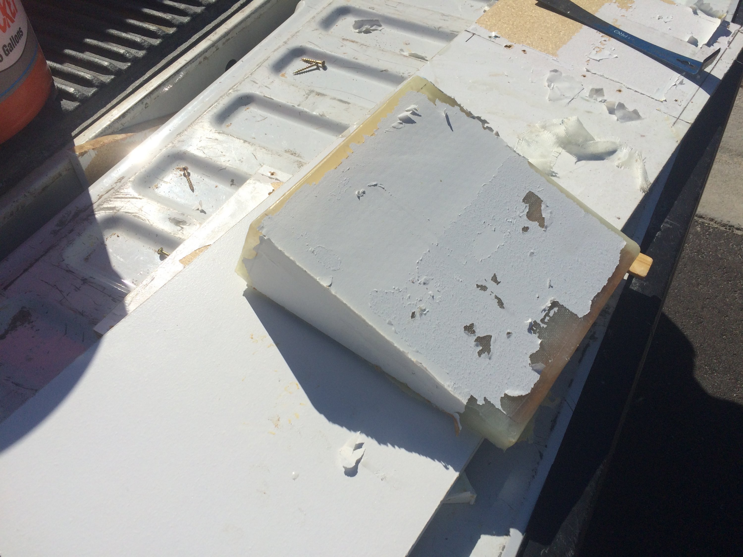

Started on the motor mount wedge. Had to make a wider one for the Garelick 71090 to fit into. (Made mine 9" wide by 10" tall, 4.25" deep) Used a melamine shelf from Home Depot and assembled, and used some LVL scraps as filler. Caulked the corners with some fast dry silicone and let it cure for about 12 hours. 4 coats of Carnabua wax seemed to be enough for a mild release.
Used 2 layers of woven glass, and epoxy and filled the mold. If I had to do it over again I would have made sure I had more filler, but ran out and only had enough to fill between the blocks. Once it was full to the top with epoxy I had trouble with air pockets, and and in the process of reworking the face that will sit against the boat. Also would have made the mold deeper than needed, and worked up a curve on both sides, rather than fight epoxy dripping out...Hindsight is always 20/20...or at least I would have cut the blocks smaller, in order to leave more room to grind out for the curve. I am now trying to build up the edges on the side after-the-fact....no bueno.
Good new is the mold came off relatively easy. The wax seemed to do the trick, although some of the melamine did end up sticking. I'm thinking this had more to do with the heat from curing than lack of wax, because it scraped off easy enough with a razor. More pics of this to come...

All that grinding is fun, isn't it? - did that twice, new panels, etc., on two boats. I used 1/4" ply..... set the first, then 2 and 3 for a 3/4" panel. Came out bomber....same for the king plank. I did screws through the hull for a tight fit. You might want to do a tap test to see if there are any voids in there. Had a small one - drilled two small holes top and bottom, then put thickened epoxy in the bottom one with a hypo, pushing till it came out the top,
