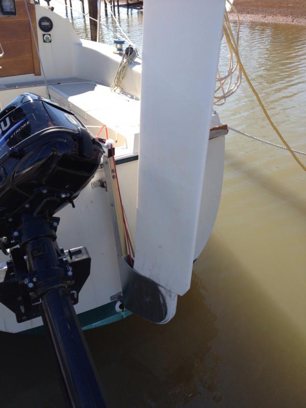

Had the same situation in my O-Day 22. Bought a rudder from IdaSailor and cured it completely.

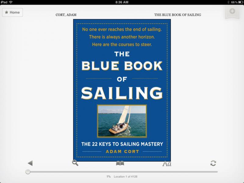

Same here. Love the rudder, but the reason you were pulling your tiller so hard was the sail trim was poor, or you were over-canvassed, or both.
I found this book helpful.
