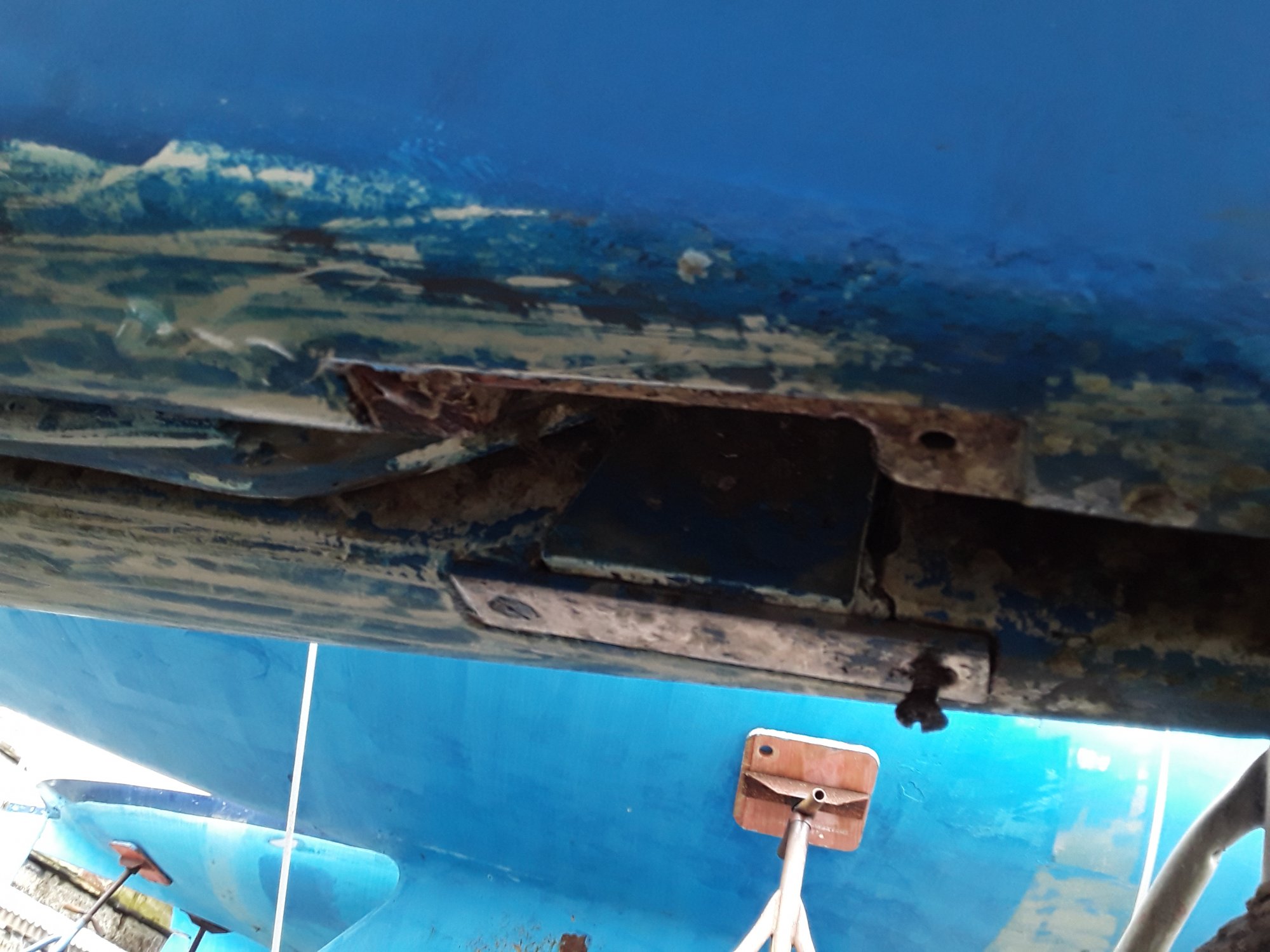

My keel has water trapped inside of it. I found that I had a missing screw on one of the plates- starboard side- that hold the centerboard axle wedges in place. The screw thread was stripped out. I removed the other screw on that side and alot of water came out. When I blow into the screw hole, I can hear there is a cavity in there. On the port side, both screws were in place, one came out easily and the other broke at the screw head. No water came out from that side. The fasteners are 1/4-20 SS flat heads, 2 in each plate. When I tried to dremel the broken screw head, the carbide bit would not penetrate it.

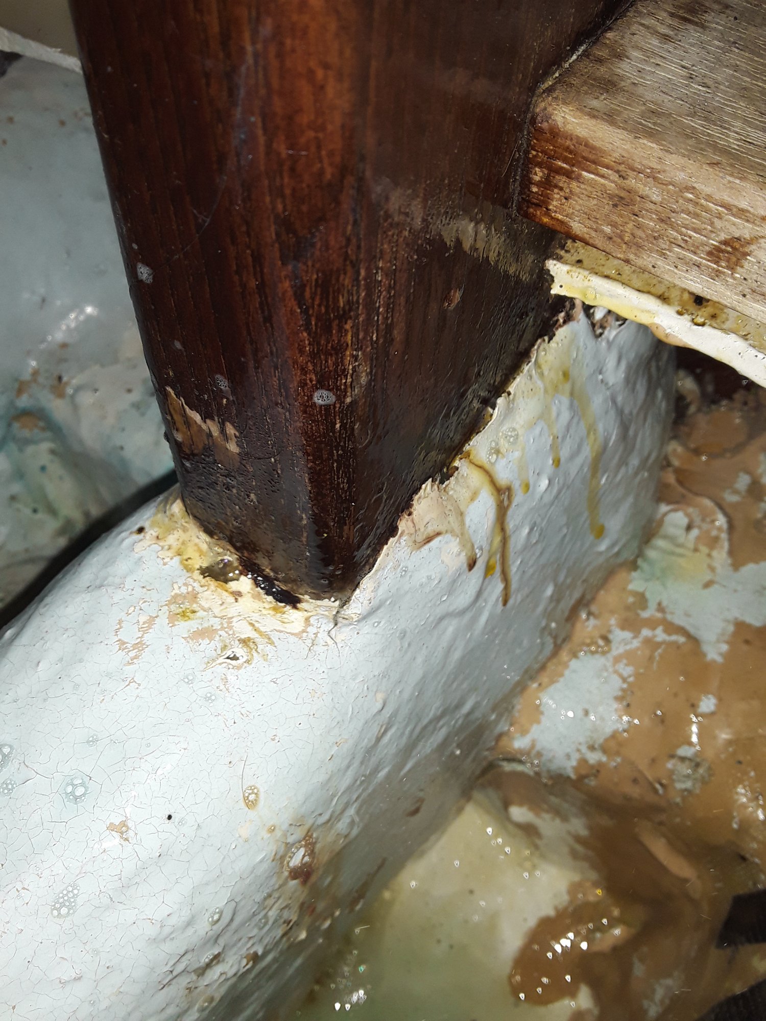

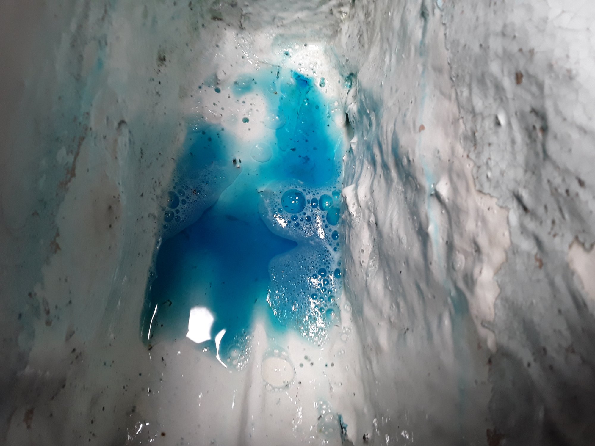

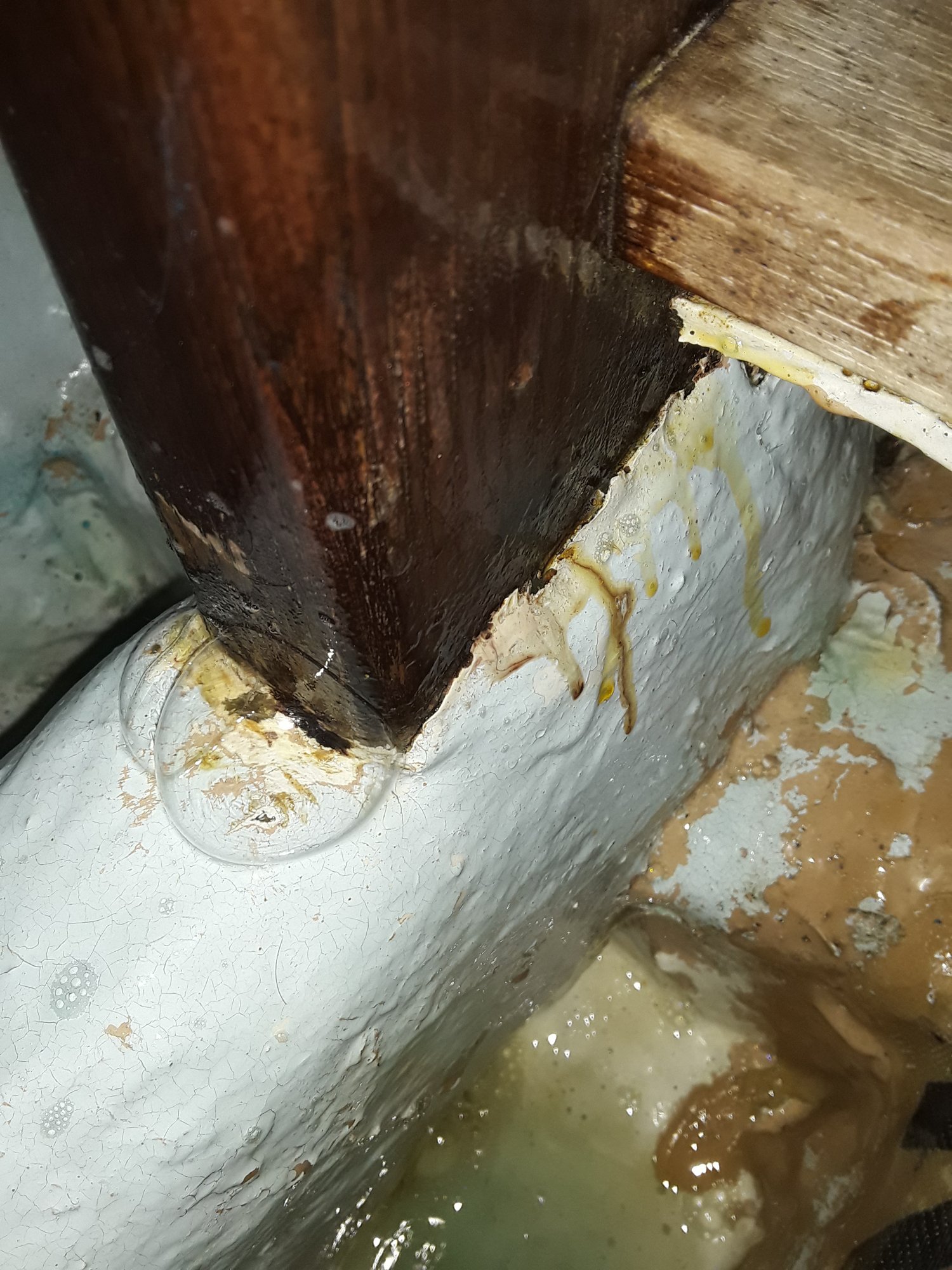

I used low air pressure to leak check the bilge. I cut the head off of a bolt and drilled a hole through it and screwed it into one of the centerboard plate holes and attached the air line to it. I found leaks in the corners of the trunk and around the mast post. I set up a fan and heater inside and fight the good fight of drying out a bilge for fiberglass repair. The cavity still has salt water dripping out of it. I believe the threaded inserts for the centerboard plates are brass. One is stripped and one has a broken screw in it. I tried to tap out the screw with a small tungsten rod, tapping in a circular motion but its stuck.

This pic shows the soap bubble better at the mast post. The other shows blue leak detector coming back out of the bilge from the air pressure, and soap bubbles in the corner of the centerboard trunk and bilge bottom.

I talked to Rudy at D&R Marine, he told be that the threads are in 1 x 1 brass plates glassed in. I brought a few end cutting dremel bits, I will try to cut the broken screw out and retap that hole and the stripped hole with 5/6-18 threads. I found the bits and 316 SS screws on mcmaster-carr.com. the bilge glasswork shouldn't be too hard to do as long as I can can keep it warm and dry in there. I have a fan and heater set up inside.

I have basically the same issue. I removed three of the machine screws without issue but the head of the fourth got messed up. I used a grinder to cut of the head so I could then slip the plate off. Then I used a 3/16" drill bit to drill around the bolt stub and pulled it with needle nosed pliers.
Next, in order to clean the hole I ran a large drill up in preparation for repairing the hole and insert. As I drilled suddenly it pushed through and water started to run out. It seems that the hole should only penetrate to a certain depth. The plate is about 2ft below the bottom of the bilge so I was surprised that water had penetrated down into the stub keel.
