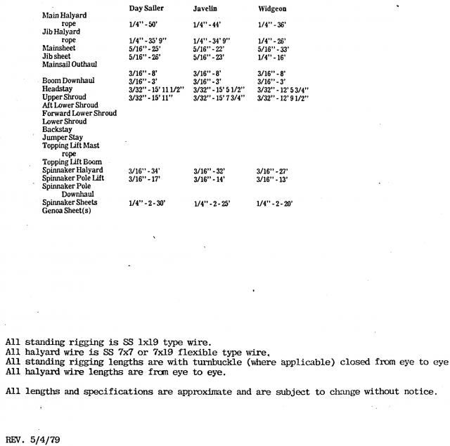

R. W. Landau posted an original O'Day 25 Rigging and Operation Manual for a 1979 Model. Can I get the actual PDF files emailed to me?
