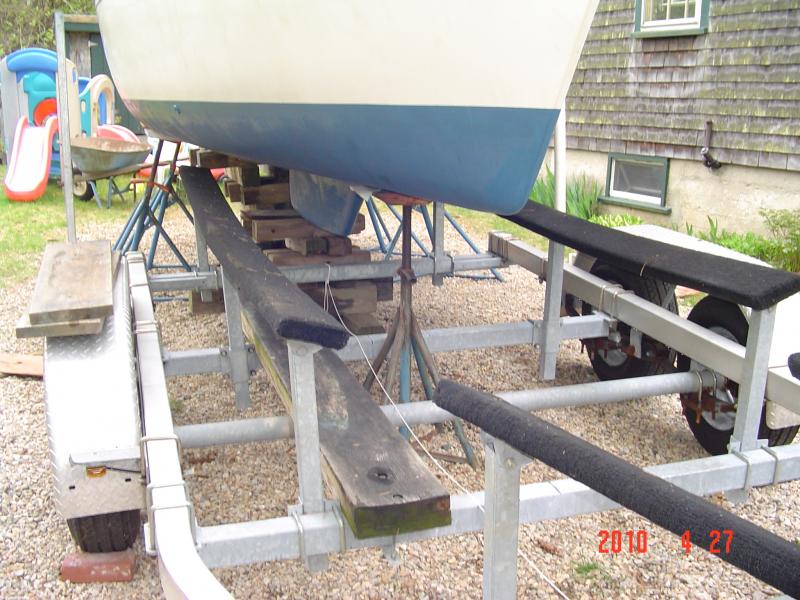

Also I would suggest that you prop the boat up as high as possible when you move to the next DIY yard. Rest the keel on blocks at least 30" high, more if possible, and don't put them under the centerboard slot. Just the front and back edges of the keel. Use tall popit (jacks) to stabilize the boat. This will allow you to unscrew the four screws that hold up the centerboard wedges and drop out the centerboard for inspection, and also clean and paint the centerboard slot. Also check, and if neccessary repair the centerboard while it's out of the boat. You can't do this on a trailer. Ernie

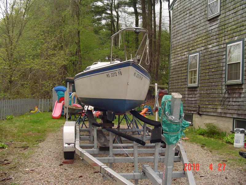

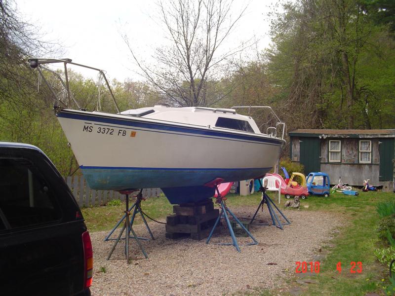

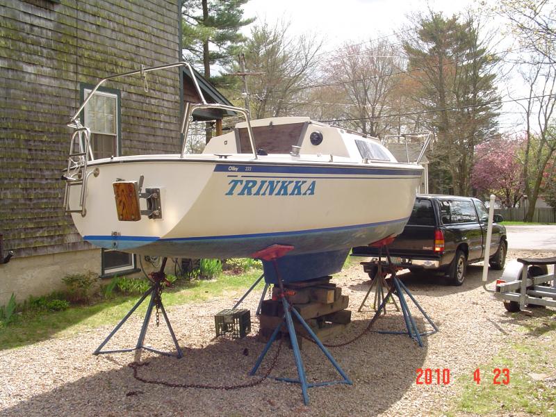

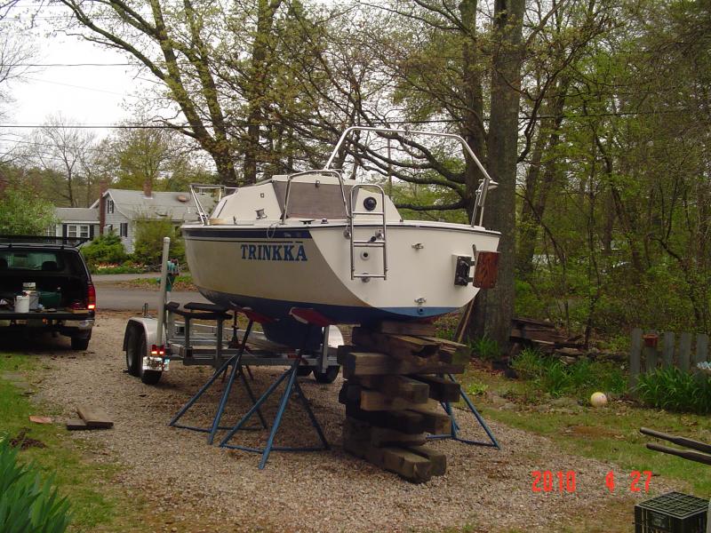

With the boat's weight sitting on keel blocks, you can move any one of the four sailboat stands not counting the stand under the bow, as long as the boat is level.
I sometimes remove the two front stands and leave the two rear stands to support the boat from side to side. If the whole length of the keel is shored up, you could also remove the stand under the bow as long as no one is allowed to walk on the boat. You can lower one of the rear stands and move it forward or aft a foot or two.
When I bottom paint my hull I generally paint the centerboard, the under side of the keel and whatever I can reach in the keel slot. Then I paint the keel.
My boat only goes about 2,200 lbs and I'm able to raise the hull with my sailboat stands. Stands aren't meant to do this but my Brownell's Boatyard SSB-3 sailboat stands can raise my boat. I've been doing it for years. I take extra precautions by shoring up under the stern and the bow close to the front of the keel with criss crossed 6"X6"X 3.5' wood blocks. This allows me to gain access to my centerboard and keel slot.
After the keel is bottom painted, I shore up under the keel after it's dried and remove the hull shoring and start painting the rest of the hull.
I place a 12"X12" square pieces of carpet on top of the stand poppets and when I need to relocate a stand to an area of the hull that is freshly painted but dry to the touch, I put a piece of wax paper between the rug on the poppet and the hull.
This SSB paint is very toxic and you need a full face respirator so you don't breath in the fumes. The paint stinks when you're applying it but after it's dry that smell goes away.
Years ago, I bought some bottom paint from Worst Marine and that stuff kept stinking even after the boat was in the water. It also required a prime coat that needed to be tacky in order for the bottom paint to adhere. I should have read the can before I bought that junk. What a horror show. I wound up wedging 2X4s and 2x6s under my gunwales to the ground and removing all four of my boat stands. I had the keel sitting on wood blocks 18" off the ground and I was able to get under the boat with a roller on the end of a long stick and get at the whole bottom of the hull,--except for the fact that I ran out of primer for that last area in the stern. I wound up bottom painting bare fiberglass in that area. Oddly enough though, the bottom paint never peeled.
In August of that year, I was sailing the bay and my boat was moving through the water very slow so I pulled into a cove, anchored, and took a dive under the hull to take a look see. There was a thick mat of soft marine growth on the bottom of my hull. I had to use a 10" wide putty knife to remove it and I took many dives back and forth until I was able to remove it all.
My boat sailed a lot faster after that and in September when I brought her home, I took her off the trailer and put her on stands and prepped the bottom for SSB ablative paint. I never had another problem like that again.
