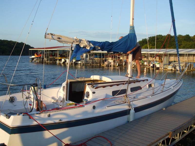

I'm new to sailing and I've found a 1982 O'day 25 swing keel for sale somewhat close to me. I haven't seen the boat in person yet, but the owner has sent pics. I'm trying to get educated on the boat before I go review it. There are a few things that look odd to me:
The boat has a Yanmar diesel inboard. Was this an option for a '82?
Also, I can see in the pic that the prop isn't a typical saildrive... this one has a slant shaft and a simple prop. Could this be an afterthought? Is it ok if it is an add-on and do seals present a problem?
Are inboard diesels even desirable, or is a 4 stroke outboard a better fit?
This boat has Edson wheel steering. Again, was this an option in '82, or is it likely to have been an add on?
Regarding the wheel steering; is this considered a good thing on this model? It seems like it would get in the way on the tight cock pit area.
I'm really open to any comments. I'm pretty ignorant and I want to make a good decision with this purchase.

Yes, the Yanmar diesel (probably a 1GM10) was an expensive option in the O'Day 25. The prop shaft and prop arrangement shown in photo you provided is not an afterthought, but the preferred original factory installation; cetainly preferred over the saildrive version. There is nothing "odd" in photos with respect to either prop shaft or the installation of the transom mounted rudder control for the Edson pedestal steering. While you do not see the control rod with keel hung rudders, there is no other manner in which to install for the transom hung rudder. While you do not see many 25' sailboats with wheel steering, this was quite possibly an option. Tiller steering does provide more room in cockpit when you are not sailing as you raise tiller to vertical position. However, many prefer wheel steering to long stints at the helm. There is absolutely no reason to go to expense (and potential problems) of folding prop; it is unlikely you are going to be racing the boat and any drag will prove to be insignificant. Bottom line, you are cleaerly better off with a Yanmar diesel than any 4-stroke outboard, but hire a good marine surveyor prior to purchase! Does current owner have service records; was engine ever rebuilt. Do not be overly concerned with age as a well maintained diesel will last longer than a new outboard. You also mentioned owner has an AC unit for the boat and expressed concern with taking up storage space. The AC unit is undoubtedly portable that is placed in opening for sliding hatch on coachroof. When not in use, I suspect you could store unit in port quarterberth or V-berth (better yet, unles you plan to spend many hot summer evenings aboard, sell it on eBay and install a solar powered cabin fan). As someone else mentioned, in addition to condition of the Yanmar diesel (simple exterior appearance can say a lot about care of an engine!) ou want to pay particular attention tro condition of bulkhead where bolts secure chainplates for shrouds. Leaking chainplates were a problem on aged O'Days and water stained bulkheads should provide further inspection by professional. GOOD LUCK! By the way, Rudy Nickerson at D&R Marine (check website) should be able to advise you if Edson wheel steering was an option on the O'Day 25.

PS: The wheel on that 25 was definitely added later, it appears to be an EDSON RLA (Remote Linear Actuator) System and those were introduced in around 1986 or 1987 by EDSON. They were sold as an aftermarket upgrade for boats in the 20' to 30' range by Edson, interestingly enough Edson actually developed the RLA to answer the request from O'DAY for an easy to install wheel system to be installed in the 272 LE. Also used by PEARSON for their PEARSON 27 that was very similar to the 272.

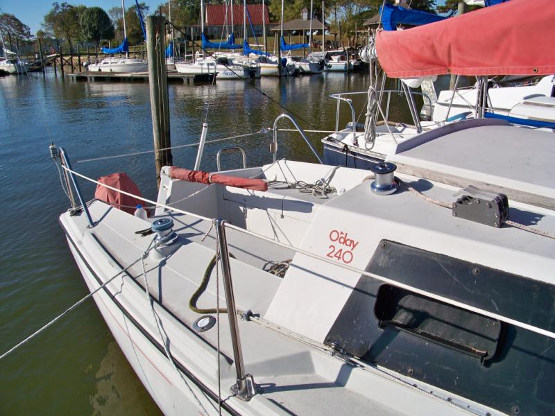

I have some pix of a 240 I took at my club. A strange but good looking craft.
