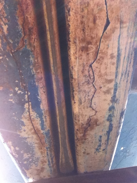

I've always had a persistent leaks in the bilge but could only guess as to the cause. The yard pulled the boat today and I had them blast the bottom of the keel to get the zebra mussels off. Along with getting rid of the mussels 30 years of bottom paint came off exposing large cracks along the bottom of the keel (picture attached). Mystery solved. Now the hard part. How to fix? The keel rests on 4 wood cross members severely limiting access. Do I do a caulk job every spring while the boat's in the sling before launch?

Block it up at the forward end and aft end of the keel, drop the board and then start grinding out the cracks on the bottom. If you do it now most of the moisture inside might dry over the winter. The extended forecast is for a mild spring. I wouldn't wait to start until next spring. You won't have to worry about filling it back in until then anyhow.

How could the water make it from there to the bilge? Is your keel hollow? I have an oday 26 and the distance from the outside bottom of the keel to the inside bottom of the bilge seems to be several inches. Is a 25 much different?

I'm assuming the water migrates up between the lead & the fiberglass into the bilge. It's not a bolt on keel.

Rbone has it right. In the spring, pack the ground out beveled openings with epoxy saturated glass matting, let set up and grind off to surface level. Then sand down surrounding areas and cover over with at least a couple layers of fiberglass woven material. Sand down and then epoxy paint it. You might want to explore pouring in resin up in the bilge area to reseal glass to lead? Bottom paint should complete the job!

If the keel is a solid lead casting, for water to migrate up into the bilge it must be seeping up between the 'glass skin and the casting. On the outside of the keel or inside the c/b slot. Are you certain the leaks in the bilge are coming from the cracks on the bottom of the keel? Is the keel casting held in place by the fiberglass? Maybe there are tiny cracks up near the hull. Or the water is coming from somewhere else.

I always suspected the water was coming in through cracks somewhere down there. Never thought they'd be so large. 3 days after haul out the cracks are still dripping.

The Keel/Centerboard O'DAYS with the keels molded as part of the hull (basically, all K/CB models except the 1971-75 O'DAY 23) have lead "ingots" placed inside the keel cavity and then covered with resin and glass cloth. I would think that eventually any small crack could extend through that resin/glass matrix due to the freeze/thaw process each Winter of any water that seeped into the cracks.
Quoted from Robbie Pierce, VP of O'DAY from the early-mid 1970's: "Envelope “ keels. Boat hull & keel is one piece molded. While boat is still in the mold, pre-cast lead ingots (4 piece of lead) are placed in the keel void; glassed in place with resin; then the completed unit is extracted from the mold. An efficient, no maintenance way to attach keels."

That adds a lot to the conversation. It's easier to see how water could be forced up through those cracks into the bilge

It also reinforces my suggestion to let resin seep down from the bilges to rebond, and do so even before sealing the cracks! Chief
