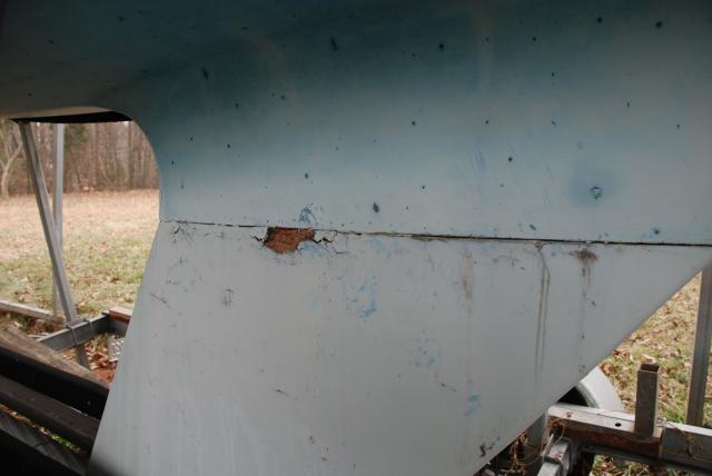

Keel on the K/CB model is molded as part of the hull, the keel on the deep-keel (fin-keel) model is bolted on at the bottom of a small "stub-keel", I've attached a picture showing the seam between keel and stub.
