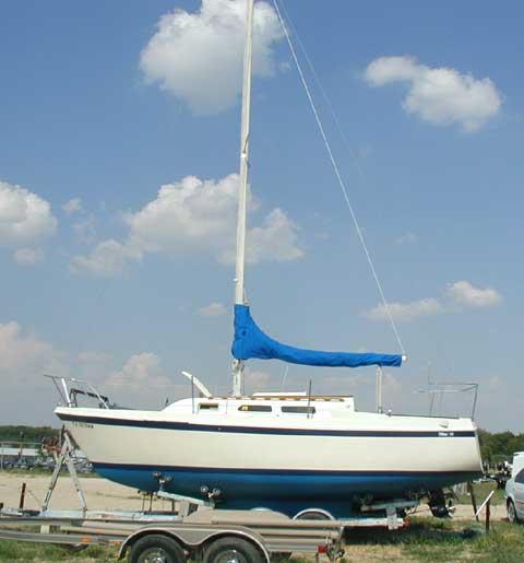

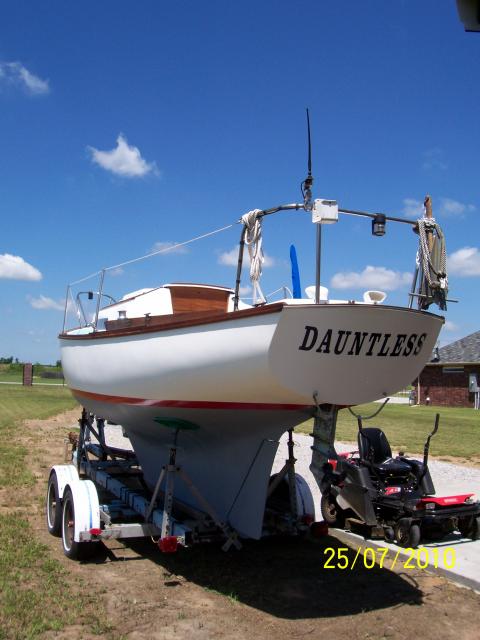

Is it an outboard motor or is it a gas motor mounted to the hull with an outdrive? The capedory I looked at just has an outboard mounted in a compartment at the back of the boat and the motor just sticks down through the hull. It has a hatch over it with ventilation. I guess I will have to drive down and see the ODay to understand what it is. I will try and attach a picture. I am between this Oday 25 and the capedory 25 The capedory is a quality boat but seems a little cramped. It is a fixed keel and I am a little leary of loading and unloading. I have been onboard the capedory and suppose I will be making the 4 hr drive to see the ODay in order to not have any regrets. I just sold a venture newport 23 and am looking to move up a little. I am fairly new to the sailing world and afraid it is getting under my skin

thanks for you alls input, I am glad I found this site this afternoon. Can you see the outdrive hanging down from the oday? Is that on the oday or a boat parked on the other side of it? I looks rather large and similiar to a mercruiser.

What I see plainly in the photo is the lower unit of a powerboat's outboard or outdrive behind the 25. The OMC ZEPHYR Saildrives were located further forward and access was through the cockpit sail locker (a tight squeeze I'll admit!). I'm not sure that the access to the later 7.5hp Diesel in the 25/26 was any bettter.

The CAPE DORY Typhoon Senior (22'), the original CD 25 and the later 26 all had outboards located in "inboard" wells located just forward of the transom at the aft end of the cockpit (actually under the afterdeck). None were originally designed to allow tilting the outboard while not under power, so you were dragging the lower unit (and normally a 3-blade prop) under sail. I personally like the look of these wells as oposed to a bracket on the transom, however... you can't beat the ability to tilt a bracket mounted OB out of the water while sailing or while moored.

thanks for the clarification, that outdrive had me scratching my head. Couldnt have photoshopped it any better!

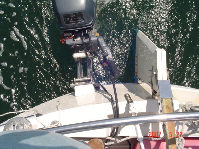

It might be easier to just keep your eye out for a later model O'Day 25 k/c with an outboard on the transom than to try and convert a saildrive over. I say a later model because earlier model O'Day 25s have the centerboard pendant line mounted on the table pedestal down below via a winch and wire cable. They're still nice boats and they move fast through the water. I sailed one and I know this for a fact, but the later models have the c/b pendent line (braid line) accessible right in the cockpit.
Another point that needs to be taken is the outboard model sloop will have a special block on the transom with the outboard motor bracket attached to it. The bracket may or may not be a heavy duty bracket built for four stroke outboards, but the transom itself should be strong enough structurally for outboard power. The idea of the block is to conform to the curvature of the stern and provide the outboard motor bracket the needed angle for the outboard. On my boat, I'm able to tilt my outboard up without messing with the transom bracket. I leave my bracket at a certain height, and that's where it stays. So the block provides the distance between my transom to be able to tilt my two stroke Johnson 8 hp long shaft outboard up. I don't that think this would be the case if I ever need to switch over to a four stroke engine. Also, I would need to go to a more heavy duty transom bracket because the four strokes are not only heavier but the engine torque is higher.
Here's a picture of a block on the transom of my friend's 86 O'Day 272. He has a four stroke engine with a heavy duty bracket.
