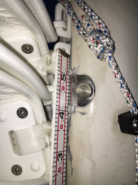

Here is a photo of the mast gate on my O'day 25. D&R Marine list a "Sail Stop" which is probably another name for it but they don't show a photo to be sure. Probably worth a phone call, don't email them if you want a fast supply.

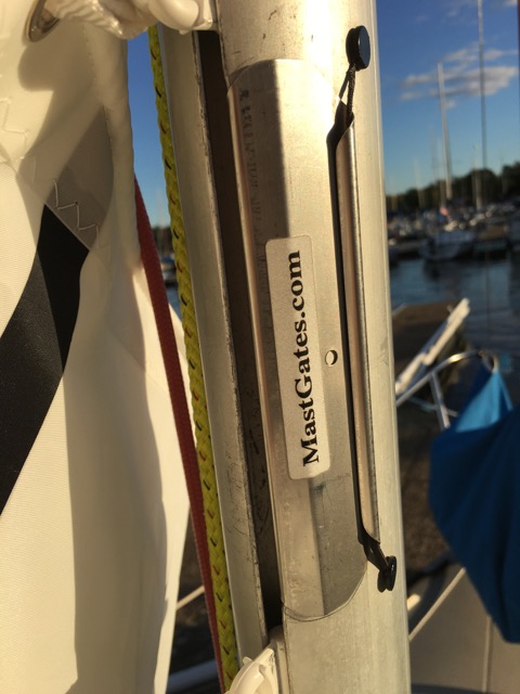

Here is a pic of my Tom Luque Mast gate installed. Note how it is just a smidge wider than the slot. It was popping open and allowing slugs out sometimes. I think I ground out the overlap of the gate just a wee bit too much. I exchanged emails with Tom, and he suggested pinching the overlap corners of the gate closed just a little bit, which I was able to do with just my fingers - didn't need pliers. So far this season it has been problem free since I tweaked it. I was thinking I might have to purchase a new one that was 1/4" longer, but so far I am just fine.
