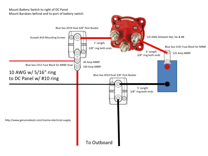

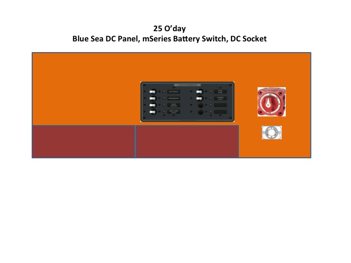

Here is the placement drawing I came up with and the schematic. The new panel will use the existing panel cutout which will be made larger for the 8 breaker panel.
I installed the battery switch and measured for pre made cables. Need to order the custom cables, busbars and terminal fuse blocks.
Thought I would pass it by you guys just to CMA.
