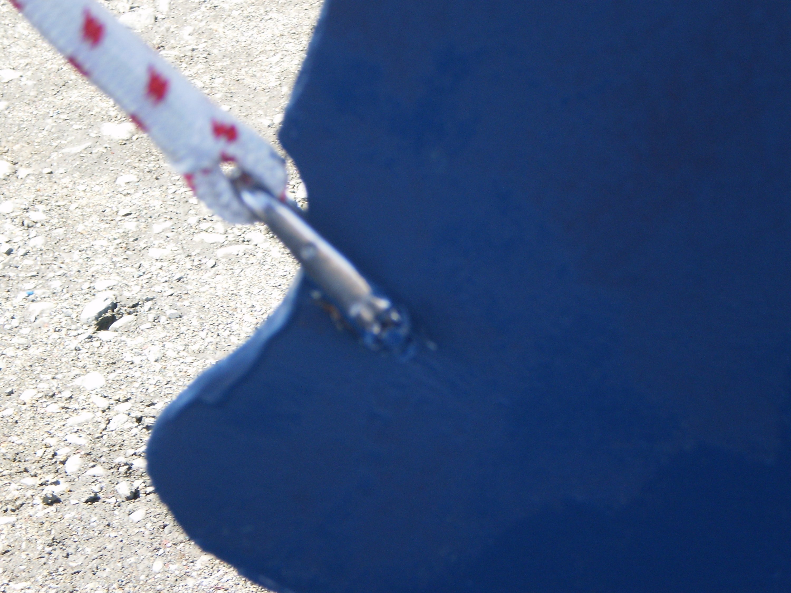

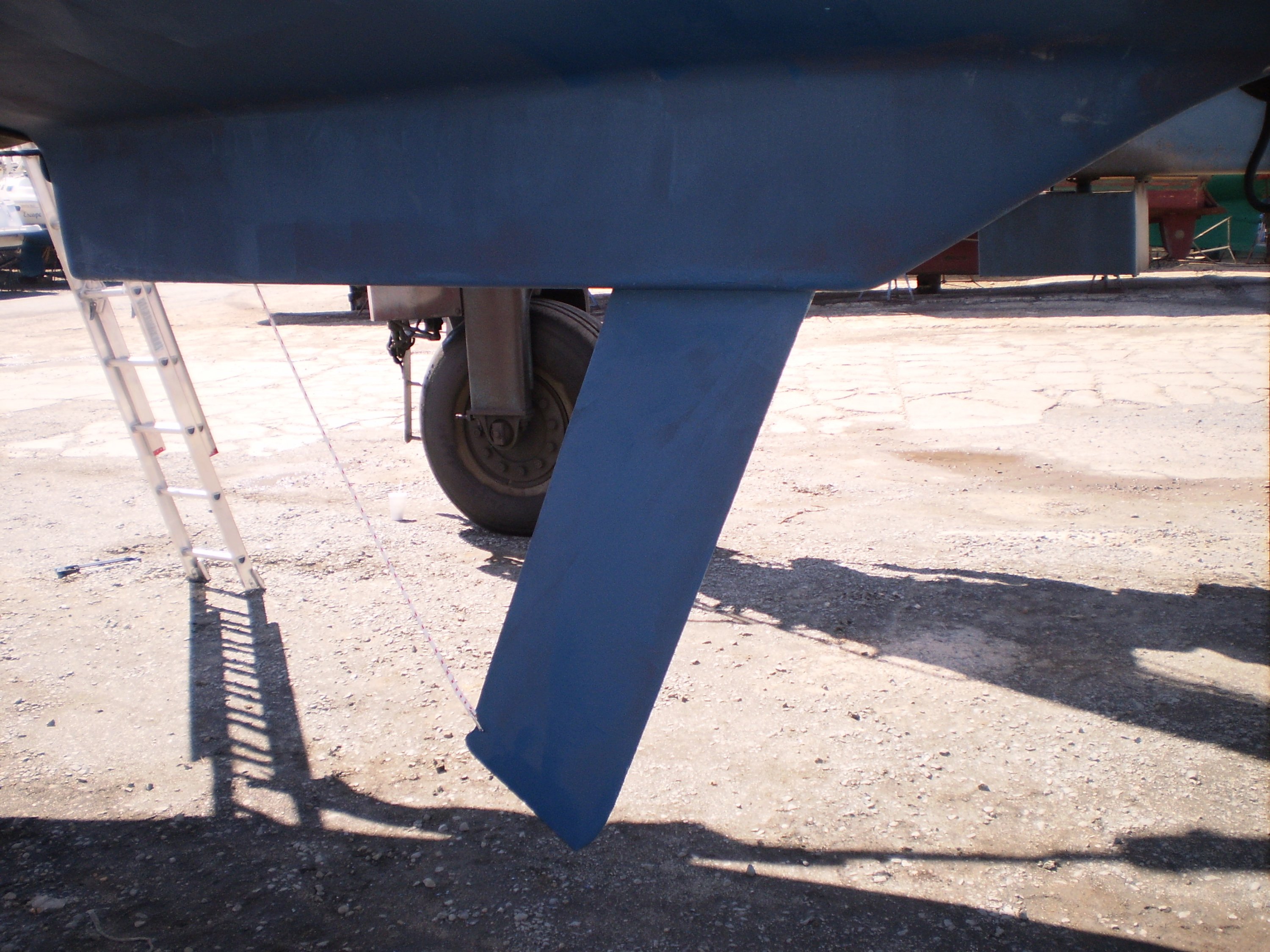

My first choice would be to leave the centerboard up for the remainder of the season. To replace the pendant I would do the following: 1) order a new pendant from D and R Marine so you know you have one that will fit 2) remove the fitting from the cockpit where the pendant enters 3) stitch/tape/affix a work line to the bitter end of the old pendant 4) lower the board and detach the old pendant from the board 5) continued
May 8, 2011
189
ODay 25 Cambridge
5) bring the work line up to the cockpit and stitch/tape/affix the work line to the bitter end of the new pendant 6) pull the work line and new pendant up thru the cockpit 7) attach shackle to centerboard and install cockpit fitting.

Thank you Brian and SV. I have ordered a new pendant and will be taking the boat out next
Wed. I am hoping after a sail on Sunday to raise the centerboard so the boat can be taken ashore....

I wouldntlower the centerboard until you get the boat out and replace it.

I agree with the others. Get a new one and replace it soonest and don't touch it until you do.
If the pendant is fraying that quickly and badly I wouldn't even try sailing with it unless you can have it hauled with the board down as the line may part just from the added motion of sailing.
Not worth the chance of damaging the board trying to haul the boat with the CB in the down position in my opinion.
