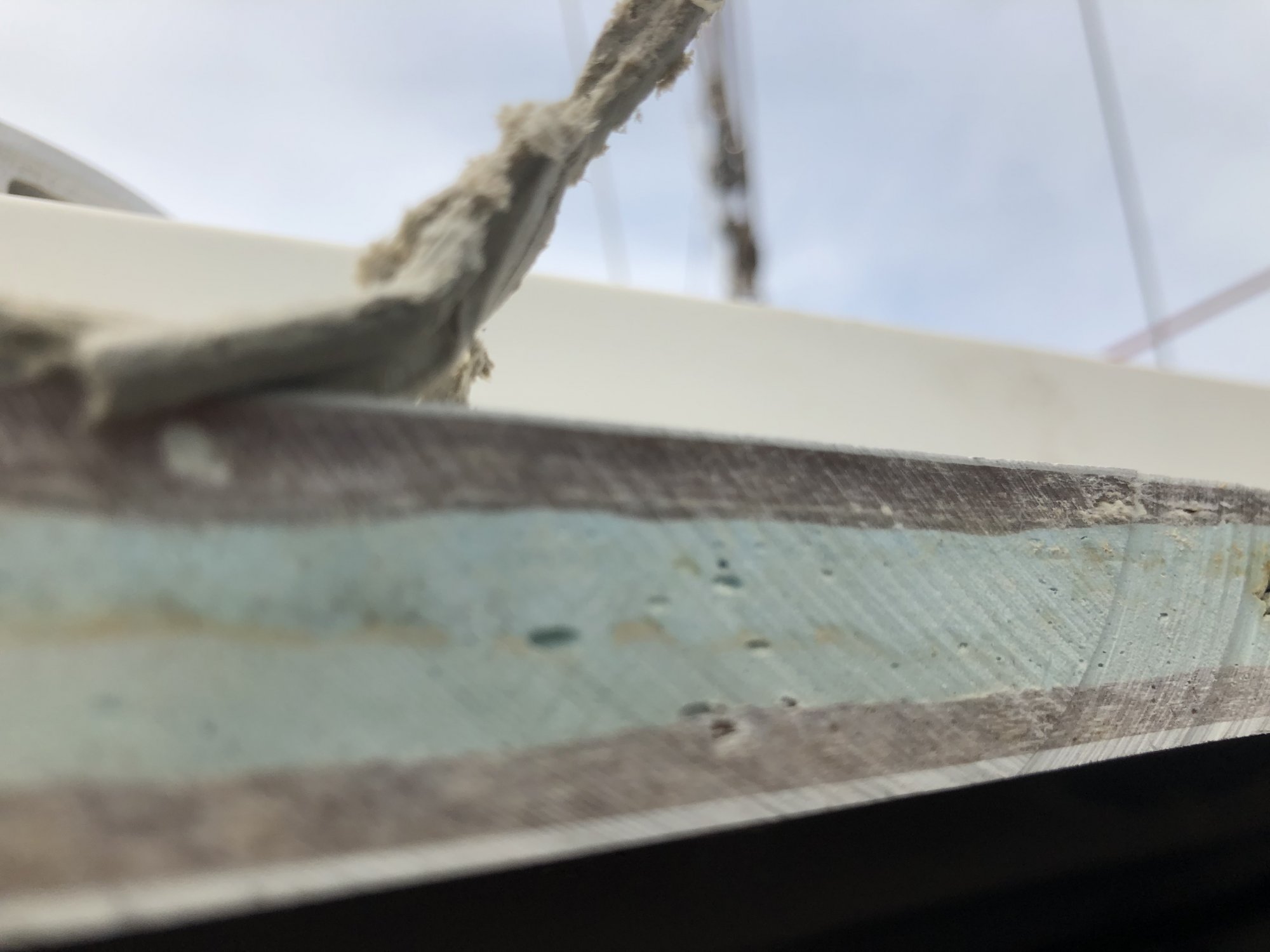

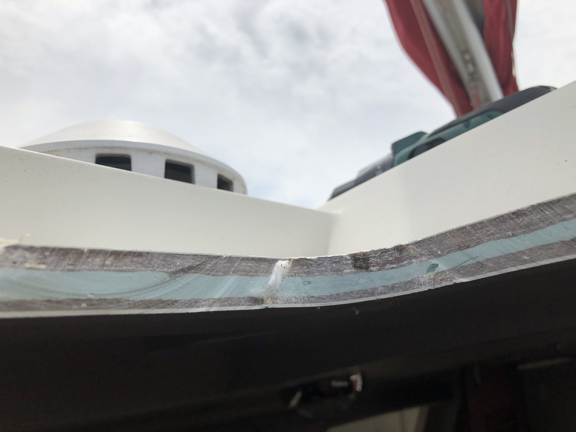

Jan 7, 2011
6,017
Oday 322 East Chicago, IN
I guess the "2" series changed that - mine is all balsa with plywood under the coaming winches, solid at the edges, no foam that I've found.
Here is what I found when I removed my main cabin hatch…
I don’t know how far it extends.
And I think I got wood shavings when I drilled holes for up-sized cabin top winches.
Greg
Likes: tcbailey67
