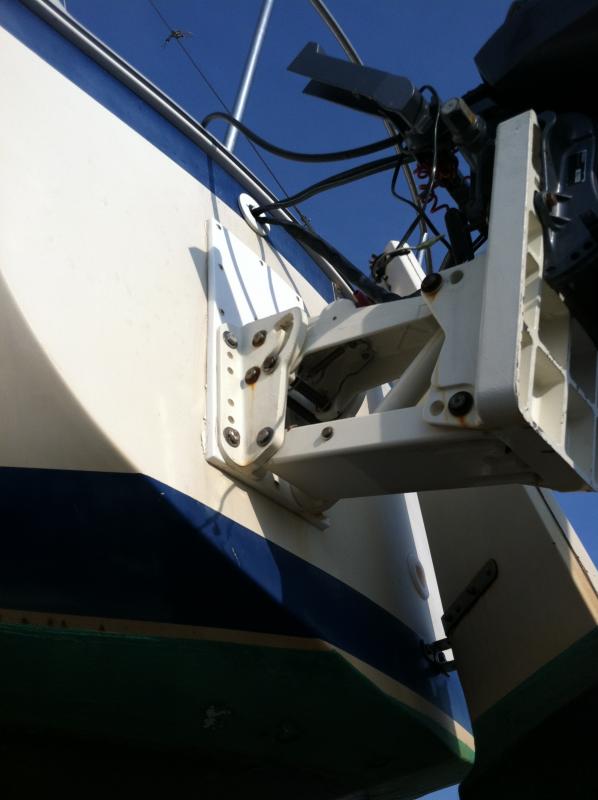

The bracket on my 25 is bolted flat to the transom with a 3/8 or so thick spacer. The spacer looks like a sheet of nylon. Doesn't look like starboard but could be. I always wondered if there was a "hump" that was cut off and covered by the spacer. The bracket is bolted through the transom and is backed by epoxied plywood on the inside.
I saw another 25 done this way in the marina and it had the same type hydraulic assist lift on it so I guessed maybe they were installed by the same yard.
The hydraulic assist lift bracket is nice. Not sure what name the bracket is.
I would call Garelick about what mount to use. When looking for a mount for my 4 Stroke 4HP OB to put on my 17' boat, they advised a certain 2 stroke mount which would carry the weight.

AWalker, Thanks for identifying my bracket. Never heard of OMC. Works well.
