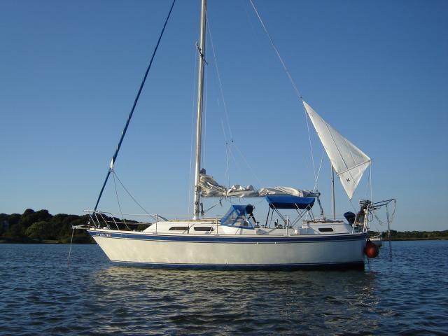

My 32 does the side to side dance in high wind (+15) while at anchor and what works the best is an anchor sail

I think the riding sail will solve part of your problem with the exception of radical wind or current changes during the night. In this case, I would put out two anchors Bahamian moor style.
Years ago when we sailed over to Martha's Vineyard we would always stop in at Vineyard Haven and spend a few days anchored inside the jetty over near the beach between the ferry dock and the town dock. The harbormaster Don Simmonds at that time would always let us anchor our boat in this area provided that we use two anchors Bahamian Moor style as the wind in the harbor changes quite often in there.
I think that the riding sail is an excellent idea because if your boat should slip the anchor at night, I think that you're going to know it pretty quick. The boat will drift sideways with the water banging up against the hull making a racket. You'll not only hear it but you'll feel it, but with the second anchor out, the boat will now be secure and held in place by that anchor.
