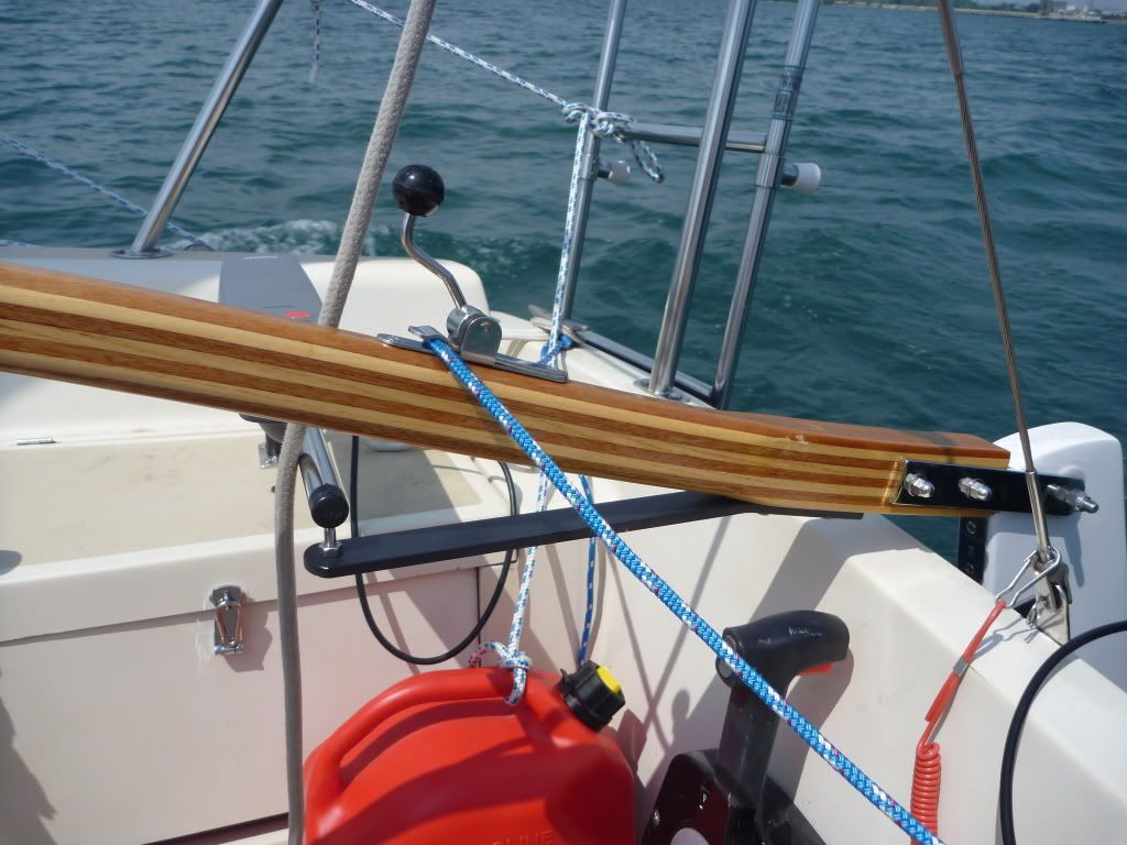

I know my O'Day is the 23, but I installed a curved up tiller, (from D&R), and I am so happy with it.
No more banging it on the knee,s and it is much much easier to move around under it. I love the fact also that it is a higher hold, makes sailing much easier.
The SS rudder bracket that holds the tiller had chipped the fiber glass away where it rests on a notch in the rudder case. I fixed this by getting a small SS strap from West Marine, cut the end square and bent it over about 1/4", drilled another hole and screwed it on the rudder. This made a nice solid stop and also added a bit of extra height to the tiller. I would not change a thing.....hope this helps in your decision.
Here's a couple of pics...

Thanks sdstef, do you wish your tiller was any higher? I am looking at one listed for Day 26 that has 9.75 rise. Wondering if that is too much.

I would actually like a little more rise to it maybe two or three inches, but not 9 to 10. Especially for shorter people taking the helm.
