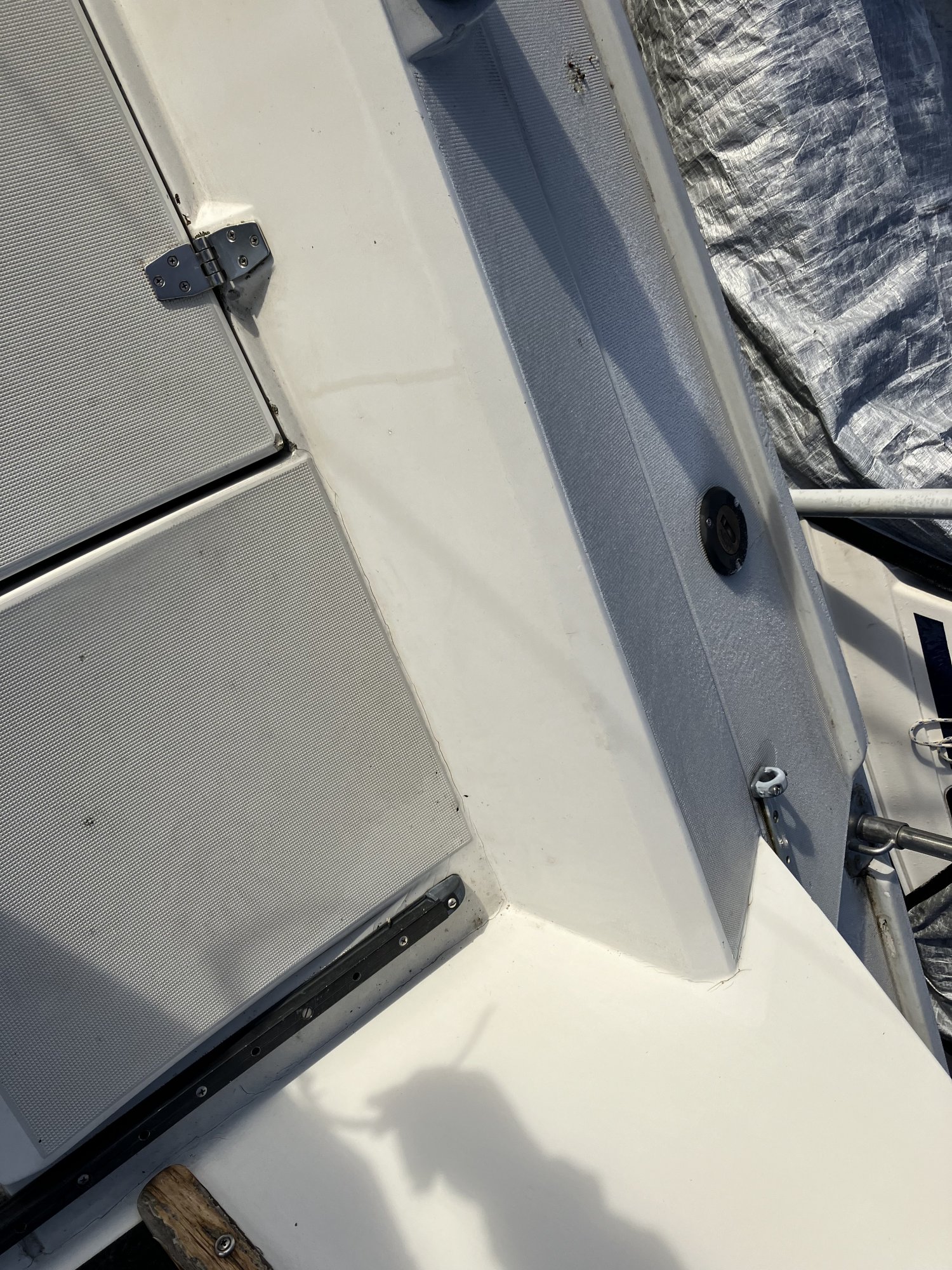

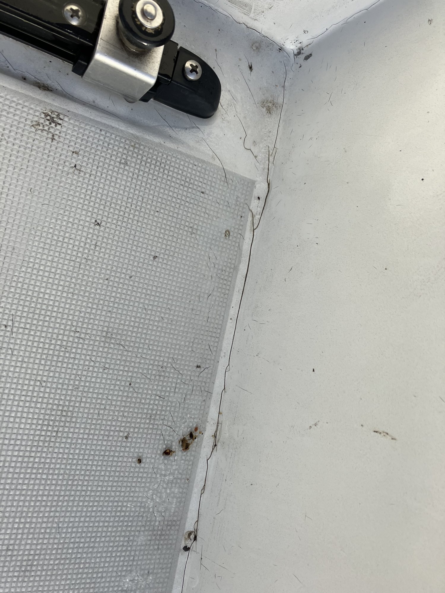

New to the forum. Got my eye on a 240 offered for sale. Lots of (hopefully) minor issues you’d expect in a 30+ year old boat. Two questions:
First, fairly specific: what are these cracks at the back of pretty much the entire cockpit bench on both sides (pics attached)? Are they concerning, or cosmetic?

Minor stress cracks are not surprising on an old boat. The bigger concern is what you can’t see. If water/moisture has been seeping into the cracks, it can rot the core material which I assume in balsa Or plywood. If it also froze during cold weather, you can use your imagination. And if the current/previous owner was as lax with maintenance on other stuff as he was with taking care of this, who knows what issues exist.
If there isn’t any underlying damage, it’s pretty simple to fill and fair the crack.
There are lots of tutorials on the internet on how to assess moisture damage
Likes: Timm R Oday25
14,134
Cracks like the ones in the photo are pretty common in older boats. There are a few reasons, most of which are pretty benign. First and foremost is the nature of gelcoat, it is brittle and needs to be well supported or it will crack. The second is the nature of fibreglass, when being laid up it tends to pull away from tight corners into a more gradual curve. This leaves a small void between the gelcoat and the glass supporting it and it cracks.
In some constructions the corners of flat sections, like seats and bridge decks the edges at the joint are more flexible than the middle of the flat surface. Over time the flexing causes the gelcoat to crack. This is most likely to happen if the seat is cored because the coring ends before the corner of the horizontal and vertical joint.
The vast majority of the time this is only cosmetic and the underlying structure is fine. Checking the areas around the cracks for high moisture readings would be a good idea along with the rest of the deck.

This isn't in a crucial, high load area so I wouldn't be too concerned. It would take decades for it to cause an issue. On top of that, it's an area that can be repaired from below. It sucks grinding in that small space but doable
