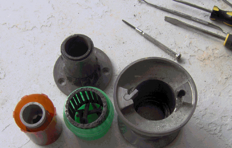

- - - - // - - - -My boat has a pair of Enkes AR-18 winches. If anyone is familiar with these, I have a couple of questions.

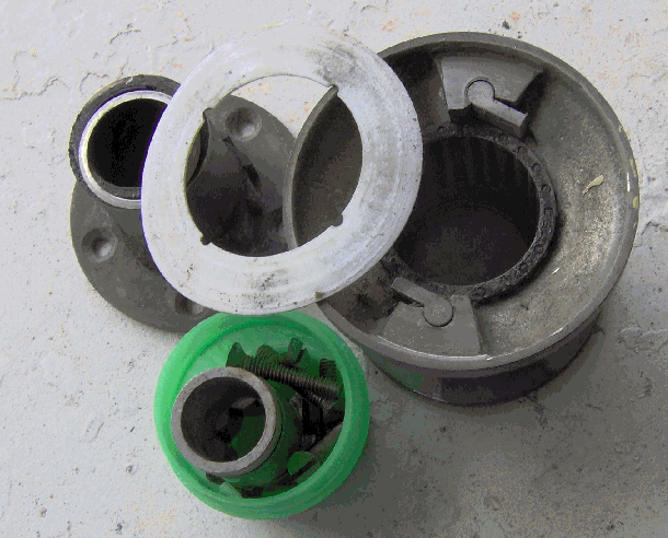

I have answered a couple of my own questions, but I have a couple more.
I see that you cannot properly service this type of winch without removing it from the boat. The driveshaft on this model has a ring on the underside, that can only be removed from the bottom. It's a two person job because the nuts are in the cabin above the sink(port), and stove(starboard).
On the newer winches, everything can be done with the winch in place.
You mentioned that the springs and pawls from Lewmar winches would work. Would anyone know which part #'s? I don't have a place where I can see the parts up close and personal for comparison, and the online places I called said they would need to see them.
The lightweight oil for the pawls I have covered but what is so special about "winch grease"? I have grease for all parts of an airplane, what type and weight is that stuff?

- - - - // - - - -Thanks Ed,

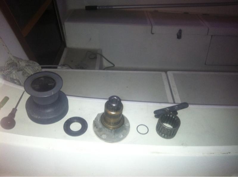

The AR-18's look like this:
When my sailing partner comes up for the Minneapolis Boat Show, I'll turn the nuts in the cabin while he turns the screws.

The first time I rebuilt a winch I used the rebuild kit that West Marine carries by Lewmar. You can also order direct from Lewmar.
While the springs are not exact, they worked and were the only springs I could locate.
Naturally your company is long gone and many others. So the springs and pawls are hard to come by.
I suspect that the springs could be made by a machine shop that makes springs, but they would cost and probably want to make a 100.
If you find another source for springs, post it for the rest of us.
Supposedly you can get parts for Barient and Barlow from the company that bought them out of bankruptcy, but I have been told that a reply takes 6 months, so I never tried. And then only if they have the parts.
I suspect you make a pawl by making a mold and melting metal into, I have done that with plastic pieces, but not metal.
Remember not to fool around with winch until you clean flat surface. Springs and pawls will flop out and so will those retaining rings.

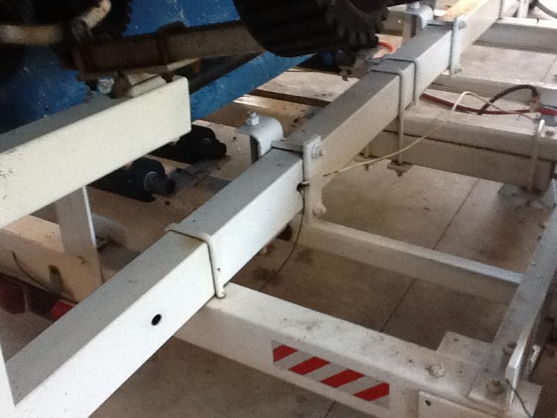

I was going to lift the boat off the trailer this weekend, but my dang boat stands are too short! The Sanibel is only 18 feet and they are just right. Unless the marina has another "spring tippet sale", I will have to come up with another way to support it when I get the centerboard out.

The archives have many demonstrations of alternatives to jack stands. Especially may be found under O'Day 23, 25 and 26 sailboats.
Typically they involve cinder blocks and 4 x 4 's or even 8 x 8's and common car jacks.
Ask an open ended question for references on jacking a boat off trailer to paint bottom. Search the archives for pictures of which there have been several demonstations.

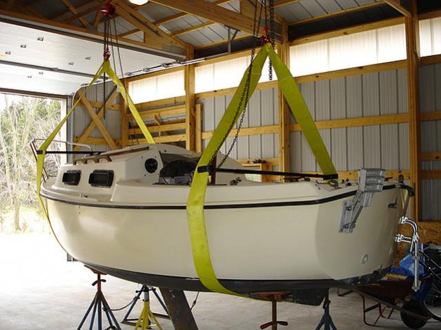

- - - - // - - - -Hi Mike, I was looking at your pic of the front jack stands under your 23.
I did not see anything tying them together so they will not separate under load, please do this for safety. You have a very nice looking trailer too.

John and Mike:
good point - standard safety practice is to 'chain' jacks together - rope stretches.

Hi John and thanks for the spring offer. I may have found a source for the winch springs and pawls. If it becomes reality, I'll post the details for other Enkes winch owners. If not, it is nice to know that you could make them.Technodad said:Hi Mike, I was looking at your pic of the front jack stands under your 23.
I think once you get the winch apart, all it will need is a good cleaning and grease job. If you need springs and can't find them, I could probably make them for you.
John
- - - - // - - - -Hi John and thanks for the spring offer. I may have found a source for the winch springs and pawls. If it becomes reality, I'll post the details for other Enkes winch owners. If not, it is nice to know that you could make them.
The boat is being supported by the trailer. The boat stands are snugged up so I could see how much shimming I will need to make them work. When I use them under the Sanibel, they are chained together to keep them from "kicking out". I could use the lift but I need to see how I will safely support the boat and keel, when I take it off the trailer. Lots of things to figure out with a new boat. I removed the old brake lines today. It's time to break out the flaring tools. The old lines were an acident wating to happen, between their condition and routing.
