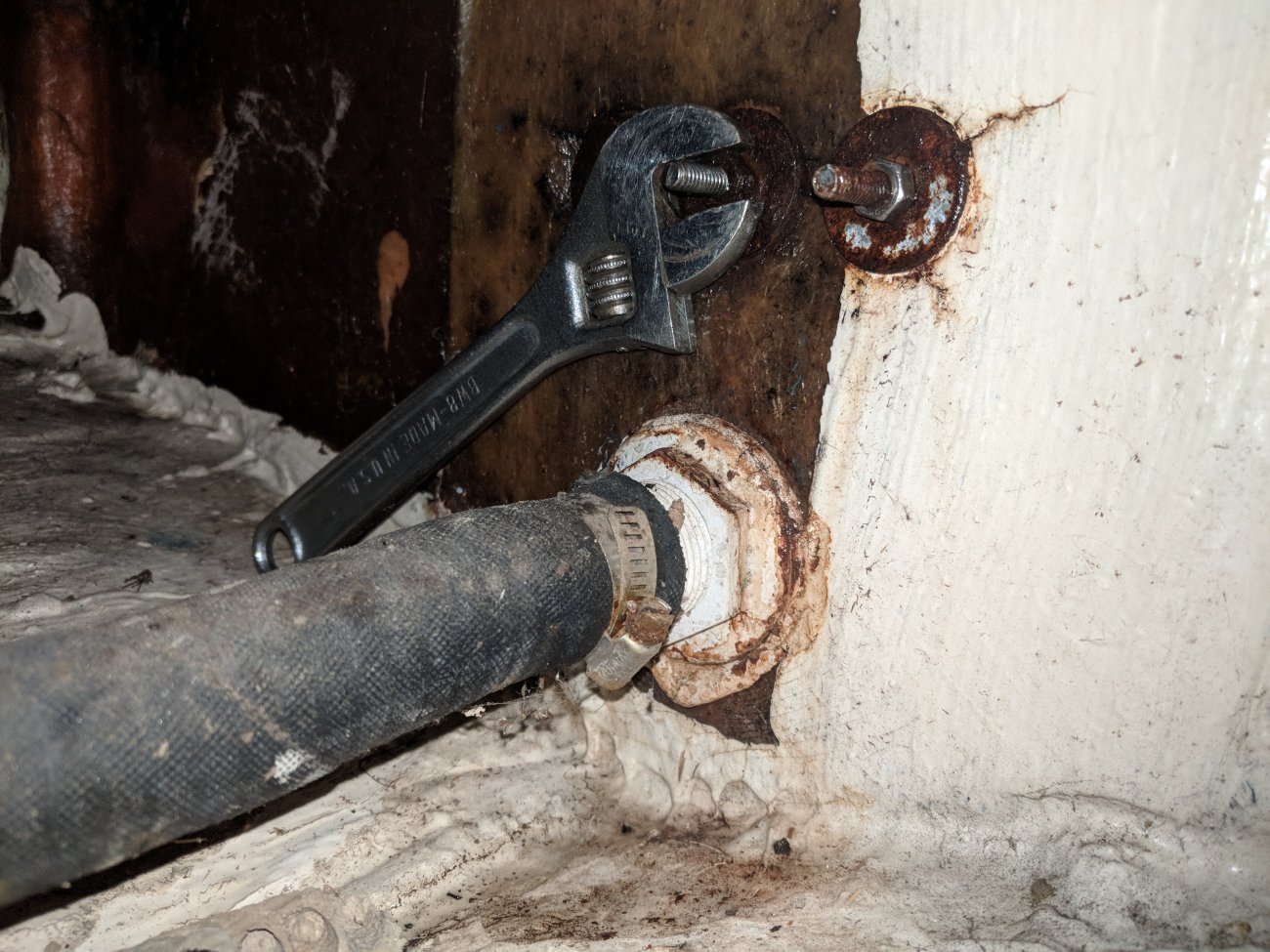

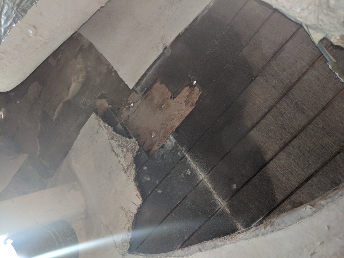

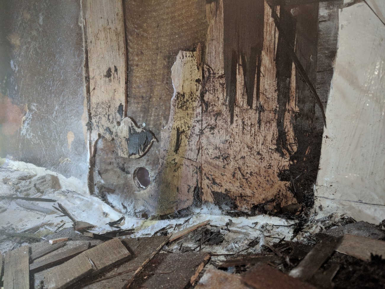

My wife and I bought our first boat last season, an O'day 23, unfortunately, the transom was rotten and wet all the way up into the motor mounts. After months of research and talking with Andy Miller from Boatworkstoday I was able to repair it. Here are a few pictures of the project and steps taken to complete it.

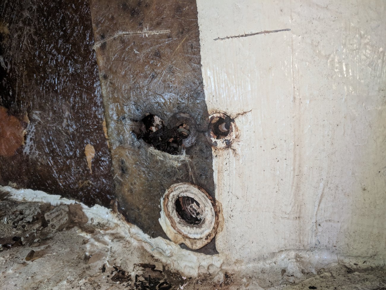

Step 1: removed fiberglass, rotten wood and epoxy down to the outer fiberglass shell

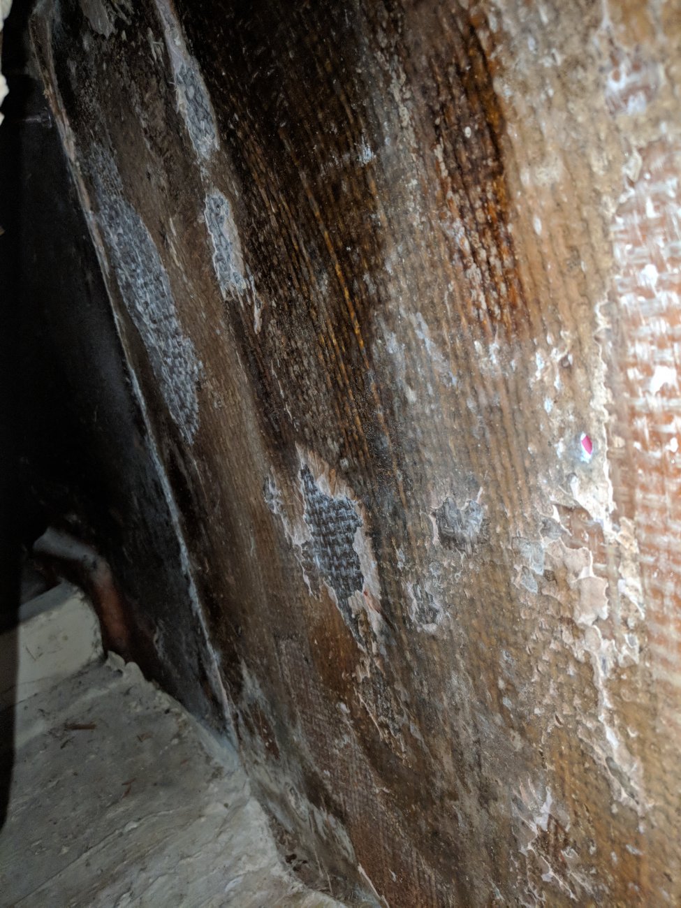

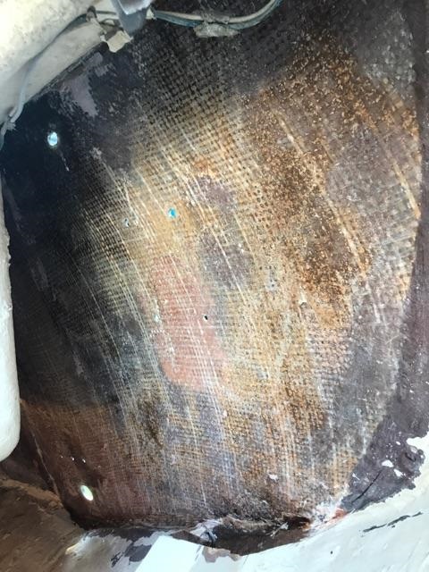

Step 2: smoothed out surfaces and seams between the bottom, transom, and sides

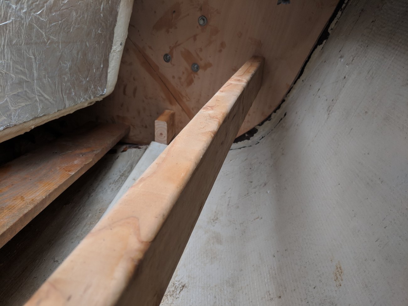

Step 3: layered 2 sheets of 1/4" marine ply and totalboat 5:1 epoxy, clamping with motor mount bolts, gudgeon bolts and bracing between cockpit and inside lazarette

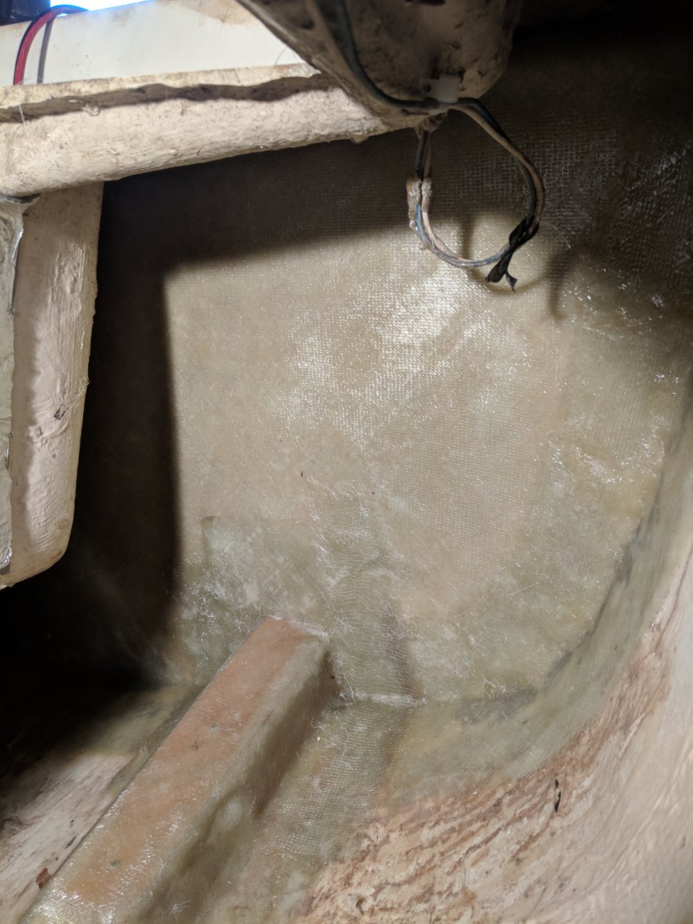

Step 4: 3 layers of 1708 fiberglass with totalboat epoxy 5:1

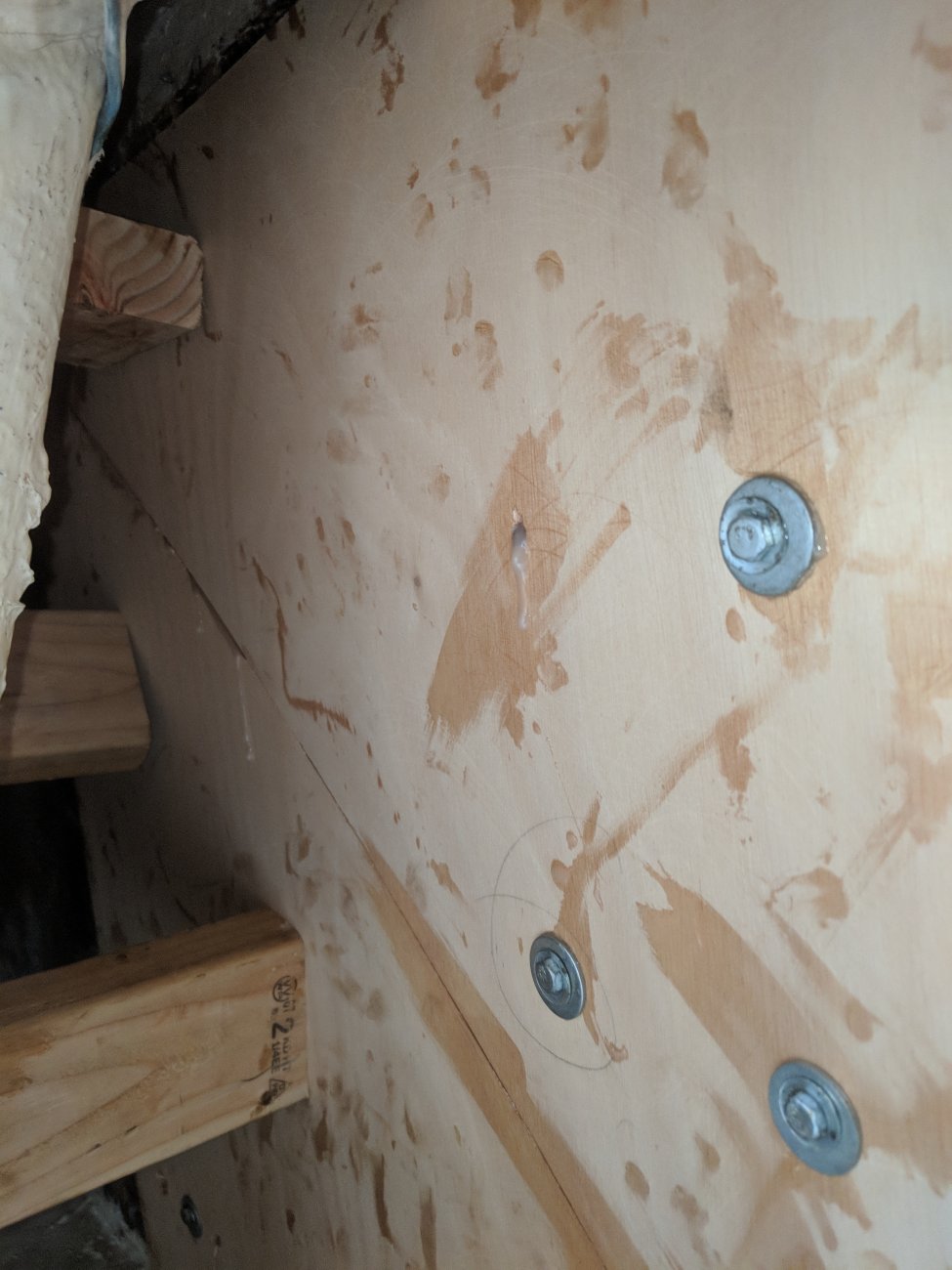

I ended up making stainless backing plates for both gudgeon mounts and the motor, as a lot of the damage seemed to be from the washers pulling through the inner layer of glass.
