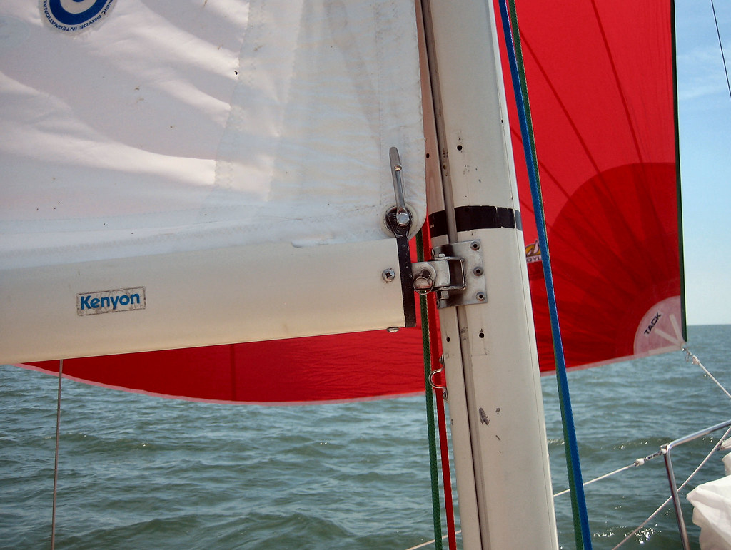

Here is the fore boom end before I changed it and the gooseneck.
