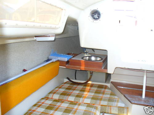

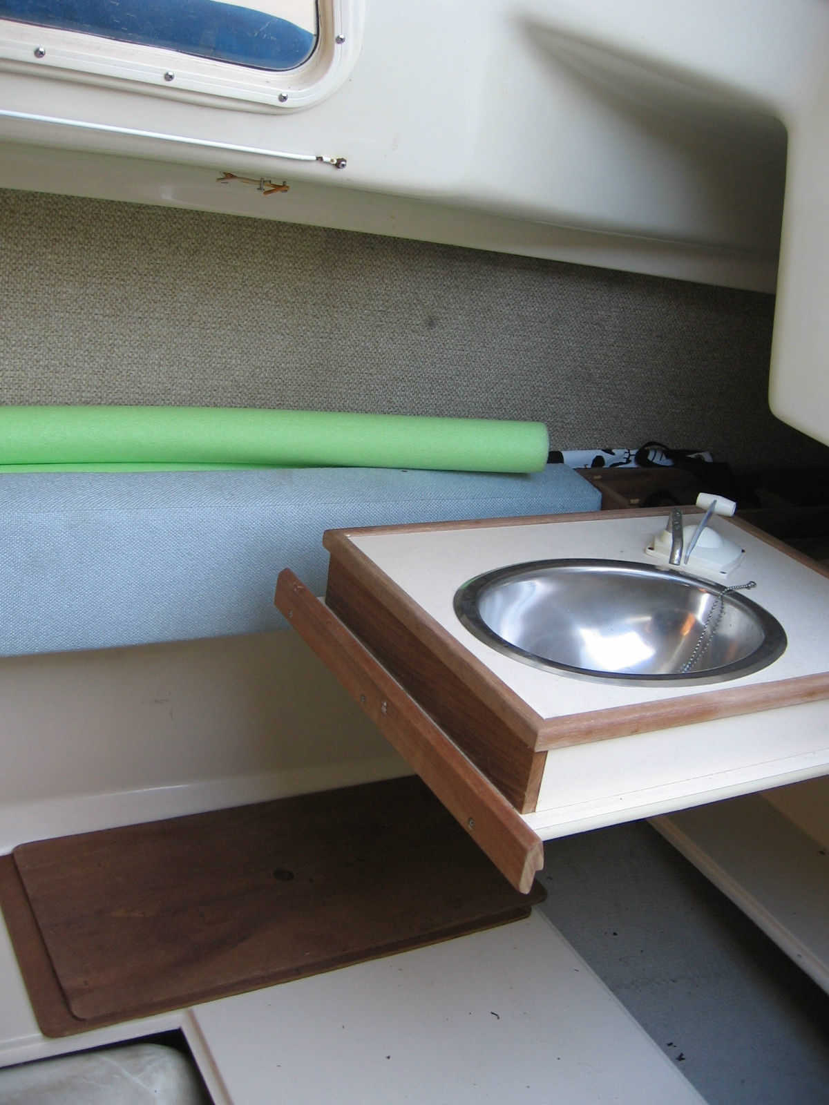

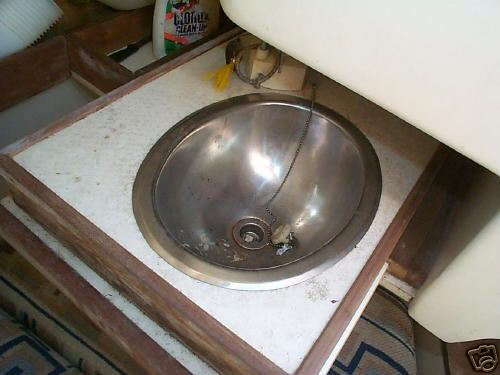

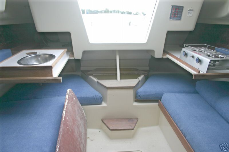

Hello Sailors,
I'm looking to see pictures of the original galley sink & water tank location on the 23' and or buy a sink & water tank. In my boat previous owner took both out.
Thank you!

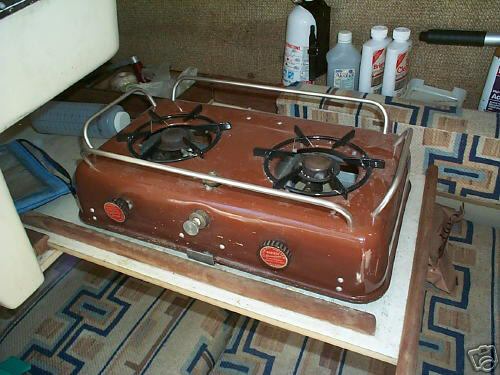

The sink was on a a shelf that slide under the starboard cockpit seat above the settee. The drain hose ran through the bulkhead under the cockpit to a thru hull just above the waterline. The water tank fit into the recess aft of the settee in a small box (about 3" tall) screwed to the floor. The sink bowl was raised about 2" with a box on the sliding shelf to help it drain and keep it above the water when heeled. The sliding shelf is the same design as the port side for the stove if you still have a shelf on that side. At least that's the way it used to be on mine. I would show pictures but I didn't take any before I remodeled.
