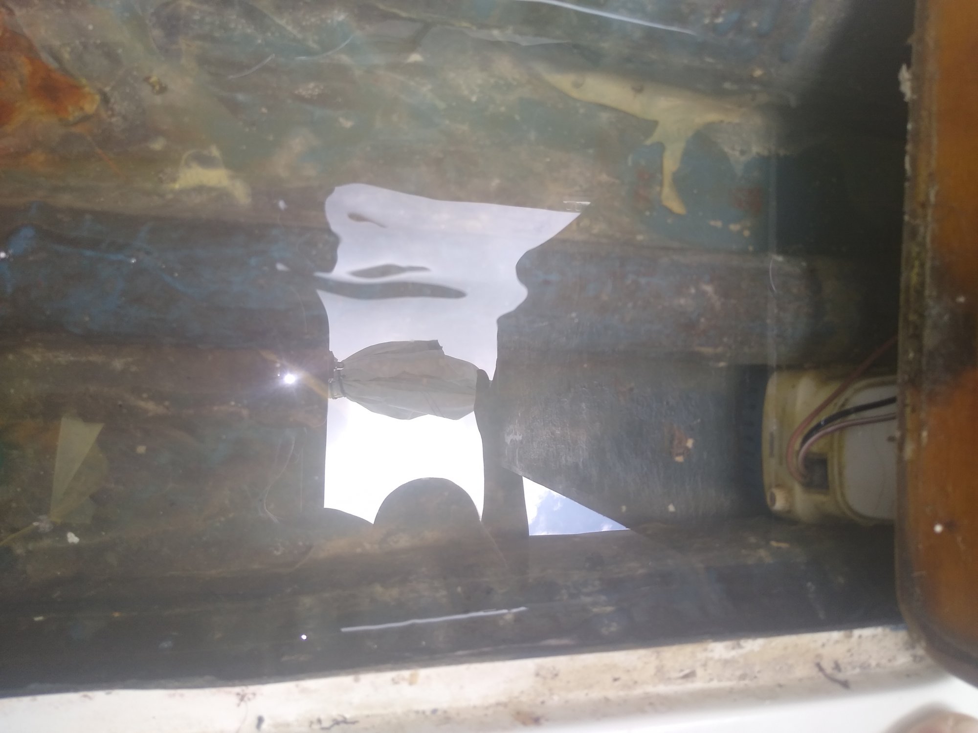

Hello all,

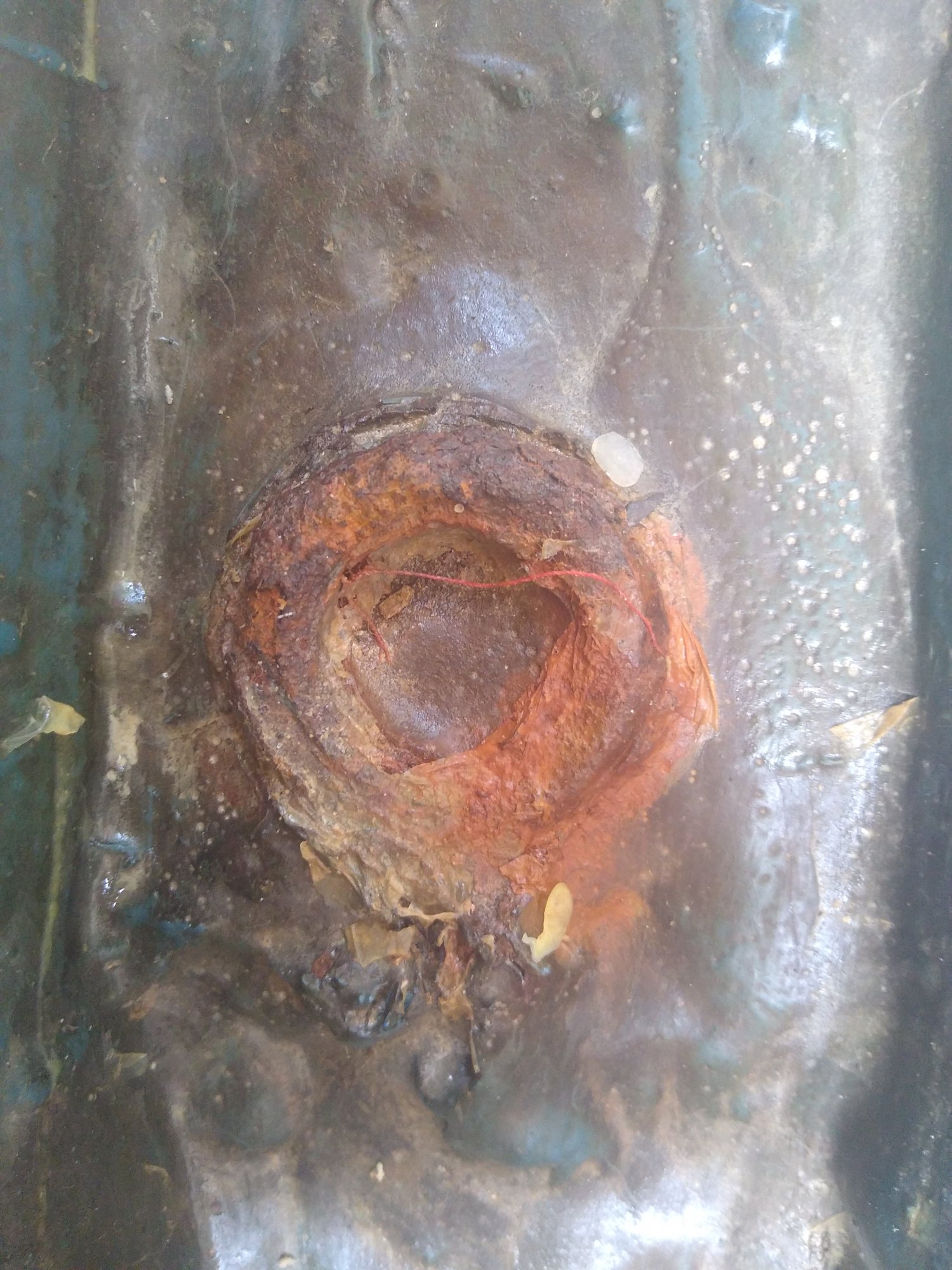

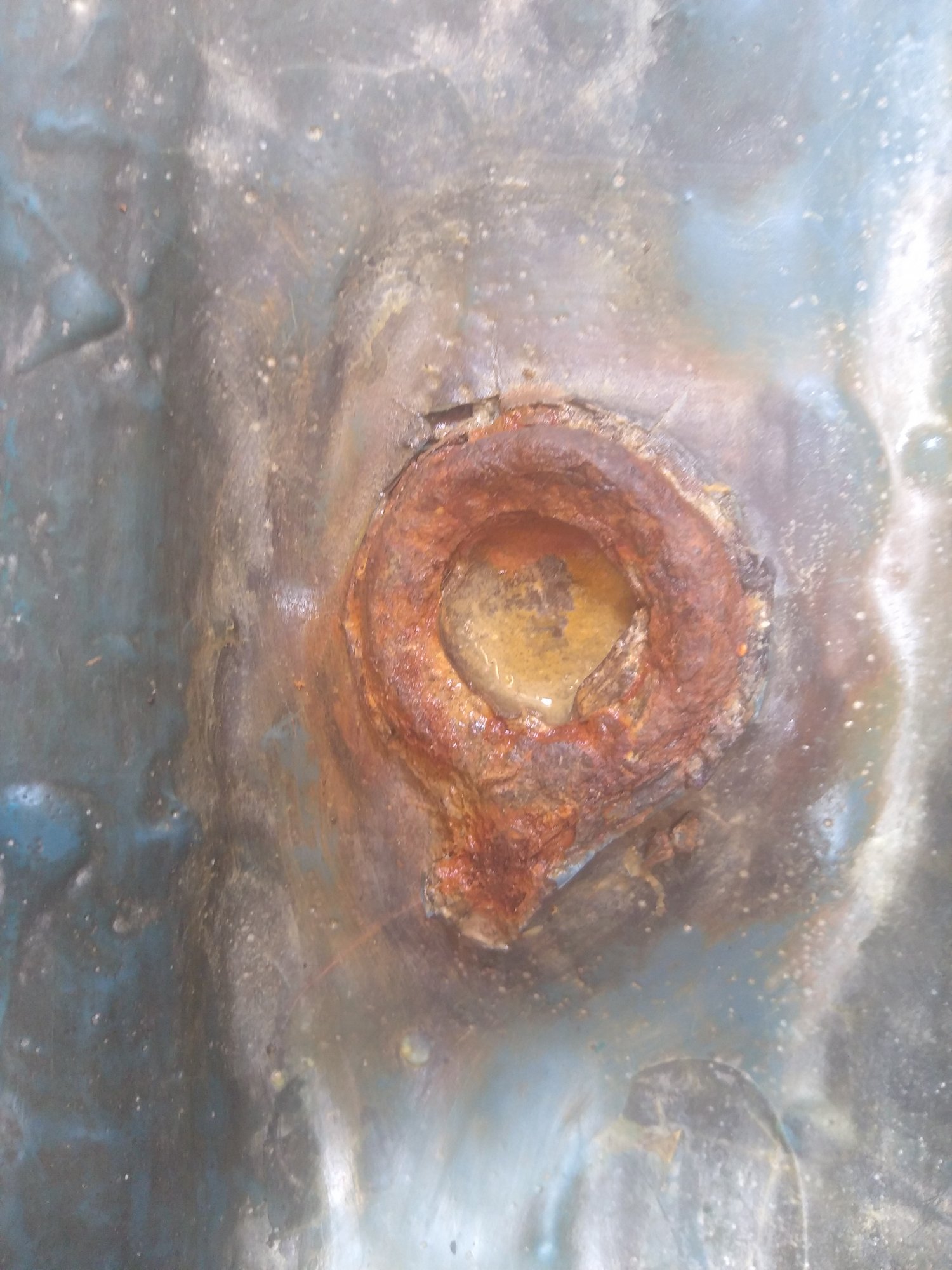

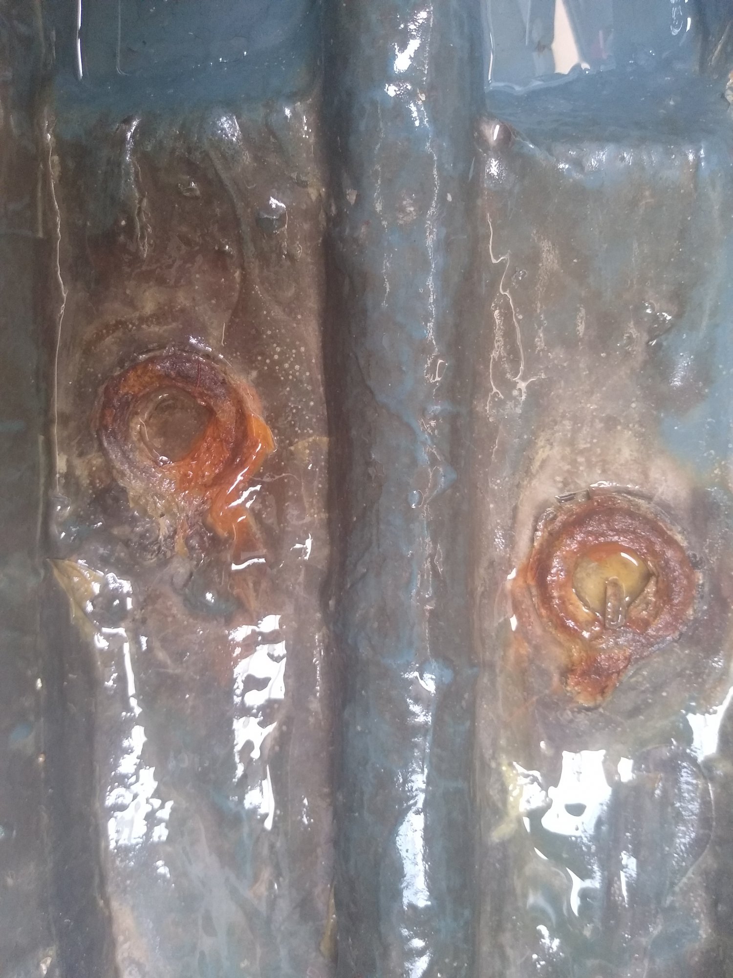

I am sailing South Florida aboard of an O'Day 23. Recently, after laying down the Solace on a sand bank for 1 night and getting a strong tropical storm close to Key West FL I notice two things:
1) Water in the bilge: around 11/2 inches after a day sailing.
2) The cast iron Bolts are corrosive (*See photos):
After Sailing and now even at the dock I get this amount of water in the bilge:
Around 1 1/2 inches
Questions:
1) Best course of action to find and fix the leak?
2) Do I need to replace the Cast Iron bolts?
3) If so what is the correct procedure?
Thank you,
Vince

Wow...hard to tell those are even bolts.
No idea how to get those out to replace, but it looks like something needs to be done to secure the keel.
Greg

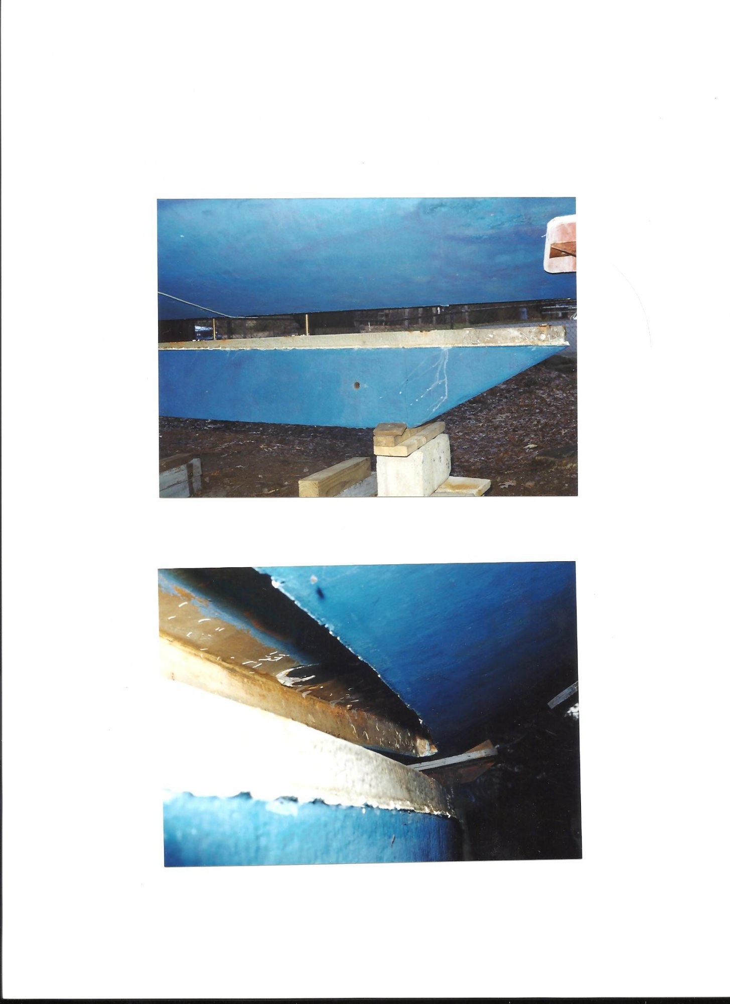

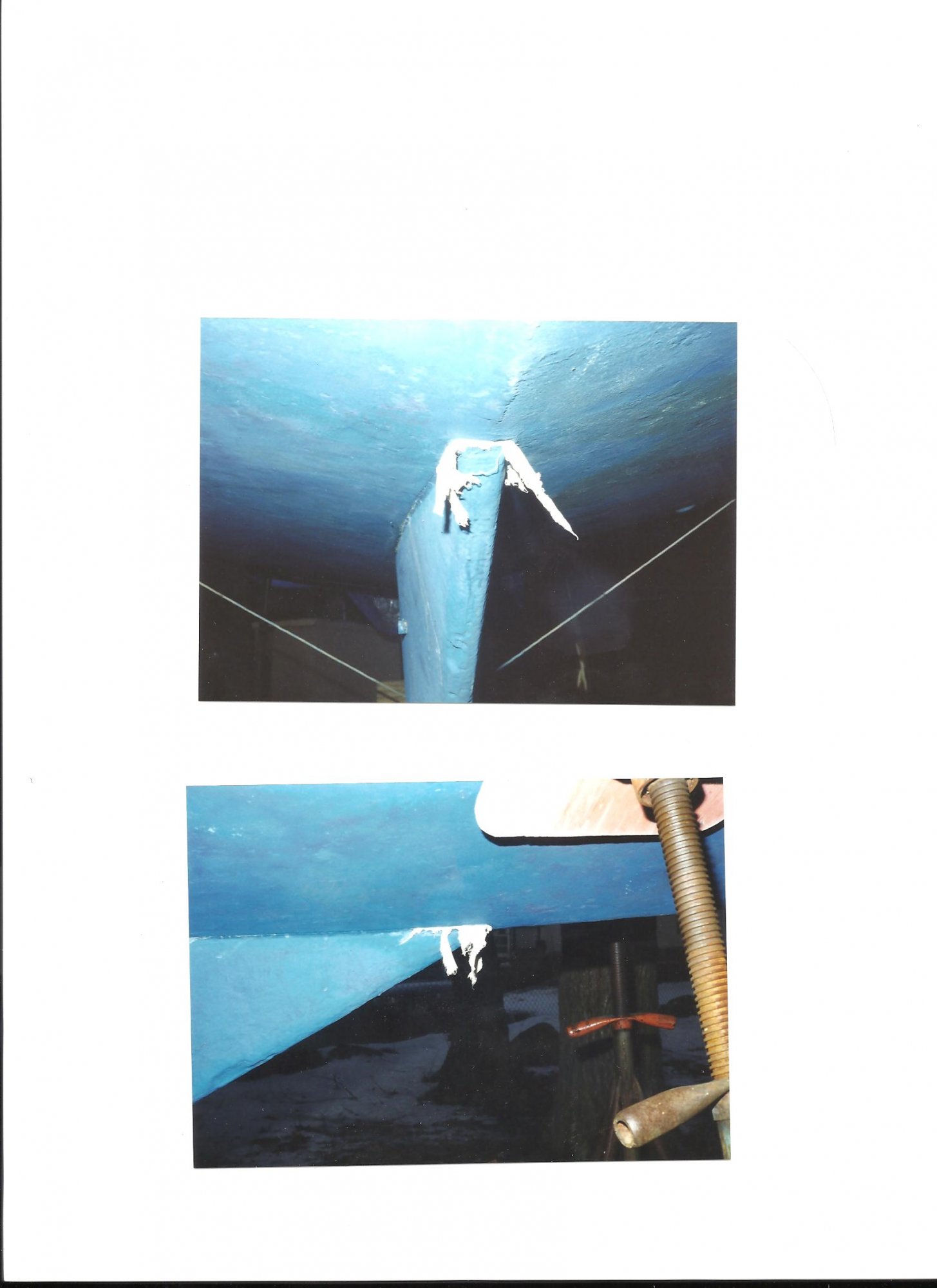

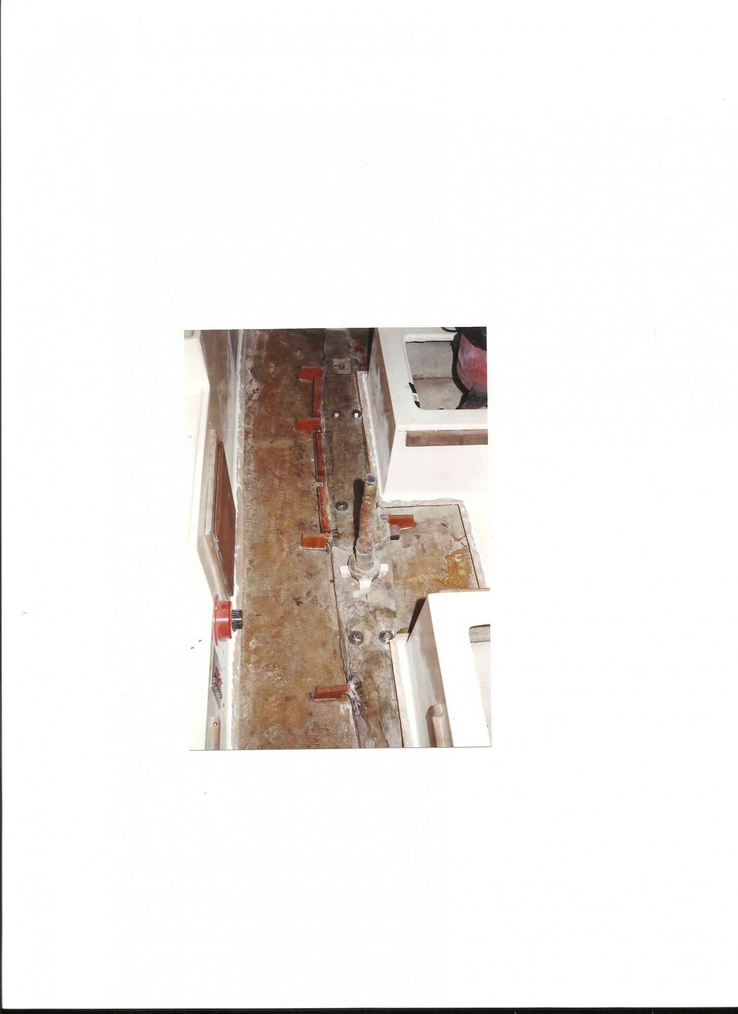

Back in the early 90's I had an O'Day 23 that almost sank on her mooring. I found a foot of water in the cabin, and realized the keel was pulling away from the hull. I ended up dropping the keel and rebuilding the keel sump, and installed longer SS bolts. BTW, the original bolts were SS, but very short.

Some years ago I found a similar problem on my Catalina 27. Bolts were fine but the nuts were completely (almost) rusted away. Partially hidden by fiberglas coating the nuts. Removed the rusted nuts (all but 2) and installed shiny new ss nuts (one at a time). On 2 bolts I couldn't get the old nuts off so I put new nuts over them and tightened them as they disappeared! Did not have leakage around bolts. Are you sure where water is entering? Ted Newport

Thank you, you gave me an idea about what to do.

I would replace those bolts using 17-4 PH hardware. Everyone tends to use 316, but 17-4 PH is rated for submersed seawater application, surprisingly, 316 is not.
dj
MitchM
Jan 20, 2005
1,031
