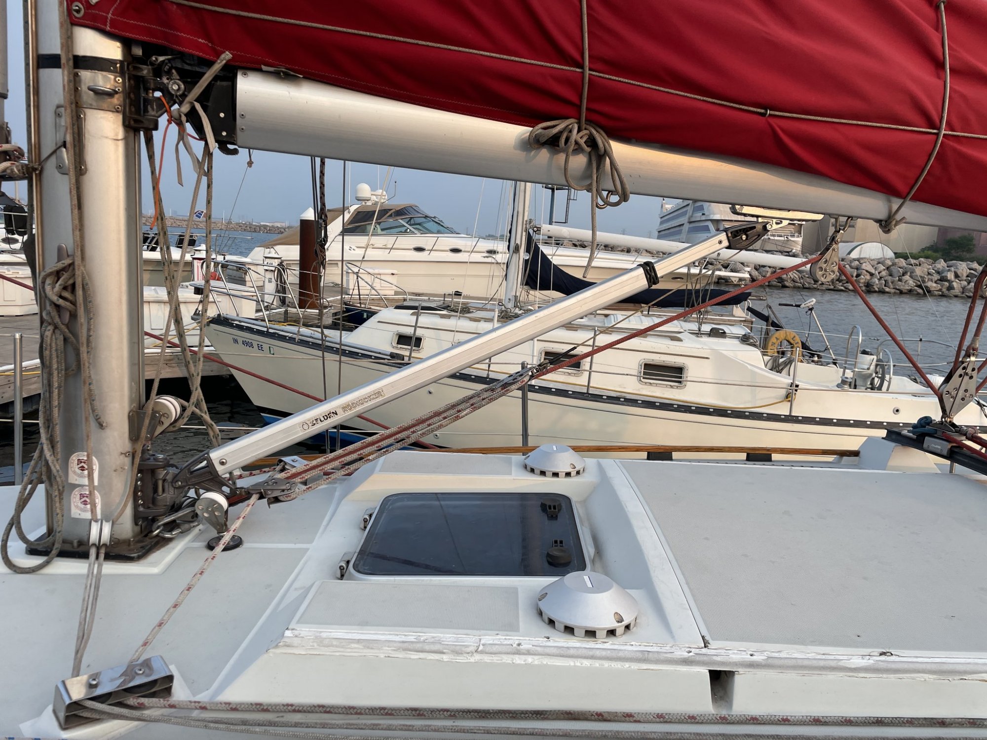

Hard to beat the rigid vang. Garhauer is certainly less pricey than the Seldon version.
Greg
Likes: hasspacher
Mar 2, 2019
679
Oday 25 Milwaukee
Good afternoon. We also have an Oday 25 . We installed a boom kicker brand rigid vang and that alllowed us to finally lose the topping lift.
