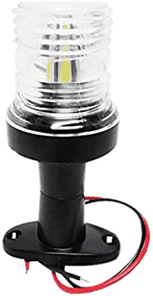

Looking for the bulbs for mast lights on my 23-2. Mast is up so if anyone knows where/what to get when I put it down that’s be helpful.

Not sure if the light configuration and units for a 23-2 has the same as my 30, but I changed out all my lights to LED, not only for longectivity but also to save battery power. For my mast I used the following.
LED - Warm White - STEAMING LIGHT FS-42-12
LED - Cool White - ANCHOR LIGHT TW-GE-15
LED - Warm White - DECK LIGHT - BA-15-12X
Steaming / Mast deck Light
Anchor Light
I hope this helps you.
63
Oday 30 Stamford CT
You may want to post a picture of the light to help identify what model unit you have.

Check the condition of the light fixture before ordering anything. If it's a few years old it may have corrosion that's causing a bad connection. If that's the case, you're probably better off replacing the fixture for an LED one that would substantially reduce this issue in the future
