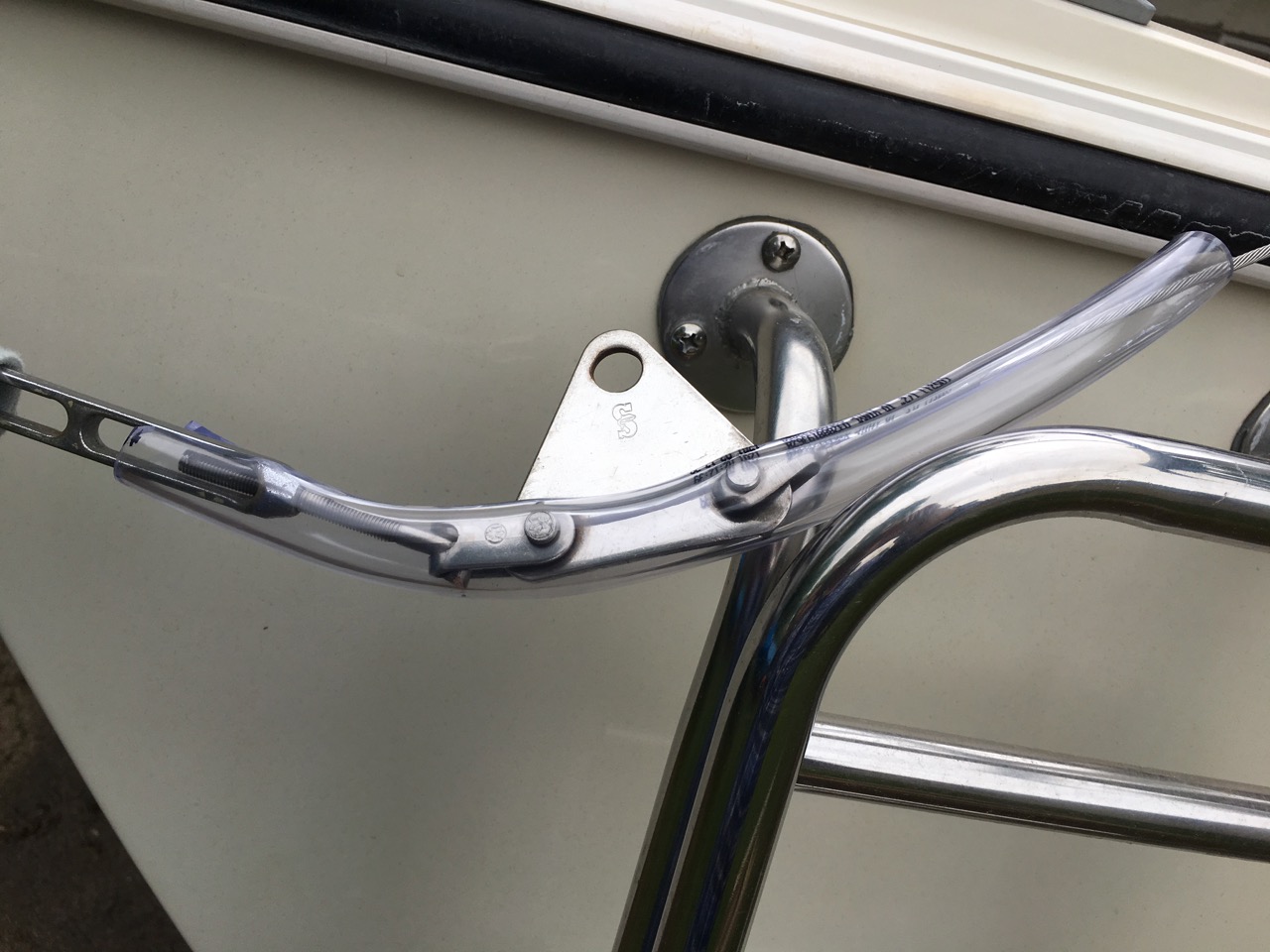

You should replace the bent toggles in the turnbuckles. Usually it's the T-toggle on the bottom of the turnbuckle, not the swaged stud on the wire. You should be able to get replacements easily from Annapolis Performance Sailing or other good sailing chandlery. On my 192, I find I can get the uppers and lower to line up in approximate position, such that they go into position as the shrouds tighten. The backstay is a different story, and it is a royal PITA, catching on anything and everything at the back of the boat, or getting caught with a weird kind in the triangle plate. (Just went through this last night stepping the mast in the driveway to do a preliminary tune.) On launch day this year, I plan to tape a length of vinyl tubing at the triangle plate to keep that all lined up. (I JUST thought of this solution!) It will be flexible as needed, but will keep the short strop, the triangle plate, and the main backstay all lined up during the hoist.
I hoist mine with an 8' crutch with roller at the top set into the rudder gudgeons. I stand facing aft, and the mast is already raised that critical first portion. I can lift it and walk backwards along the house, able to views all turnbuckles, and immediately lower if something is kinked. Since I usually step and un-step alone, and I have a spinnaker halyard rigged to a swiveling cam cleat, once I get the mast up and the upper shrouds tight, I can use the spin halyard attached to the stemhead fitting, and pull it tight and cleat off, holding the mast up until I get the forestay pinned.

I'm hoping to finally launch this Friday. Here's what I've decided try for taming the backstay triangle plate assembly. I bought some vinyl tubing, and cut a split along the length. I've fitted this over the wire, and it grips the triangle plate as best this size of tubing can. I might have tried a bigger diameter tubing, but we'll see if this holds things in line well enough during hoist. I'm optimistic.
