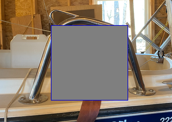

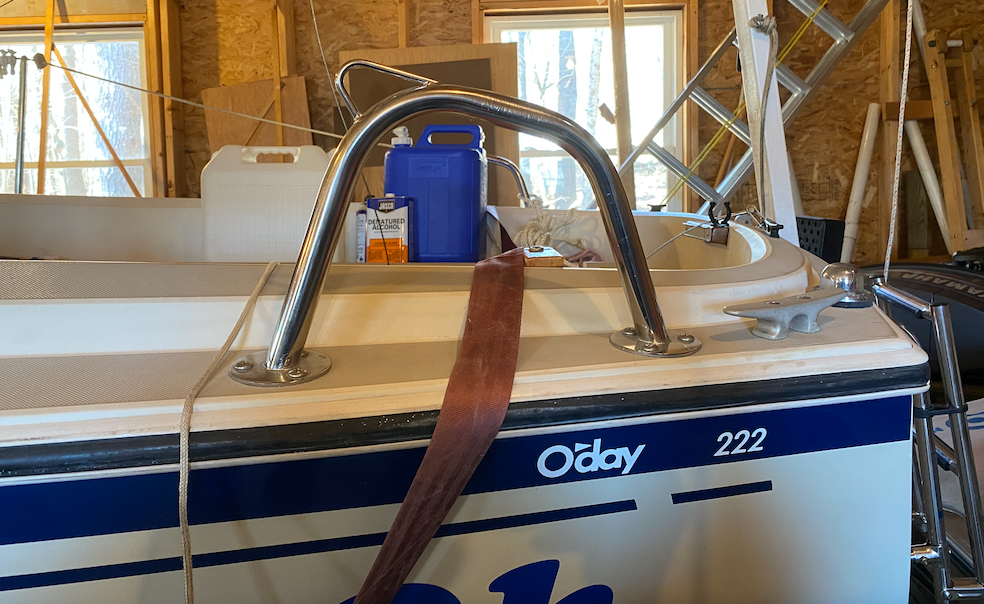

Hi, I have the standard small aft rails on my O’Day 222, and want to hang a 50 to 80 watt solar panel somewhere in the aft cockpit area. I’m willing to add rails as necessary to accomplish this. Has anyone been happy with their solar panel installation an O’Day 222?

Just bought a solar panel and am watching for the comments. I'm thinking of attaching it to the port rear stanchion. Not sure exactly how; but there are lots of options.

I have done an energy audit, and my usage with chart plotter with depth transducer, vhf radio, tiller pilot, LED lights as you suggested, charge my phone and iPad runs in the 25 to 30 amp-hours/day. Taking into account cloudy weather and perhaps only 5 hours of direct sunlight (shadows etc) I think I can do nicely on a 3 to 4 day trip with a 50 to 80 watt panel and my two lead acid 105 amp hour batteries. Mounting the panel is my current issue. I'll install a charge controller etc, but I need something that I can trailer with as well as sail. I can take the panel off for trailering, and that makes sense, but, like everything else, it adds to the setup and takedown time.

If it was me, I think I would do two smaller panels mounted to the outside of the rails. When needed you can flip them up, adjust them to the best angle and at the end of the day fold them down for towing
