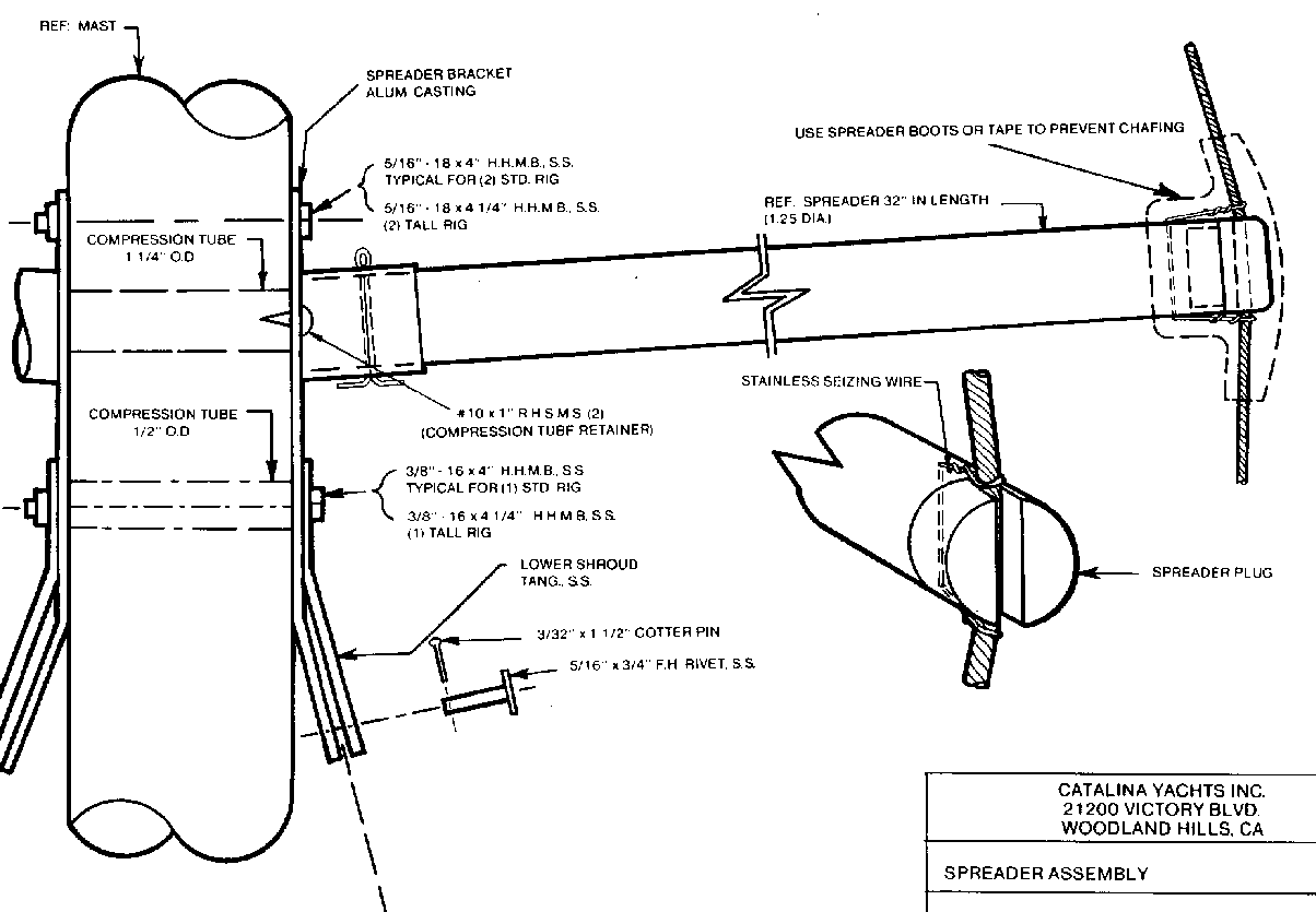

I've been reading up on rigging info. It seems that usually the shrouds are seized to spreaders after the rig is tightened and tuned up.
How important is this on a smaller boat, with well fixed spreaders like the ODay 222?
If I pull the shrouds tight and seize them to the spreaders before the mast is up, will this be sufficient? The sockets that fix the spreaders to the mast are well fitting, and set the angle of rake pretty well.
I can't imagine going up the mast on a little boat to seize the wire in place.

I don't seize the shrouds to the shredders at all. There is a small wire that keeps the stay in place in the spreader but by no means is it there to lock it in place. This allows the shroud to slide in the wire (under the boot) while the mast is raised or lowered so that it stays in place on the spreader.
In fact even on larger boats in the 30 foot range I have never sieved the cap shroud to the spredders. On a small boat do not attempt to climb the mast in a chair or otherwise unless absolutely necessary. A 22 foot boat has a small lightweight mast that is not intended to support the weight of a person aloft like the larger vessels are. It is far easier and safer in a Oday 222 to just lower the mast for repairs.

I know this is not an Oday but here is how it works on a Catalina 22. You can see that the wire just goes around the stay and through the Spreader but is not intended to seize the stay in place.
