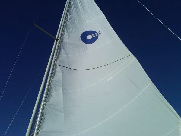

I just purchased an O'Day 222, and I have a question about the rigging.
There do not seem to be stay spreaders, and the previous owner, no novice sailor, said she did not remember any though she had a boat yard to the rigging for her. I can't imagine the mast without spreaders but could this be the case with the O'Day 222?
If she does need spreaders, how do they attach to the mast? Any advice helpful.

I know a couple people with O'day 222s. Yes, there are definitely spreaders on that boat.
You might want to give Rudy at D&R Marine a call (he is usually too busy for email) to discuss. The website does show spreaders for sale for $65 a pair, but these fit only the Dwyer mast, not the Z-Spars mast. http://www.drmarine.com/products.asp?cat=165
The Dwyer cross section is elliptical, the Z-Spars mast had a flat aft side.

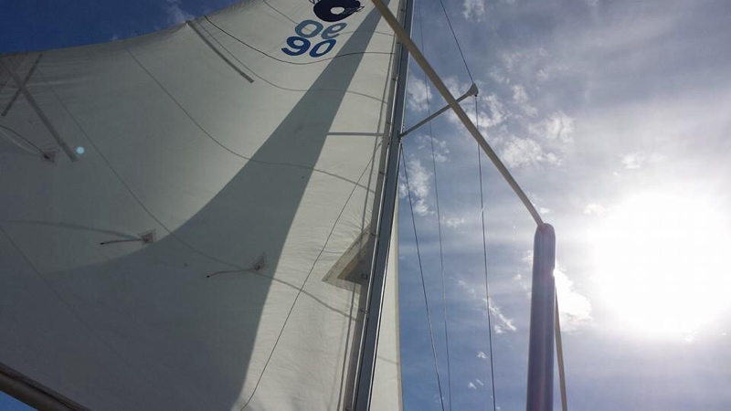

Yes, the 222 had spreaders. Exactly how they attach to the mast depends on which brand of mast your boat has, O'DAY used at least 2 different sparmakers for the 222 (and 192). In general the inboard ends of hte spreaders should fit into or over a pair of brackets on the mast (about 1/2 way up mast) then a clevis pin secures them to the brackets. The upper shrouds will then fit into notches at the outer ends of the spreaders and will be siezed to hte spreaders with short lengths of stainkless-steel wire. The ends should them be taped over to protect the sails fro many sharp edges (rubber or leather spreaders boots could be added for even better protection).
