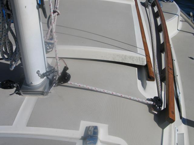

I ran my halyards back to the cockpit of my 1983 O'Day 23 this year, and my wife and I love it. It makes hoisting and dowsing sails far easier and safer than our old set-up, which required us to go forward to the mast. I know Joe is a big proponent of leaving the halyards at the mast and using a roller furler and autohelm to facilitate raising and lowering sails, but for us running the halyards aft was a more feasible (and affordable) option.
FYI, two years ago I installed a utility plate under my mast step (purchased it from Rudy, so it fit perfectly without requiring any alterations or additional drilling). I attached blocks to the plate on either side of the mast to turn the halyards out, and I installed cheek blocks near the forward end of the grabrails to turn the halyards aft. I also installed Lewmar rope clutches (because they can be released under load). Since my jib is hanked on, I use a downhaul to bring it to the deck. I run the downhaul through small blocks that I installed at the stanchion bases to a small cleat at the stern on the port side. Works great.
By the way, I bought all the hardware new. Total cost was about $300.

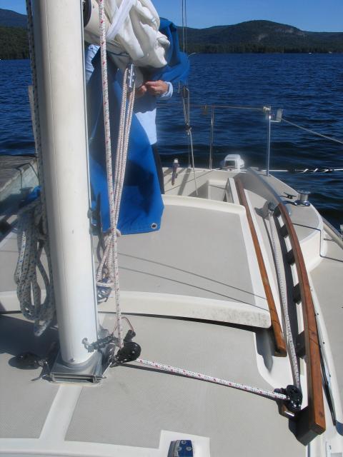

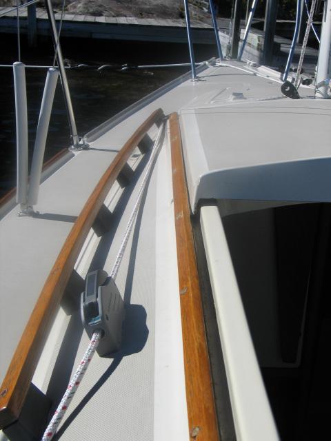

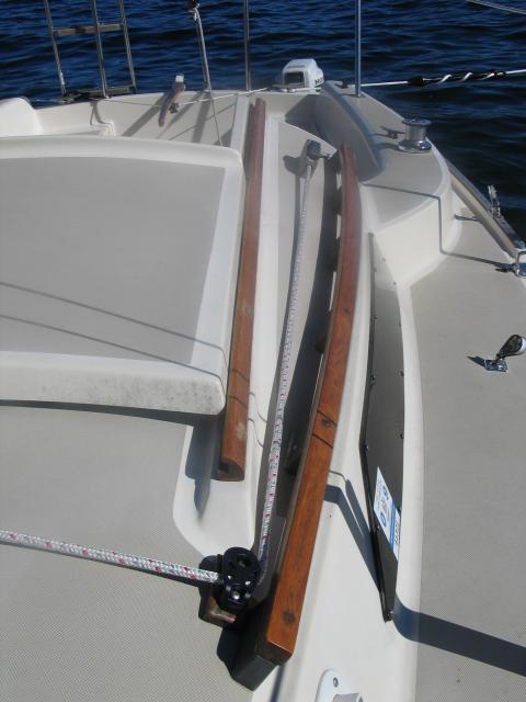

Mich, we did get to sail yesterday (gorgeous fall-like day, light winds), and I took a few photos of my halyard set-up. I shot the port side because of the angle of the sun, but the set-up is identical on the starboard side. I run my jib halyard on the port side and main on the starboard side.
As you can see, I installed a pad under the cheek blocks to make sure the lines cleared the deck. Placement of these blocks was tricky because there was so little room between the cabintop hatch runners and the grab rails. Once I figured out the placement, installation was fairly easy. I used oak for the pads. I sealed them with polyurethane and stained them to try to match the teak grab rails.
I hope this helps.
