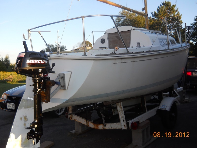

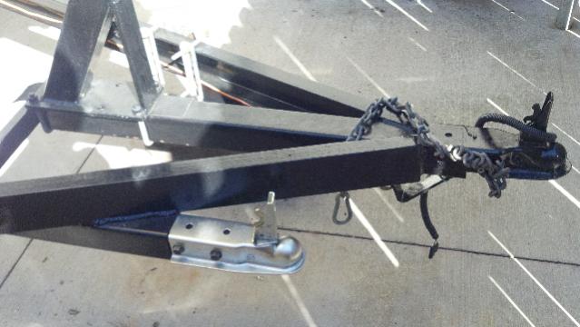

Just purchased my O'Day 22 this past year. She sails great - but I have an awful time loading her on the Trailer. I even bent the tongue - which now has to be completely replaced. (I have a welder lined up to do this work in the spring.) My question - Can I use rollers under the hull and keel to make the whole loading process easier? Especially when a landing is steep - I can't crank the boat forward enough so it sits in the proper position. As soon as the weight of the boat is out of the water and sitting on the trailer - it is impossible to crank ahead. Please help!

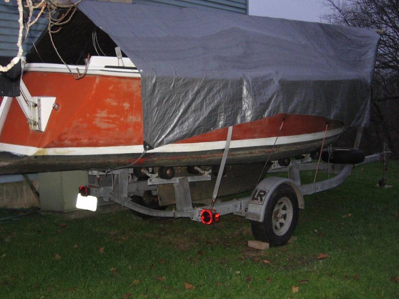

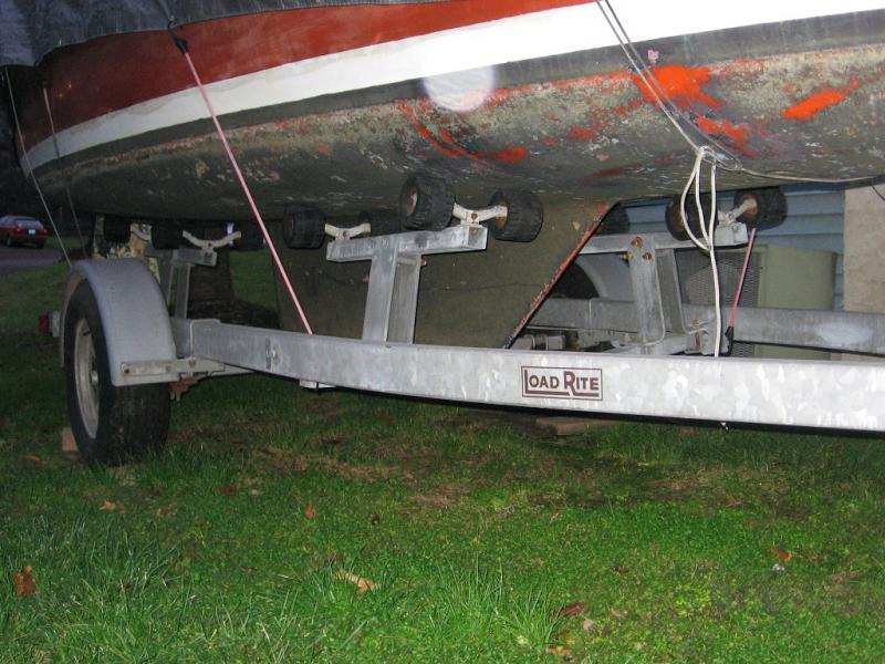

To be perfectly honest with you, I've never seen an O'Day 22 on a roller trailer but that doesn't mean that your O'Day 22's hull isn't strong and thick enough to take a complete roller trailer. I would venture to even go out on a limb and say, Yes. I honestly believe that the O'Day 22s can take a roller trailer and the reason I say this is because I've seen O'Day 25s, 23s, 222s, 240s, 192s, and even a fin keel O'Day 25 on a roller trailer.

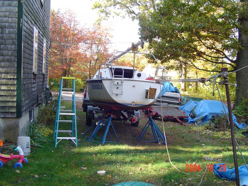

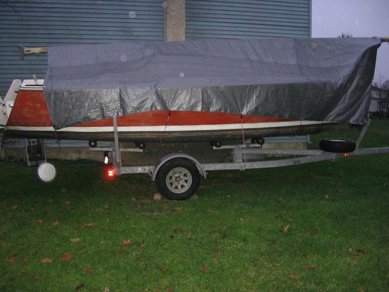

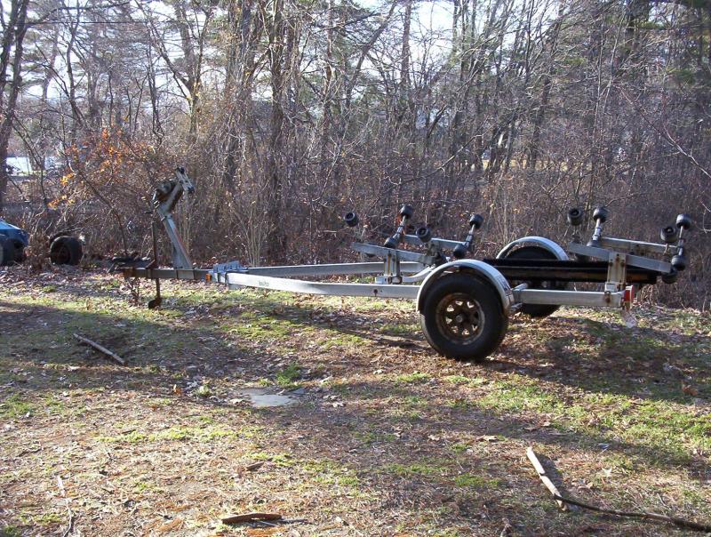

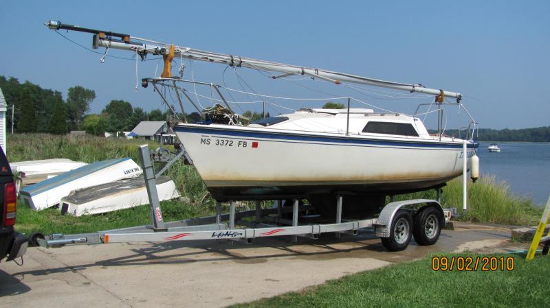

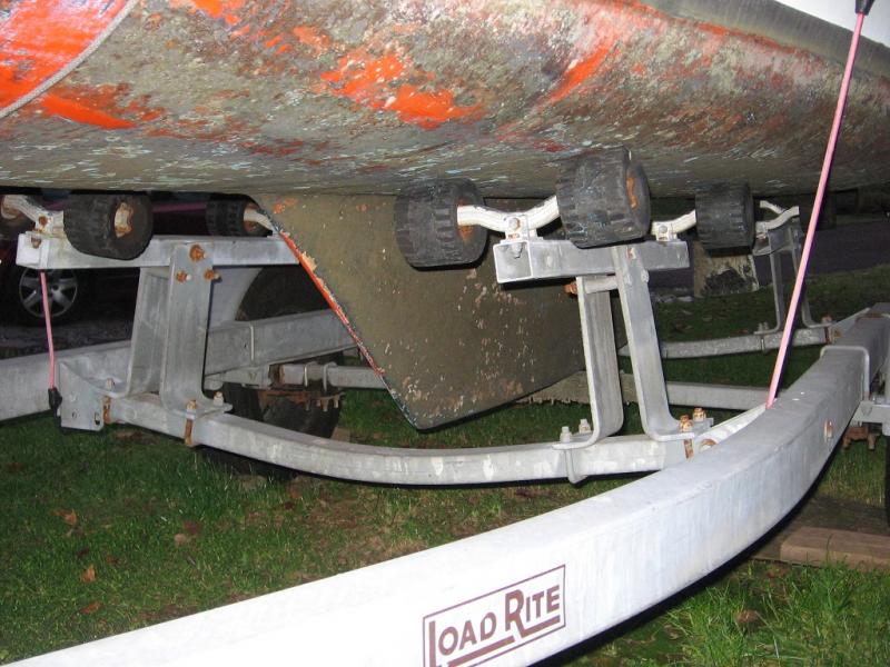

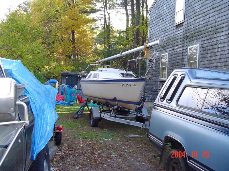

My boat came through new back in 1986 at the Boston Boat Show with a Load-Rite single axle roller trailer with 15" wheels and that boat would almost fly off that trailer as soon as I let the winch cable off after backing down the ramp with the water up to the center of the wheel hubs. I tied a long line to the bow which was made of of two of my 25' mooring lines tied together, and let the boat drift down almost to the end of our dock.

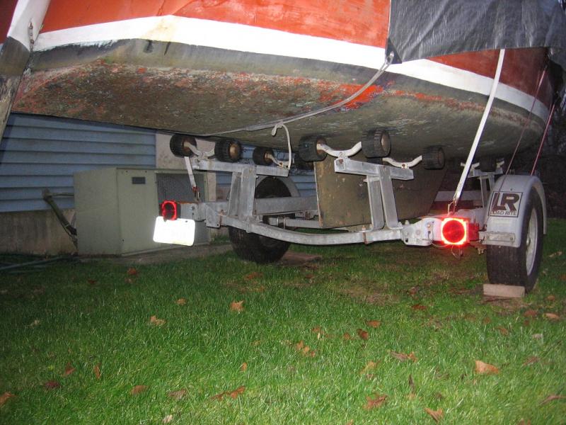

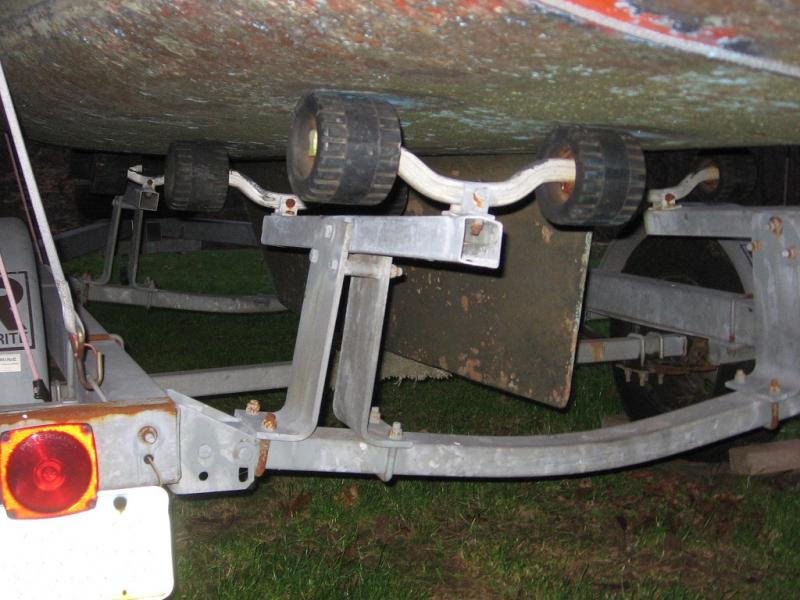

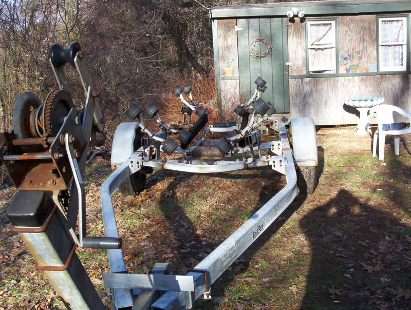

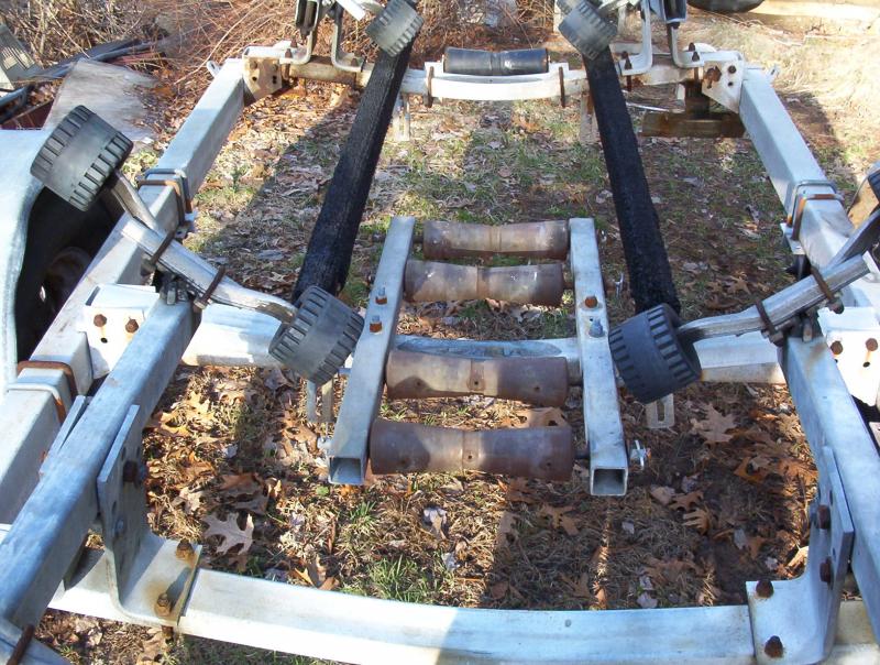

The trailer had a rack of four 12" keel rollers on 18"X5/8" pins with buddy caps. Actually the weight of the boat can sit on these keel rollers and let the hull roller support the rest of the hull.

There are pros and cons to roller trailers and they are:
Pros: You can launch your boat at most ramps the same as launching a powerboat.
You can take your boat off the trailer easier to and from boat stands at the end and beginning of the season.
Cons:
A roller trailer is more expensive to set up or buy already set up.
Bent keel roller pins that can bind up a roller which is a direct cause of trailering over bumps in a road.
Keeping the keel rollers lubricated.
A roller should be mounted on the last cross member of the trailer to ease the bow over it as she descends into the water. The roller will prevent damage to the bow.

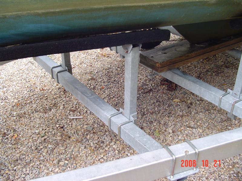

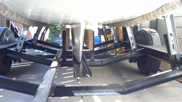

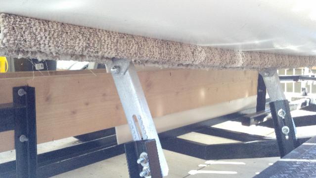

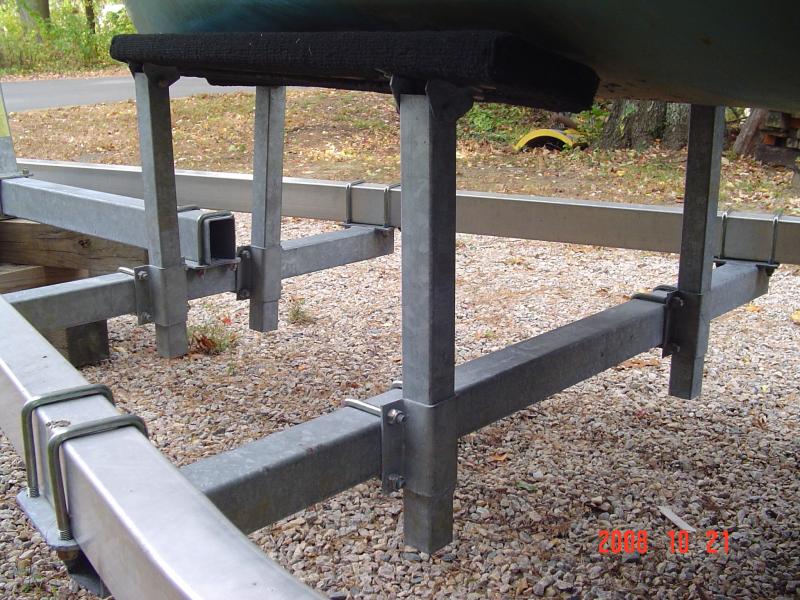

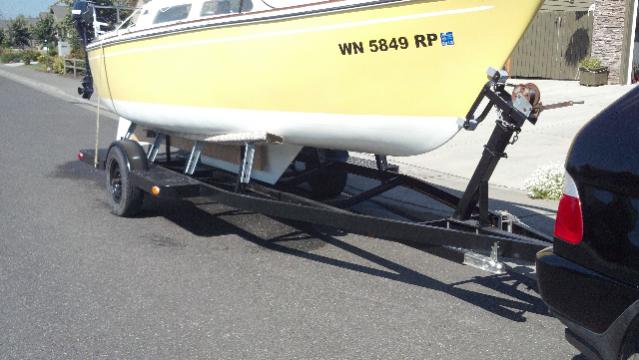

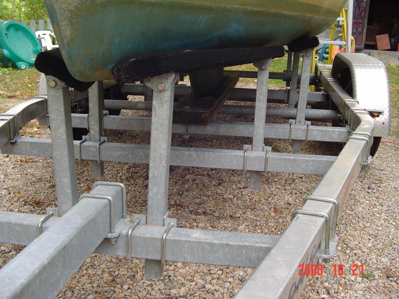

With that said, if your planning on leaving the boat in the water, you could get away with a flat bunk trailer that will take a 23' boat. That way, the trailer will be long enough to back down deep enough to float the boat on and off the trailer without swamping the towing vehicle. The trailer can be a powerboat trailer which is rated for the weight of your boat with longer extension brackets to support the bunks which will need to be raised to make allowance for the depth of your keel.
The keel can sit on two sandwiched pressure treated planks attached to the cross members of the trailer.
