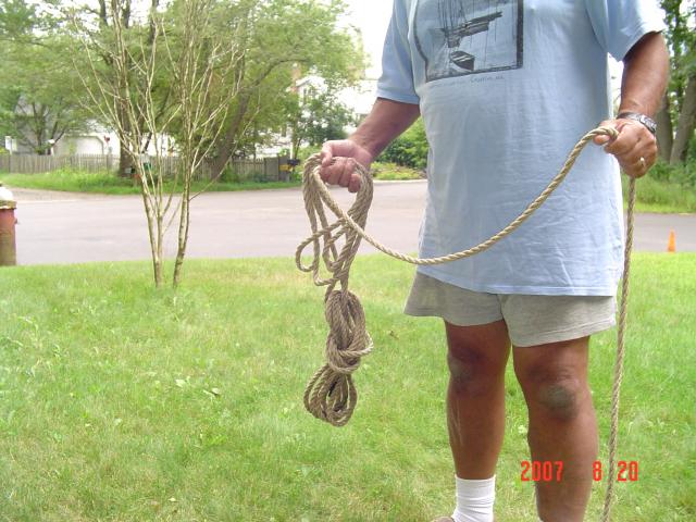

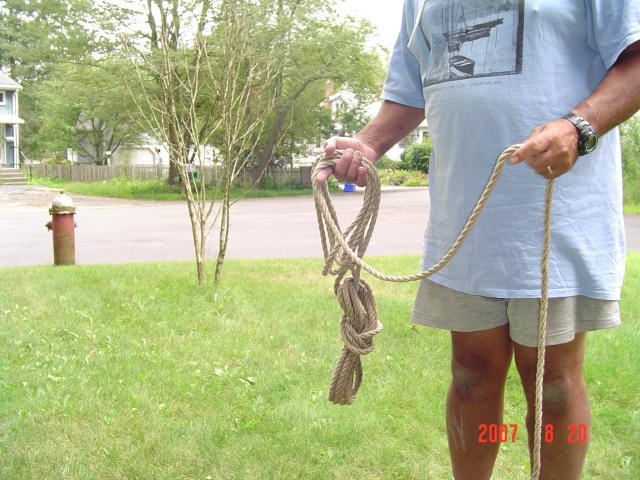

You might say, "OK Fuzzy,--but how the heck can I throw a rope over a spreader?" "I don't know how to tie a "Monkey's Fist"? "
To tell you the honest truth, I don't know how to tie one either, and I wouldn't use one if I did. What if that fancy braided knot in the rope gets caught? Then what? I'll show you an easy way to throw a rope over anything and if you miss your mark, you can pull it back each time without getting caught on anything.
1. First, you start by taking a 3/8" X 40' to 60' rope in your right hand, that is, if you're right handed, and make about seven to ten 12" counter clockwise coils. 2. Then take three or four tight clockwise wraps around the center of your first coils and bring a bight or loop of that rope through the top of those coils. While holding that new loop or bight of the rope, you can now let the first coils drop while you start making a set of new coils in the same way that you made the first coils. The first coils are going to be the weight of the rope, similar to the weight of a "Monkey Fist" and the second coils will give you the distance needed to reach an object. When you get done, just hold the rest of the rope in your left hand, and throw the coils in your right hand.
This techique of throwing rope can be used to throw a rope over a limb, or throw a rope to someone standing on a dock or another boat. I learned this rope trick many years ago when I became a lineman for a power company and most lineman today know and use this rope throwing technique.
