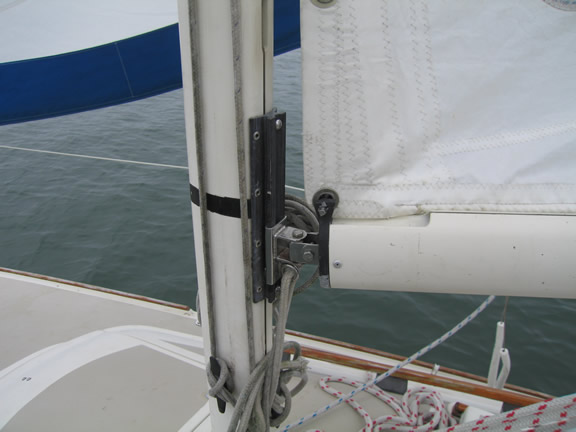

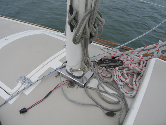

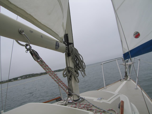

I'm also a newbie with the O'Day 22. Picture below was taken yesterday and shows the way I rigged 'Greta'
Thanks for the pics. Also of interest to me was the mast wiring visible in your photo. I need to install a masthead and an anchor light at some point and there is no existing wiring.

If you look closely at the wiring in the photo you'll see that the wire from the mast is broken at the connector. The mast rewiring is part of a future project. I plan to install a VHF radio antenna, windex light and mast head light. I'm looking for a reasonably priced LED mast head light.
