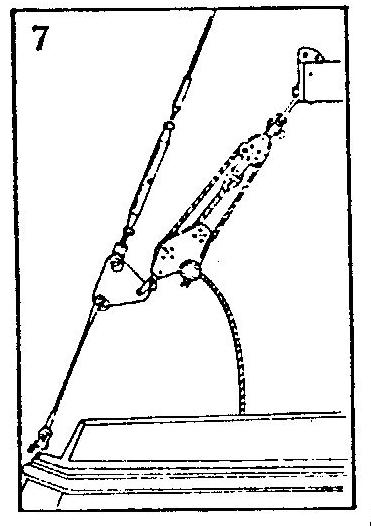

There are several good pictures right here on this site under the boat info>photos section. It appears the O'day 20 uses the configuration common to boats this size: mainsheet tackle attaches to a triangular stainless steel plate on the backstay.

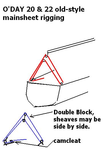

The 20 used one of 2 different mainsheet setups:
1973 models used a setup of 2 blocks, one each side of stern and a double block on boom end, mainsheet cleated to a camcleat attached to block on one corner of stern. I think some 1974 models also had this setup.
During the 1974 Model Year, as far as I can tell, O'DAY switched over to the setup used on other O'DAYs (19, 192, 22,23, 222) with a traingle-plate on hte backstay. See pics of both below.
