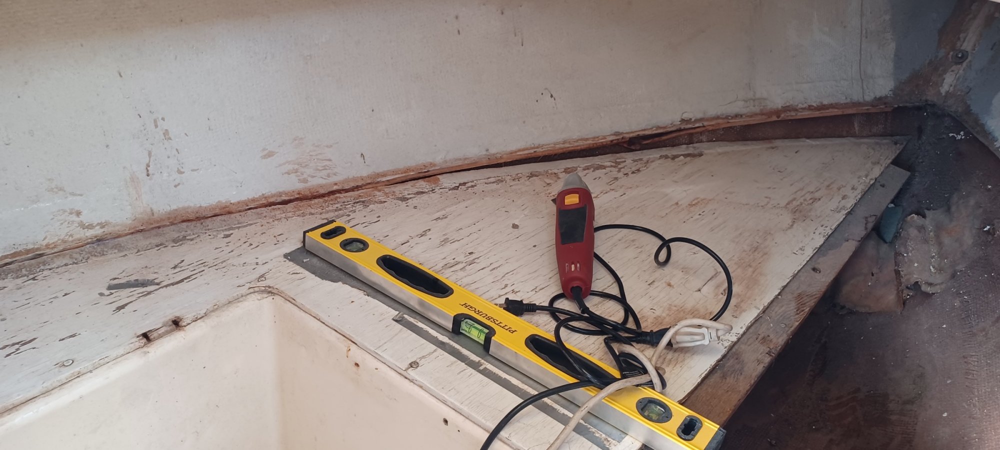

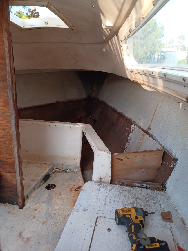

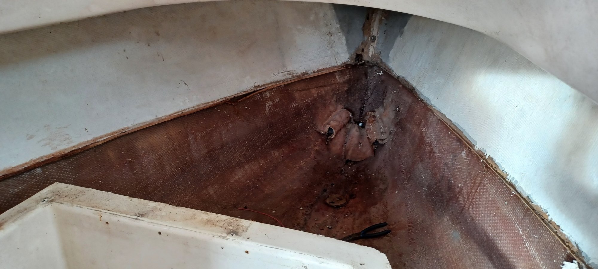

Todays task....Removed bulk head and clean up V birth cutting left-overs off the side of the hull. Its going to be a slow process I know but worth every bit of effort.

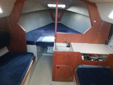

Thanks for posting the images. I am curious as to your planned layout. Are you going to replace the transverse bulkhead and the v-berth? If not, you might want to check out the interior of the O'day 222. Keep us posted.
Aug 12, 2023
10
Oday 20 Rockledge
Lol...I sit inside her often contemplating the layout. At first I considered just replacing everything as it was but the more I demo, the more I realize I can get creative and still maintain structural integrity. The old floor is coming out as well but for now it's just a slow demo and a lot of daydreaming due to our newbourne. I work on it everyday for atleast an hour.

Oday 20 Rockledge
This does look a little like what I invisioned while considering my options. Thank you for the reference.
You do know that the bulkhead is the only think holding up the cabin roof :yikes: ? Maybe keep your overweight brother-in-law off it until you've replaced the bulkhead.

RE: "The old floor is coming out as well but for now it's just a slow demo and a lot of daydreaming due to our newbourne (sic)."
The "floor" as you call it is the cabin sole. I cannot say for sure, but if it was designed like all Ray Hunt O'days, the sole would be a grid type structure tabbed into the hull after it came out of the mould. IMHO, given the type of keel it has, I would leave it in place lest the hull deform while you are working in there without any internal bracing. I've heard of this happening to Rhodes 19s when the internal bracing (in this case a wood lattice structure) was completely removed. You could brace the hull externally, but to me it does not seem worth the effort. FWIW, I would do whatever modifications are necessary to get good access underneath, clean it, paint it and start from there.
Lol...yes I do. I put supports in to prevent sag overtime.
