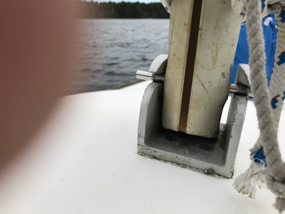

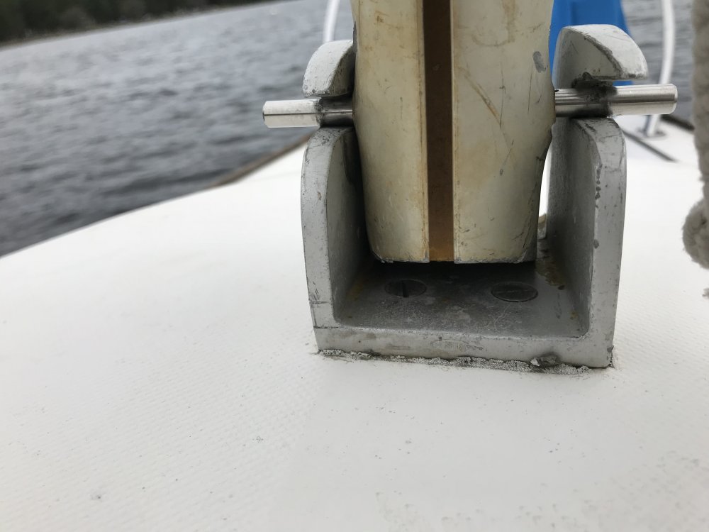

Here is what the mast step looks like on the top of the cabin. As you can see, the entire mast is supported by a relatively thin tabernacle "rod", which I replaced this year. Is there any hardware missing here? I am aware that the more recent mast steps are "beefier".

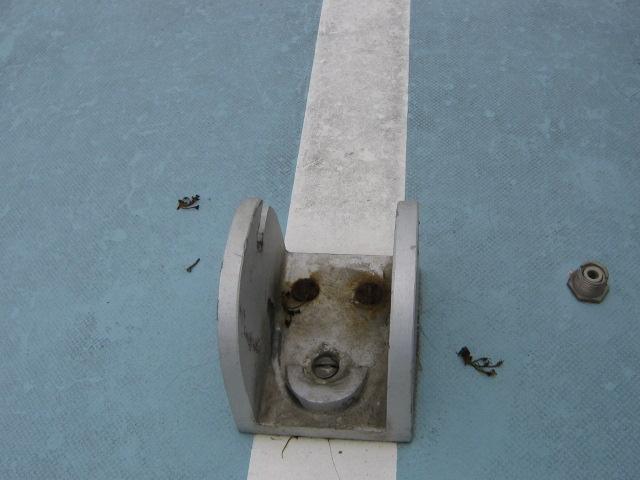

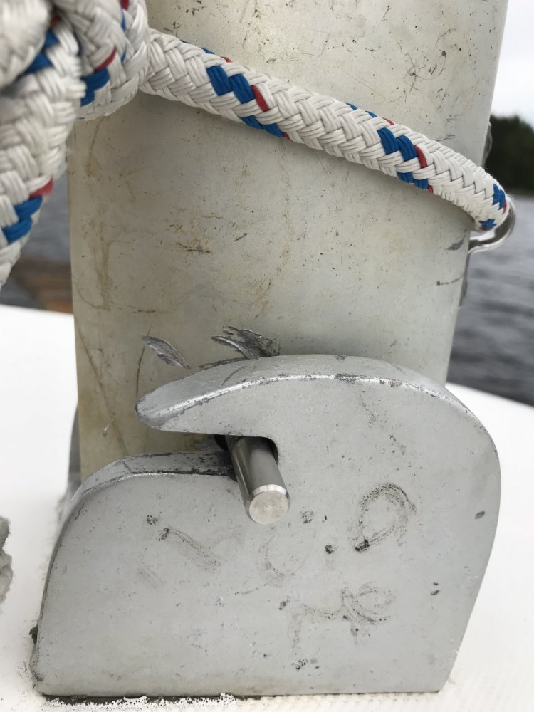

Your tabernacle is setup fine, as built. That pin is the right one as far as I can tell. If you look closely, you should see that the forward edge of the bottom of the mast is (or should be!) resting on the base of the tabernacle, this takes some of the vertical downward load (actually most of the load) off the pin and concentrates it on the bottom of the tabernacle. I have seen other examples of this same tabernacle (on a 22 I think?) that had a little ridge that interlocks with the mast butt to prevent the mast pin from sliding aft and out of the tabernacle slot.. I'll try to post a pic.

Yes, the mast step attached to the cabin has that ridge similar to what you have pictured on which the forward edge of the mast rests. I also looked carefully at the cabin yesterday evening and don't see any indication of sagging under the mast step, and the cabin roof appears to be firm. I think I will just have the forestay shortened by an inch or two, that should straighten the mast, and allow the side stays to be a bit tighter. Of course the other possibility is that I am over=thinking this whole thing a bit.....thank you for all of your help.
