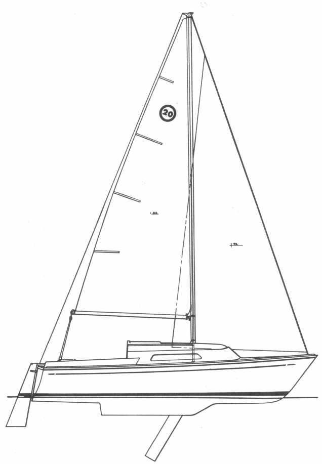

She is a 1976 with a fractional rig.
So, if the boat that the mainsail came from is the same year as your boat (both are 1976 models), it should be the correct size for your boat. Does your sail have a boltrope along the luff (leading edge)? If there is a boltrope (and even with those slugs it COULD still have a boltrope) then you will need to stretch the luff of the sail as you raise it to get it to full length. The boltrope is purposely made shorter than the luff out of a stretchy rope, That allows some adjustment of the belly of the sail, my DS II has that type of setup on the main and I have to stretch it out each time I raise it. I do this by raising it as much as I can, then with the halyard hooked over the bottom of the cleat, I grab the halyard abut 2' or so above the cleat a pull it away from the mast, then quickly pull the end of the halyard again to take out the slack created. I repeat this 2-3 times to get the sail up the last few inches. If the sail is all the way up to the head of the mast but the boom seems high, pull down with the downhaul to fully tension the luff. Does your mast have a stripe about at the point on the mast where the boom is shown in the drawing that I posted above? If so, that is the theoretical designed height of the gooseneck for proper sailset with the head of the sail all the way up.
