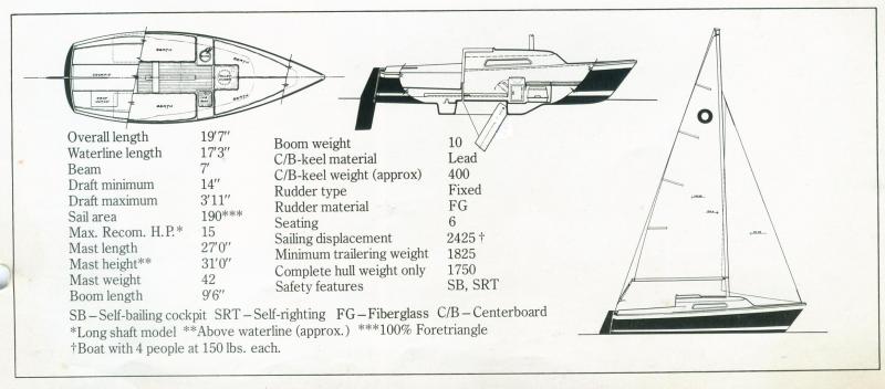

The original rig for the 20 was the masthead rig (1973-75), the Fractional rig replaced the masthead rig for 1976-78.
The original masthead rig used a mast that was 22'4" long (might have been 22'9"? same as original masthead rig on the 22) and a boom 8'4" long. (masthead would be approx. 26'4" above designed waterline)
The later, Fractional rig was 27'0" long and a 9'6" boom. (masthead would be approx. 31'0" above designed waterline)
I think the text from the 1976 O'Day brochure may give some answers to questions posted. Spar dimension drawing came from "WIRELESS" a 1973 model, provided by her owner (wish I could remember his name!)

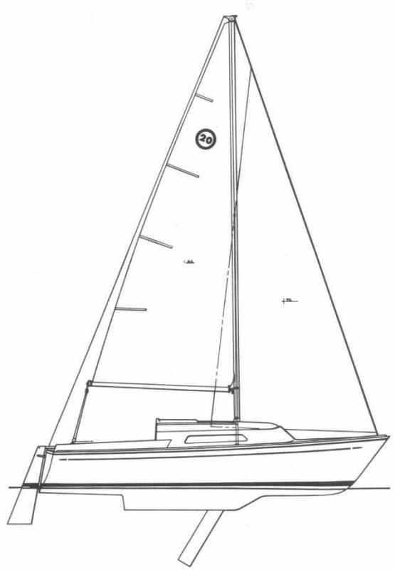

Kind of a long discussion, but basically the center of effort (CE) has a fore-and-aft relationship with the center of lateral resistance (CLR) that determines sailing characteristics, particularly weather helm, neutral helm, or lee helm.
Ideally, the CE would be a little forward of the CLR to provide a little weather helm.
The CLR is determined by the under water shape of the boat and, particularly, the keel. In your case, a "trunk" keel with centerboard. Without lateral resistance a boat would travel sideways (slip to leeward). The shape of the keel and centerboard resist that motion and turn it into forward motion. The fact that you have a centerboard gives you the ability to move that CLR forward and back slightly by adjusting how far down (forward) you allow the board to go. You are probably in the habit of putting it all the way down and forgetting about it.
A simple way to think about CE is to consider a single sail. If you drew line from the middle of each side of the sail to the opposite corner, that is, from the clew to middle of luff, etc., the spot where these three lines cross would be that sail's geometric center or CE. If you find this spot on each sail and draw a line from one CE to the other, the COMBINED CE falls along this line; not in the center (unless both sails are the same size) but in a ratio of the area of one sail to the other.

RE SUNBIRD POST: the line drawing shows CE for each sail & combined. SAILBOATDATA shows slightly different numbers - 8' boom (E) for masthead boat and 9' for fractional. I wonder if the guy that sent you those numbers measured the entire boom and not just the "black band" length (maximum sail foot)
