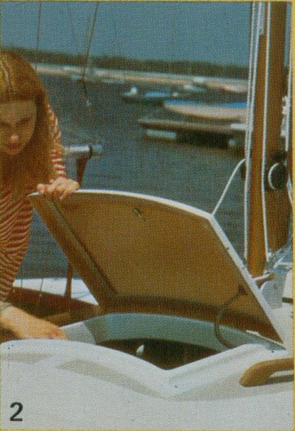

Foredeck (actually forward end of cabin trunk) hatch was an option on the 1973-75 O'DAY 20, not sure why O'DAY dropped that option 1976-78, but your thought about it possibly creating a weak area in the cabin top sounds reasonable. The hatch coaming was a separate molding that was bolted to an opening cut into the cabin top, it was not molded as part of the cabin top. (22 hatch shown, but same as 20)
The shape of the centerboard was changed when the switch to the fractional rig was made, CB became shorter and had a longer "chord" that is fore and aft width if viewed In down position, hence the CB trunk now extended slightly above the cabin sole. I suspect that the change to fractional rig might have been to add sail area as the original masthead rig appears a bit "small" to my eye, also the taller mainsail would be more efficient at producing power than the smaller masthead main, rig styles on racing boats were trending more towards large main - small jib designs around that time as well. I drop the jib as the first "reef" on my DS II, same should work for the 20 (fractional rig), however, on the older masthead rig... dropping the jib (even if using the "working jib instead of a genoa) would seem to reduce sail too much for efficient sailing. With a rig like that the first reef would be reducing the main (using roller-reefing or slab-reef) and keeping full working jib.
