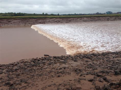

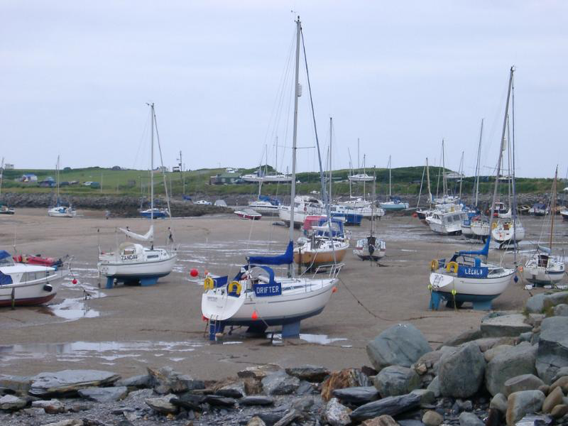

Some boat designs are better for such a tidal moorage than others.
Of course that doesn't stop owners from giving it a go. If your moorage is in protected waters and the tidal change is gradual, not a tidal bore
Then the ebb & flood should lower the boat and raise the boat without much problem. If the boat is listing and the combings are low you may get splash into your cockpit from wind waves. Keep your scuppers clear so that the water can drain away as fast as it gets on to the boat.
As far as debris and sand infiltrating the CB keel stub, I would expect that to occur over time. Should mostly flush out as the boat is used.
