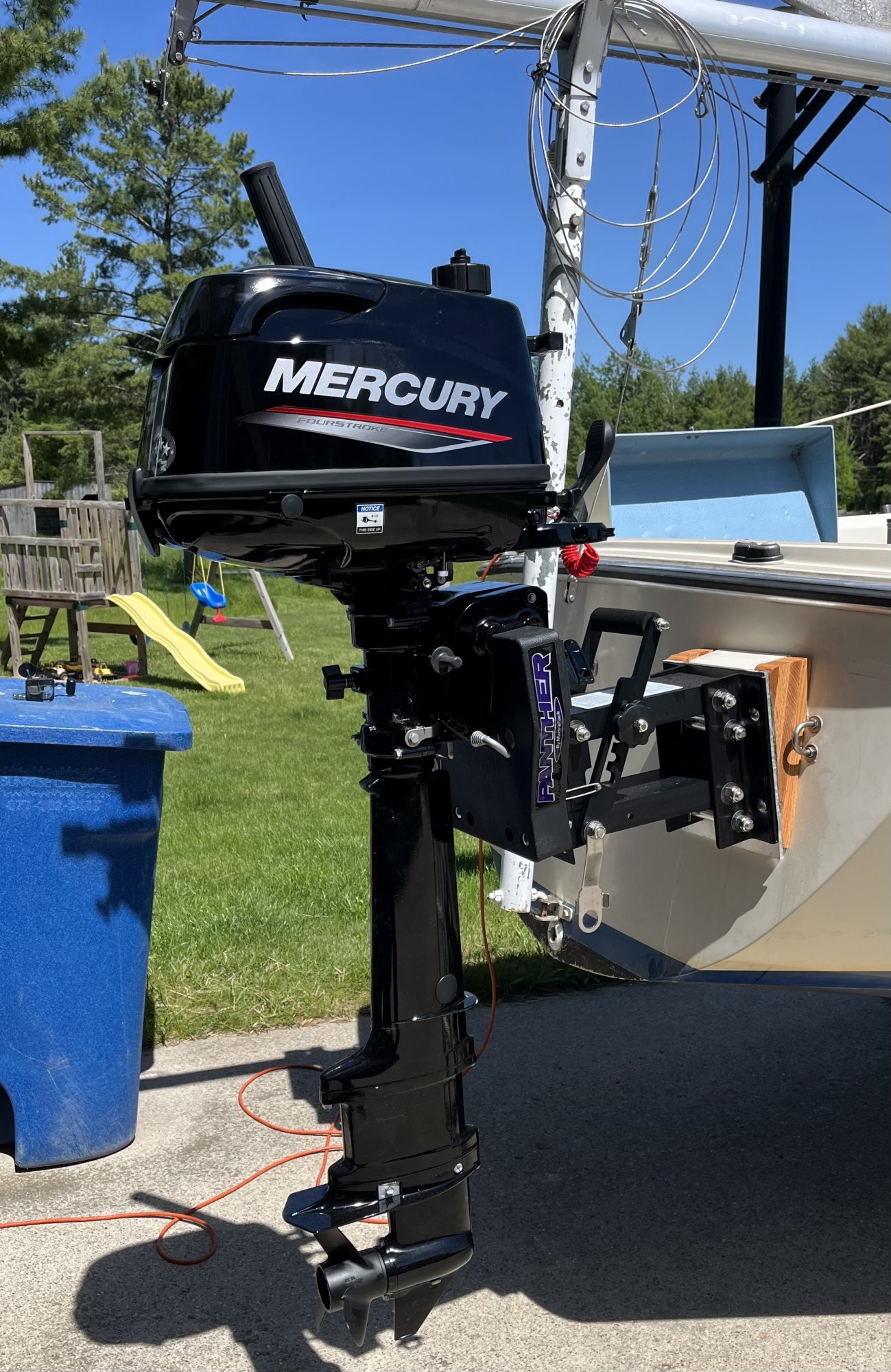

I was able to make extensions for the transom wedge and attach a Panther outboard bracket (for 4 stroke motors). 1/4" construction grade aluminum plate was added between the bracket and the transom wedge. Additionally the interior of the transom was reinforced with the aluminum plate. The bracket is rock solid, the motor easily lift and tilts out of the water while underway.

I didn’t have the issue that you do, I have a plumb transom. But I’m a little freaked out about the instructions on the panther bracket. I’m tempted to silicone the heck out of that thing, and or 3M 5200 or something. The instructions are to not over-tighten the bolts… my instinct is to tighten away.
I don’t want it rattling around back there!
How is yours holding up?

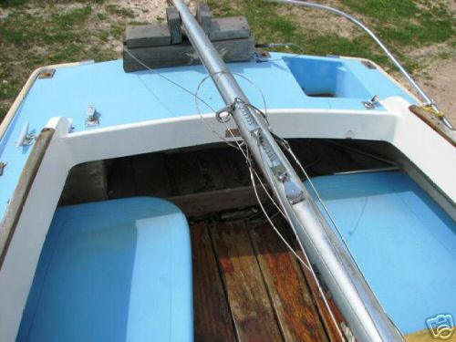

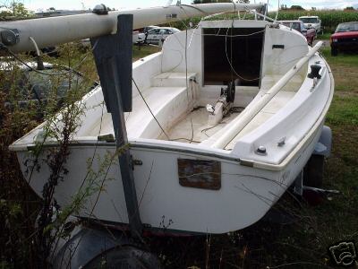

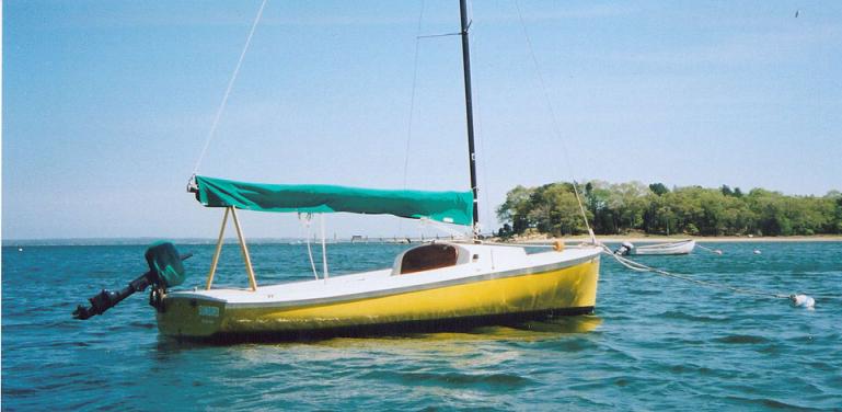

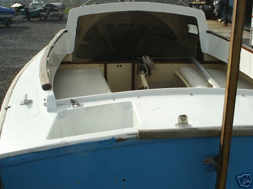

The 1962-68 Mariners with the afterdeck had a "kicker-Pit" (O'Day called it an outboard well" some years) which is a basically a "box" molded into the deck up against the transom, allowing the outboard to be clamped to the transom, no bracket needed. The DS I and R19 also had this feature.
The 1969-79 O'DAY Mariners WERE built to allow mounting the outboard by clamping right onto the transom, the plywood backing iside the transom may have rotted out on some of the boats, based on my 1979 DS II that appears possible, but I never had any problem clamping the outboard direct to the transom. I have attached a series of pictures from various O'DAY Brochures, showing outboards mounted directly to the transom, the picture of a DS I shows the Kicker-Pit" with the varnished wood cover in place instead of an outboard, Mariner from 1968 shows motor mounted that way as does the Rhodes 19 (although, I would not want a 9.5 on that boat), AND that O'DAY mentions that THEY BUILT THE BOATS TO ALLOW THIS! I'll add a few more pics of Mariners.
