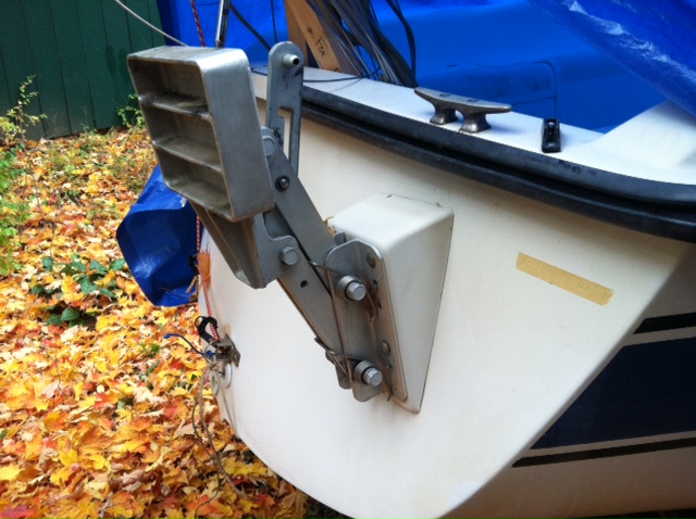

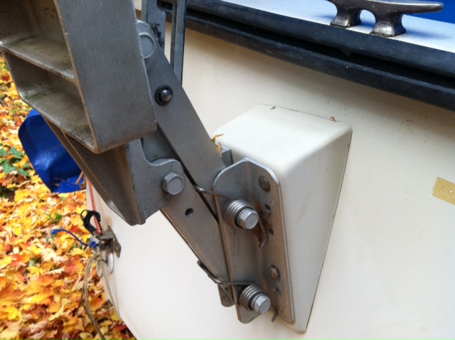

I am planning to replace the 6 hp '79 Johnson outboard on my Oday 19, with a newer 8 hp Yamaha, Honda, or Merc because I need greater reliability and power. The 8's weigh 25 lbs more, around 83 pounds (my 6hp is 58 lbs). It has been suggested that a newer 6hp might provide all the power I need at similar weight (61lbs) , but I would like to go with an 8. My questions 1) Can that Oday motor mount (pictured below) handle 80 pounds 2) I don't see how to gain access to inside of transom where bolts/nuts fasten motor mount bracket assembly to hull (one of the 4 bolts/nuts may be slightly loose) so that I can ensure all are tight. Thanks, Bill

I would question whether that mount could handle an 80 lb motor, or whether you need that big of a motor. When I had my O'Day 222, I repowered with the 6 hp Tohatsu 4-stroke. It weighed around 50 lbs and easily pushed the boat at hull speed, even in some Lake Michigan chop. I did replace the motor mount and wedge with a heavier duty Garelick mount. I also added a powerthruster to improve fuel efficiency, as well as avoid dinging the rudder with the prop, and prevent the motor from turning unexpectedly in heavy waves and cavitating. It worked great. (See one of my photo albums for details: http://forums.oday.sailboatowners.com/album.php?albumid=2157) . Note that I removed the wedge (not needed because the new mount could be set at different angles) and reinforced the backing plate when I changed the motor mount. I would suggest you think of alternatives to such a heavy motor on the transom of a 19. That is too much weight in my opinion and not needed to push the boat.

I'd stick with the 6 HP on that boat. I used to think that four stroke outboards should require an engine bracket rated for a four stroke and I've since adjusted my thinking on that. I think that you can get away with a regular bracket that is rated for the weight of the engine. If anything, I would make sure that your transom is beefed up enough on the inside.
If you feel that you want to change the engine bracket to a more heavy duty bracket, I would install an 8" Beckson Deck Plate in the center of the inside transom to gain access to the nuts and backup plates of almost every piece of hardware on your transom.
One of my friends gave me a fairly new Panther outboard engine bracket last year and I was able to remove my old Fulton Bracket and mount the Panther in it's place. I didn't have to disturb the fiber block on the transom and the bolts holes lined up beautiful. I couldn't have done it without that deck plate.

An 8" plate would be a huge improvement vs the 4" circular plate which you can't get your arm thru with any reach. Thanks for suggestion. I will be able to reach nuts on bolts holding current bracket and will have better access to cockpit drain tube which had been source of a leak into hull reported earlier. I was just surprised that Oday wouldn't have provided access to major bolts holding motor bracket, and thought there might be a trick for getting in there e.g. thru seat locker on starboard side ... where access is blocked by floatation which seems afixed to hull. Thanks again Joe.

When you install the deck plate it may not lay flat on the curved surface of your transom. It's important that you don't over tighten the screws of the flange which can bend the flange and cause the cover to bind when you screw it on.
I would use a good silicone caulking like "Dap Silicone Rubber Adhesive Caulking" which can be bought at any hardware store. Any small gaps between the flange and the transom surface will be filled by the caulking and it should come out looking pretty decent.
